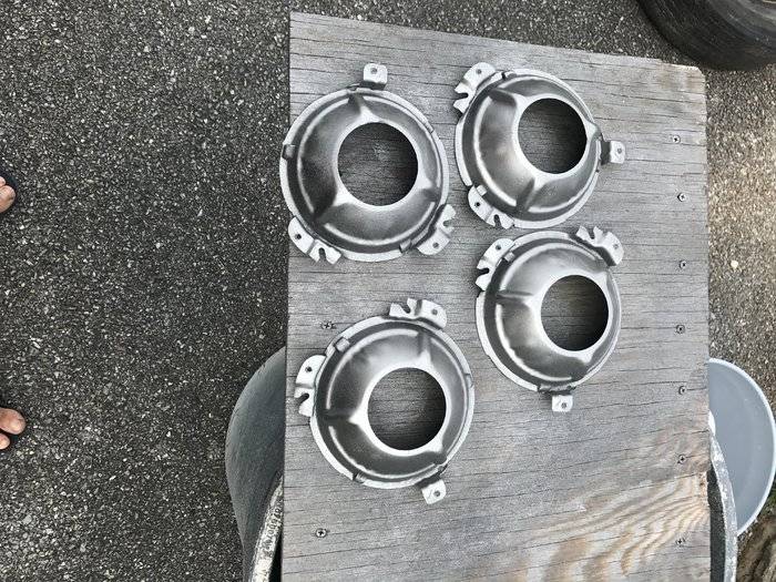

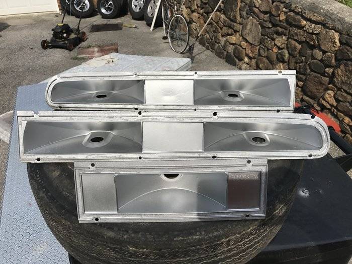

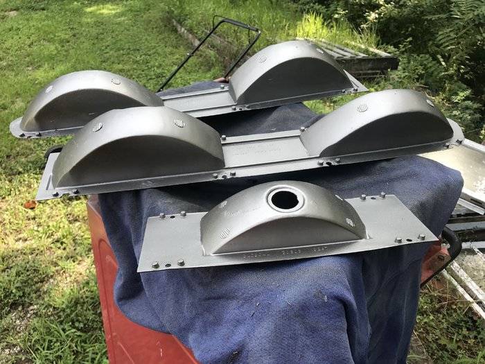

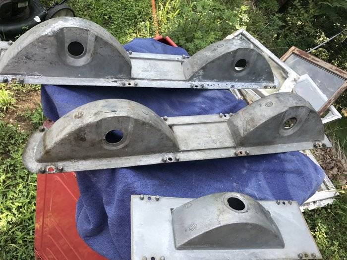

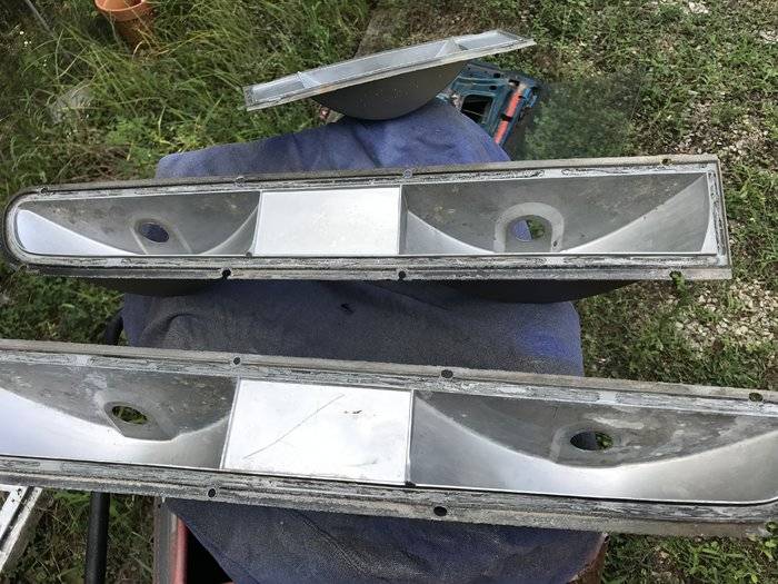

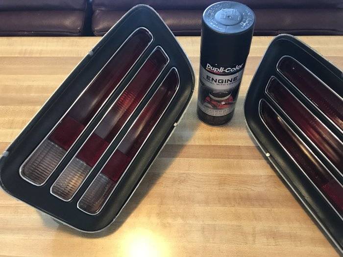

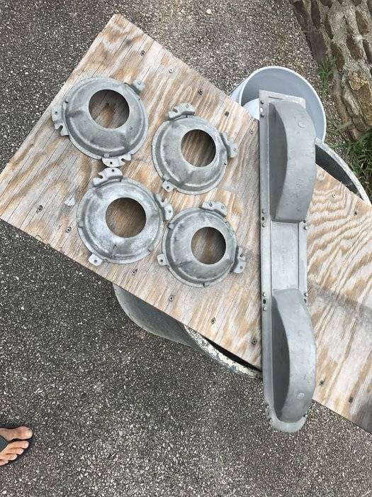

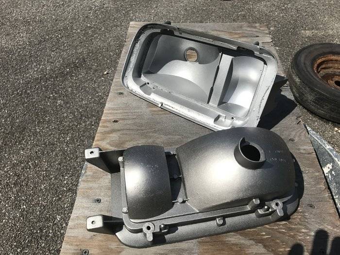

Really just a scrubbing, cleaning, and painting. Did it all with rattle cans. The duplicalor for the inside of the rear housings. Not OE just easy lol

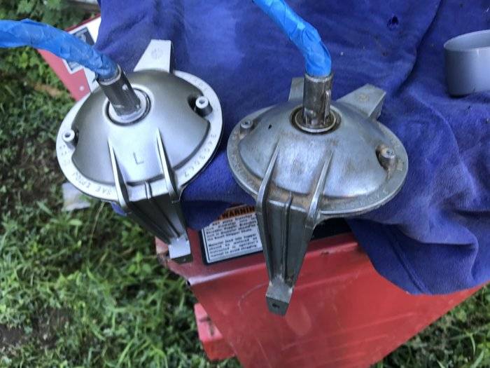

I forgot to mention the connection on these housings don't seem to be like the 1970 connections I have seen( with the one metal piece and one plastic piece) what do you guys think???? I got them off eBay so maybe 71s
moparlee
Jul 25, 2011
3,275
1,448
Mid Michigan
They are not 71 end connectors. 71's are like the 70's with the flat yellow rubbery type for the round male/female ends. Your housings turned out nice. What is the color name for the Duplicolor?

Sharing the love, not sure about the color moparlee. It just says color of top or something like that on the lid of the can. I'm sure I bought it at oreilys, the paint I used for the outside housings I got at Carlisle show. Does anybody have a good flat black paint they would recommend for the black bezel part?
1969VADart
Apr 15, 2017
157
25
Fredericksburg, VA
If you are just rattle canning it, I would recommend the Krylon Flat Black. I used that color on my Dart for a lot of parts. Actually, I think I used Semi-Flat because it just looked a little better. I would give either of those a try and see which finish you like best.
fk5aar
Dec 2, 2015
472
103
Thanks for the advice va dart, I'm in Roanoke btw. I'm happy with the rattle can results and don't know any oe resto shops close so this will have to work. If the pieces come out looking clean and 100 percent better than they started I am happy. At least it's another coat of coat to protect the original pieces.

The SEM trim black looks close to original. Has a light sheen, somewhere between flat and semi
fk5aar
Dec 2, 2015
472
103
I went with duplicor semi-flat, it was at advanced auto so easy to get, I'm please with the results. Once I get the new bezels for chally housing I will post those too!
quapman
878
227
I really like Krylon, too. Beware, however that they changed the names of their blacks. The really flat one is now called "Flat Black" and the semi-flat is "Matte Black". (I hope I got that right. :O )

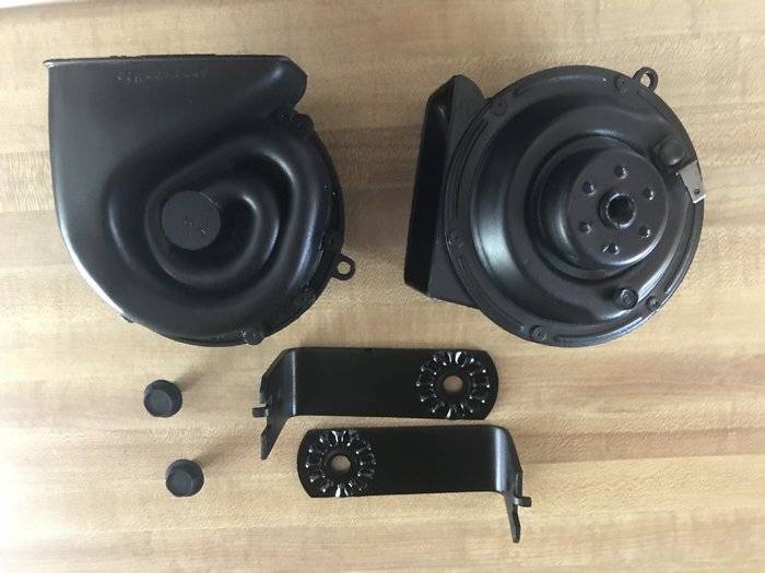

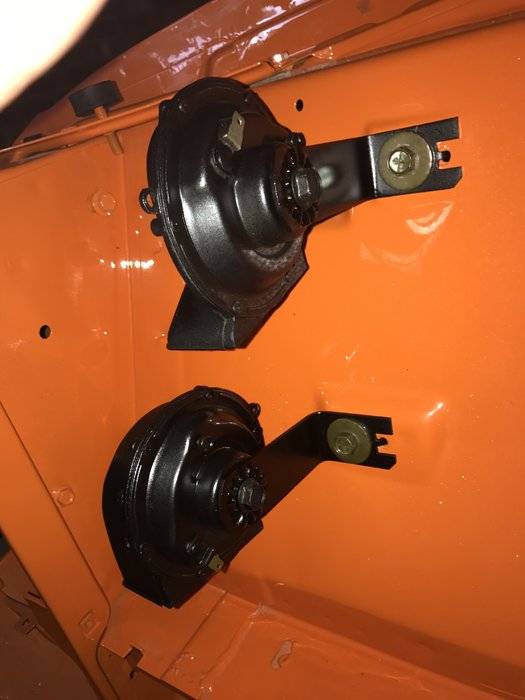

Here is the semi gloss I used for my horns it came out a really nice matte finish, the original finish may have been more shiny but I think these turned out great
aussiemark
Nov 29, 2014
1,218
330
Perth Western Australia
I seen a can of engine paint in a photo that stuff doesn't harden properly without heat, you can always smell it when a new engine is fired up and the smell doesn't go away until the paint is cured without the heat it will always be soft and scratch easy.
fk5aar
Dec 2, 2015
472
103
This has ceramic in it too, oh well it's nicer than what they were. Thanks for the info,
