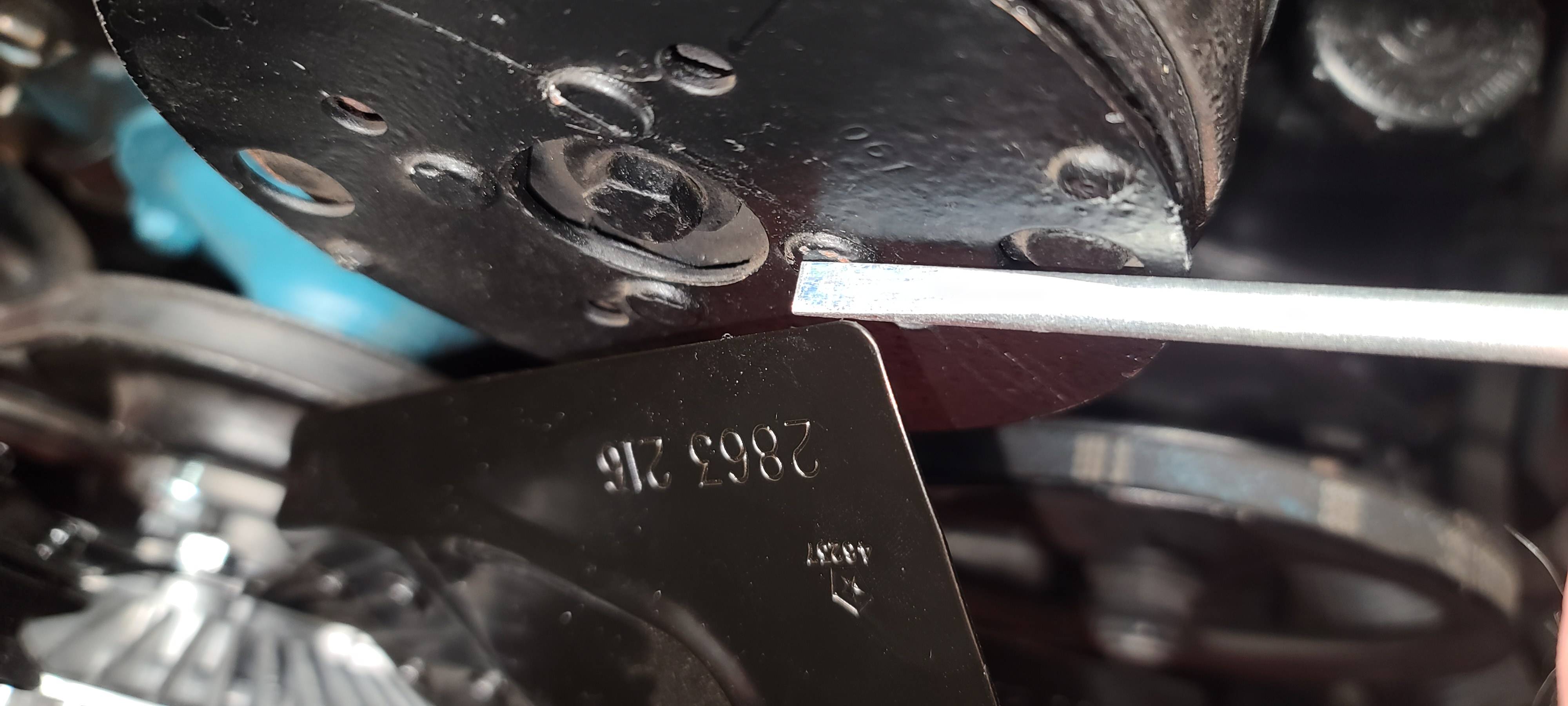

I'm upgrading my radiator to the Cold-Case MOP754A. They were very helpful in asking questions to make sure I got the right unit. With that said the Cold-Case radiator sits flat/even with the mounting brackets and the stock 26" has its brackets off-set so that the radiator sits forward towards the nose of the car. This meant that I thought the fan would be very close and potentially hit the radiator with the Haydon 2747 HD fan clutch. Therefore, I purchased the shorter Hayden 2947 as it is also a HD fan clutch but about 1/2" shorter. Perfect for fan to radiator clearance. What I didn't think about was that I have factory A/C on my '71 Cuda 383 and now because the shaft on the fan clutch is shorter I only have about 9/32" (just over a 1/4") gap between the 7-blade fan tip and most forward bumps on the A/C compressor (see picture).
Thus the question:
How much space is needed to accommodate fan flex?
If 9/32" is too small, I could probably make an 1/16" or 1/8" spacer. I'm kind of hoping it is fine as the fan is attached to the engine and so is the A/C compressor so those two items should stay in their relative positions to each other as they have the same fixed points (unlike fan to radiator clearance). Therefore, I think I only need to be concerned with how much the fan itself will flex and if this is enough clearance to accommodate that flex.
Thus the question:
