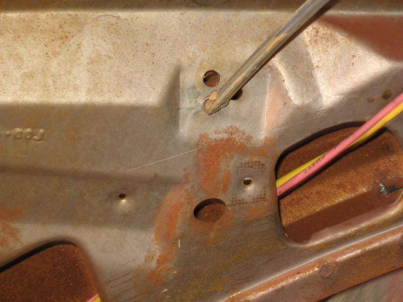

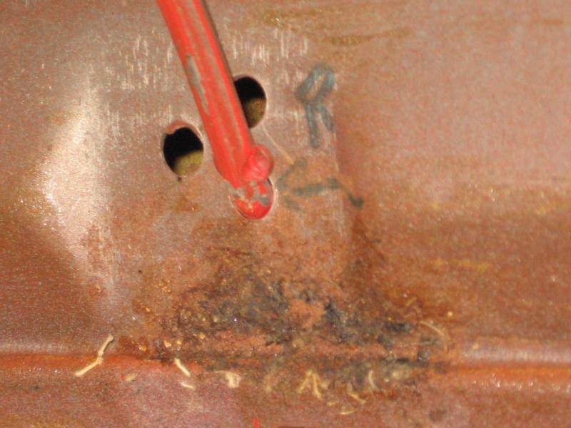

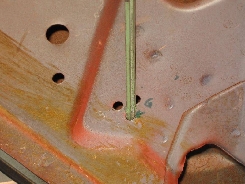

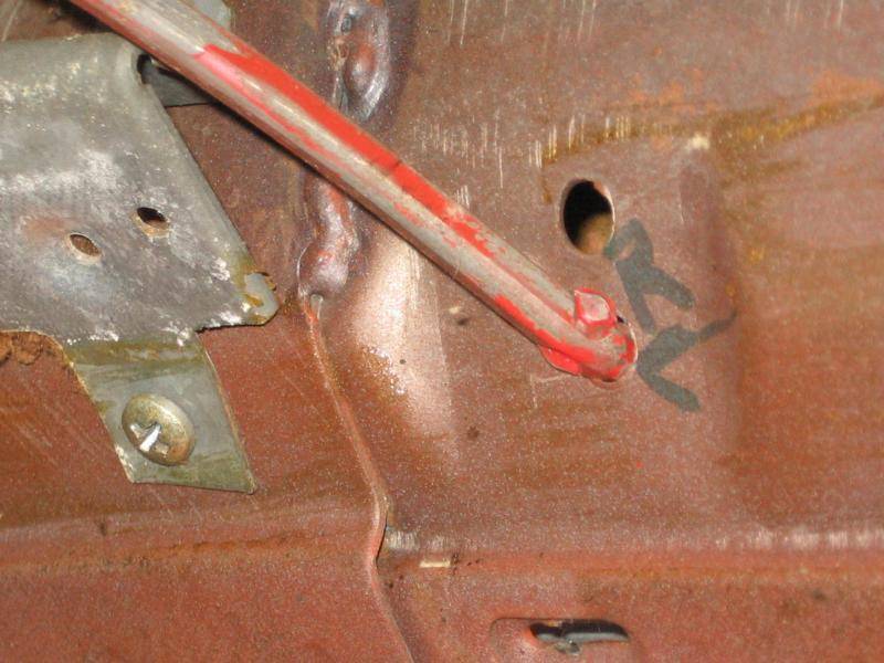

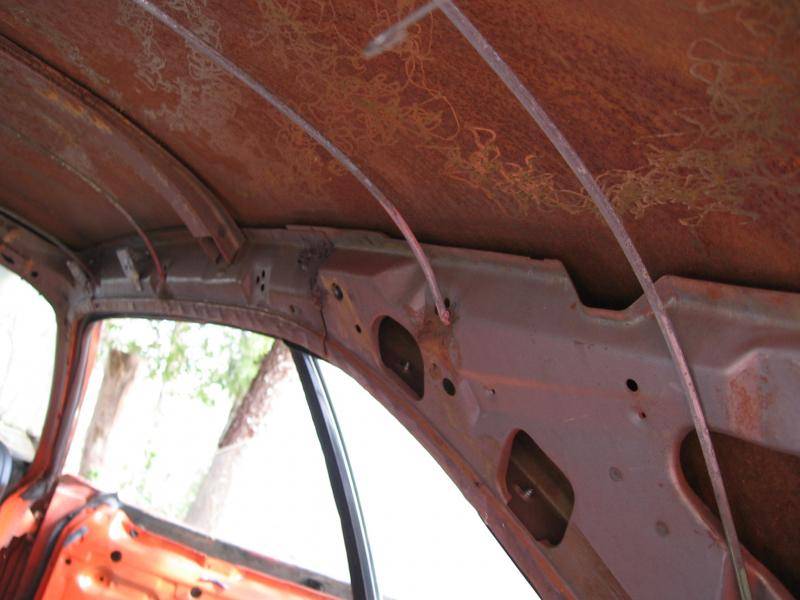

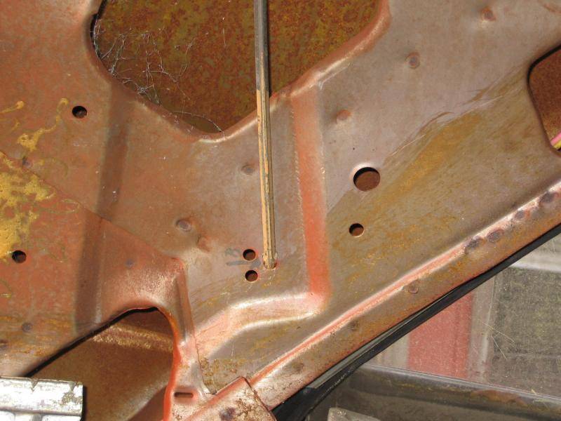

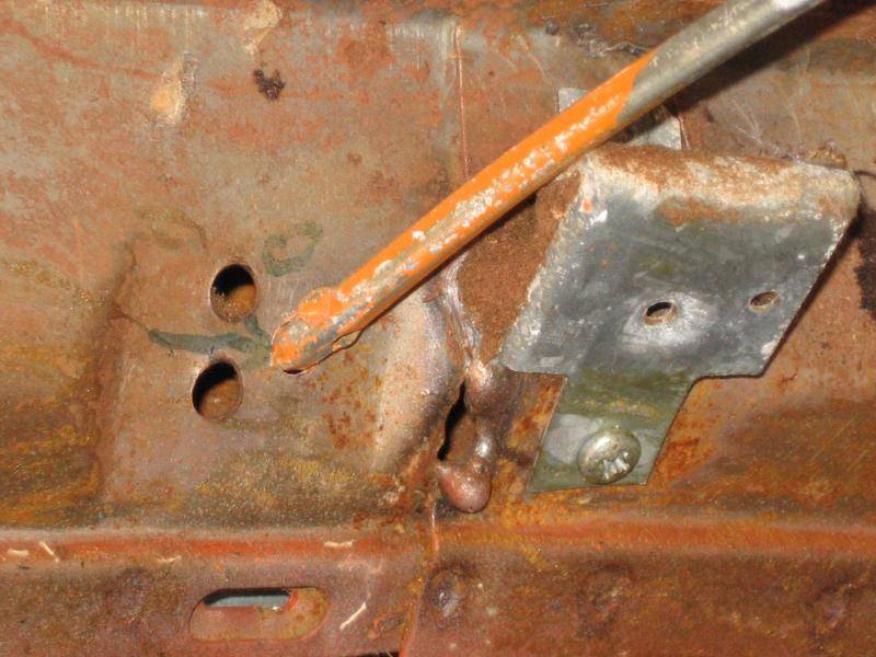

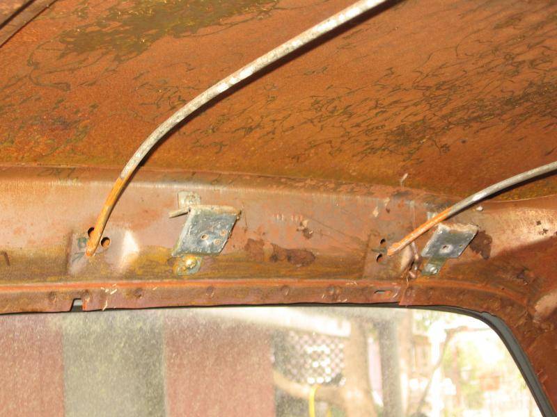

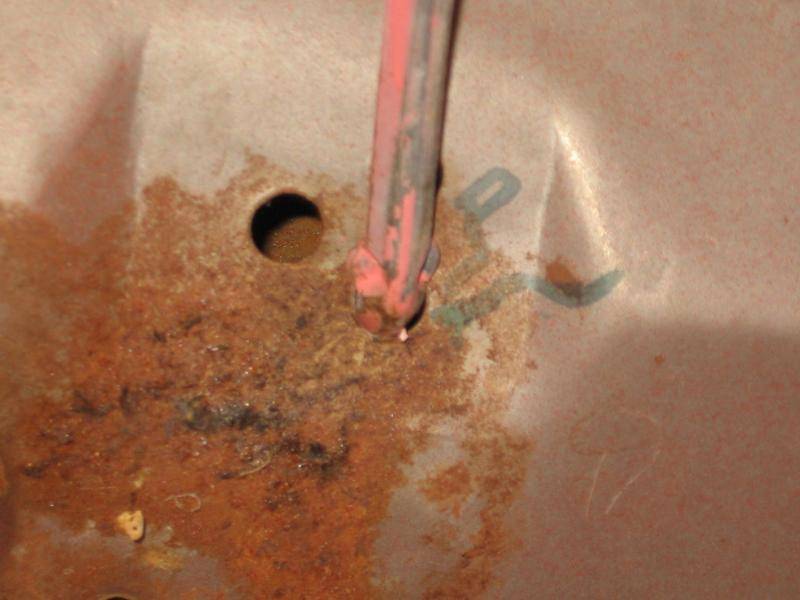

Hi Guys, my bows were out of the car when i got it, out of the three holes at each bow end in the body, which hole to I use for installation???? whats the process please
Yes I have the two rear wires and the four bows (still in the old headliner, orange, orange, pink, grey in that order)What are you working with ? A 4 or 5 bow headliner ? Do you have the rear bow wires ?
