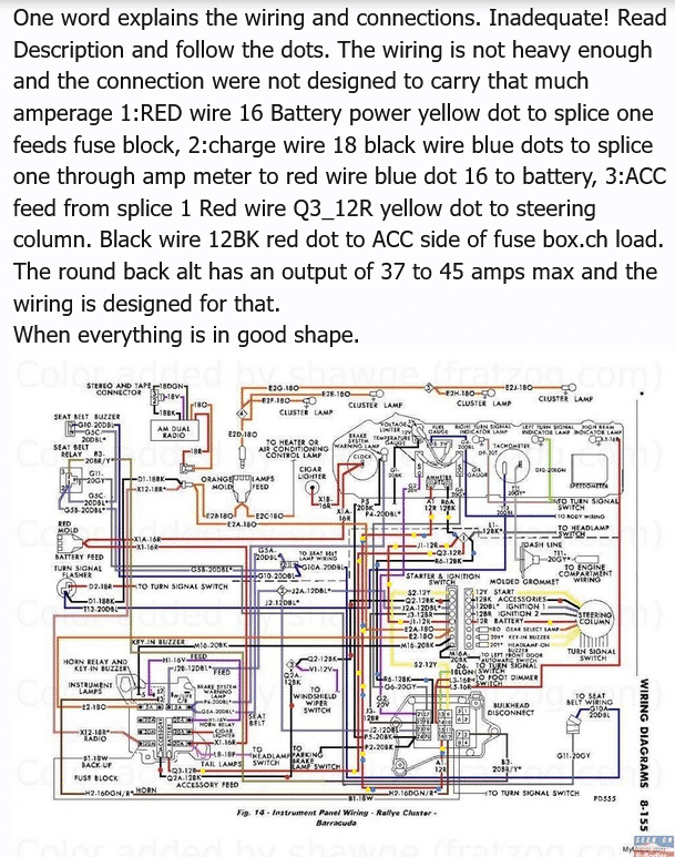

Factory wiring is Orange for the lights, run a power on wire from light switch to trigger a relay supplying power to the Orange wire.
Then when light switch is flipped, everything on the Orange feed will be powered up.
Using a fused power wire to the dimmer in & out to the orange originally circuit will restore the lights , factory gauges need a power wire to the volt regulator sending 5v to the gauges

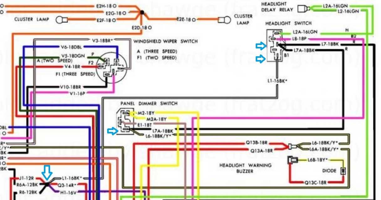

@sheetmetaldan
If you have power to the inlet terminal of the dimmer switch and do not have power at the center terminal, then the contacts may need to be cleaned or the switch is bad.
When the dimmer switch is turned all the way counter-clockwise, past the "bump" or "step" position in the switch, then there should be continuity between terminal D and the metal body of the switch. This provides a ground connection for the dome light circuit.
The dimmer switch provides a ground, not power supply, to the dome light circuit. Therefore, you will never see a connection between the inlet power feed to the switch and the D terminal.

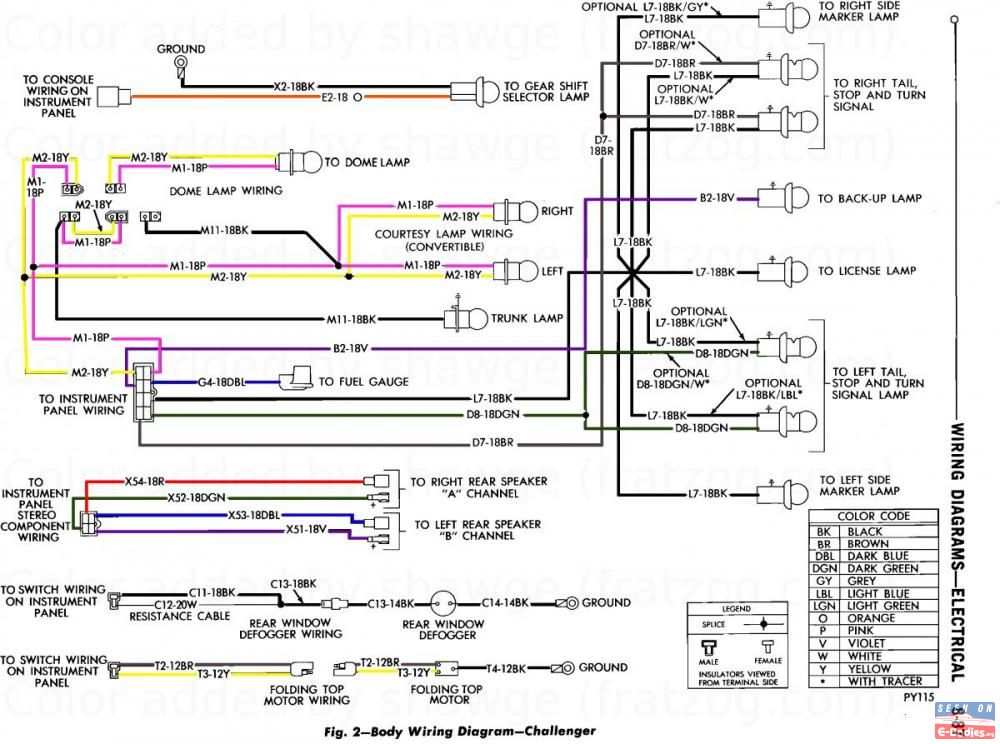

Here is a a little more wiring on the dome light hope it helps and not hinder. You only have the dome light on the top. The driver's panel conceals the the plug for the rear body harness. The wiring travels back to the trunk and the dome light harness plugs in there. at the wheel well. Then goes up through the sail panel to the dome light. The diagram shows just how there connected. Do the wipers work? Meaning is the switch panel grounded?
Here is a a little more wiring on the dome light hope it helps and not hinder. You only have the dome light on the top. The driver's panel conceals the the plug for the rear body harness. The wiring travels back to the trunk and the dome light harness plugs in there. at the wheel well. Then goes up through the sail panel to the dome light. The diagram shows just how there connected. Do the wipers work? Meaning is the switch panel grounded? View attachment 141544View attachment 141543
Wipers do work but do not park themselves when I shut them off. I gave up on the dimmer for now, I think I’m closer to getting the gauges and instrument lights working so I’m focusing on those first. Quick question. I’m trying to run a new 12V wire to the voltage limiter im just not sure which wire to cut into? i know it needs to be a wire that’s only powered when the key is on. Should I cut into a wire from the headlight switch and use that? Thanks again for everyone walking me through this I really appreciate it!
