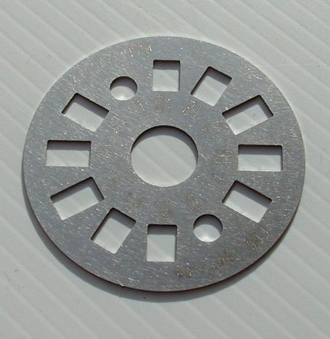

  4. Cudakiller70
    Cudakiller70 Well-Known Member
    Messages:
    84
    Likes Received:
    29
    Joined:
    Aug 3, 2016
    FWIW my 340 with cam, headers and RPM intake. initial is set at 18 @ 800. My total mechanical advance is 34 @ 3000. No vacuum advance. I limit my total by using an FBO advance plate, see pic. Also using lighter spring (only 1 was changed) from mr gasket
    I use a stock electronic distributor.
    There are a bunch of ways to go for ignition. Do you need a complete ignition system? If you already have a system and just need a recurve of your distributor, there are places to get your distributor recurved. Again if a complete system is needed, I like FBO. Don also has a good tuning book and good plug reading info on his website. Many other ignition choices for these cars.
