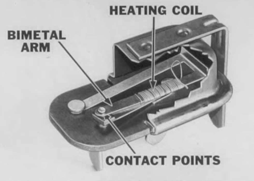

The factory gauge needs 5VDC to operate correctly. The factory Instrument Voltage Regulator (IVR) is bimetal mechanical (switched 12VDC contacts) and simulates a pulsed 5VDC. Not that accurate of a regulator and, if original, is probably in need of replacement. Consider the Real Time Engineering (RTE) IVR.
You should verify what voltage you are getting to the gauge when you have 10Ω (full tank reading near 5VDC), 31Ω (1/2 tank near 2.5VDC), and 73Ω (empty tank near 0VDC).
Your sending unit should be fairly consistent across its 63Ω range (10 to 73Ω) but many find the factory sending units to not be linear which causes the symptom you are having.
