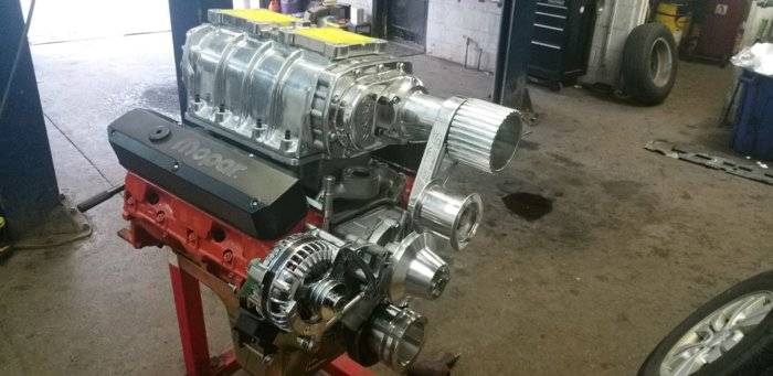

Hey guys putting a small block magnum motor with a 671 blower. Using an Indy modman intake. I only have 2 inches between the blower and intake for a thermostat housing. Wondering if anyone has run into this and what they did.
I'd make one that comes out the front instead of up and down. Easy enough if you can weld or have a milling machine. I don't know if anyone makes one like that.
