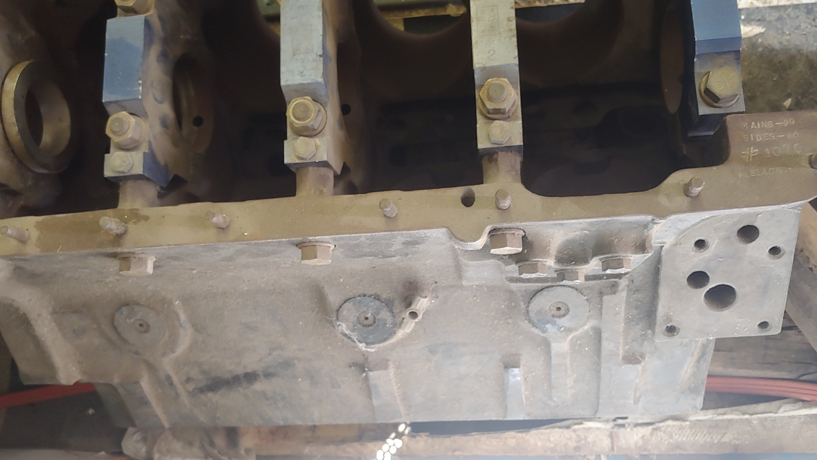

What I need to know, is what anyone can tell me about this block.
And yes, I would like your opinions on the perceived VALUE of this block and the other parts. No, mods, this is not a wiw ad.
No one, should ask me if it's for sale. It's not. Nor are any of the other hemi's he has.
Currently I only have so many pictures. I can go get more pictures of each of the parts but I want to make sure I can figure out how to strike a deal without insulting a well informed Hemi race guy. He's old and doesn't have a lot of time to just entertain me on my whim.
Let's start here. The block was purchased from Keith Black in 1973. He purchased multiple engines at that time of which were all cast blocks. He had purchased multiple blocks after that date which were aluminum.
I am after one of two cast blocks that remain.
His actual dated 73 block is in his funny car so I can't get my hands on that one.

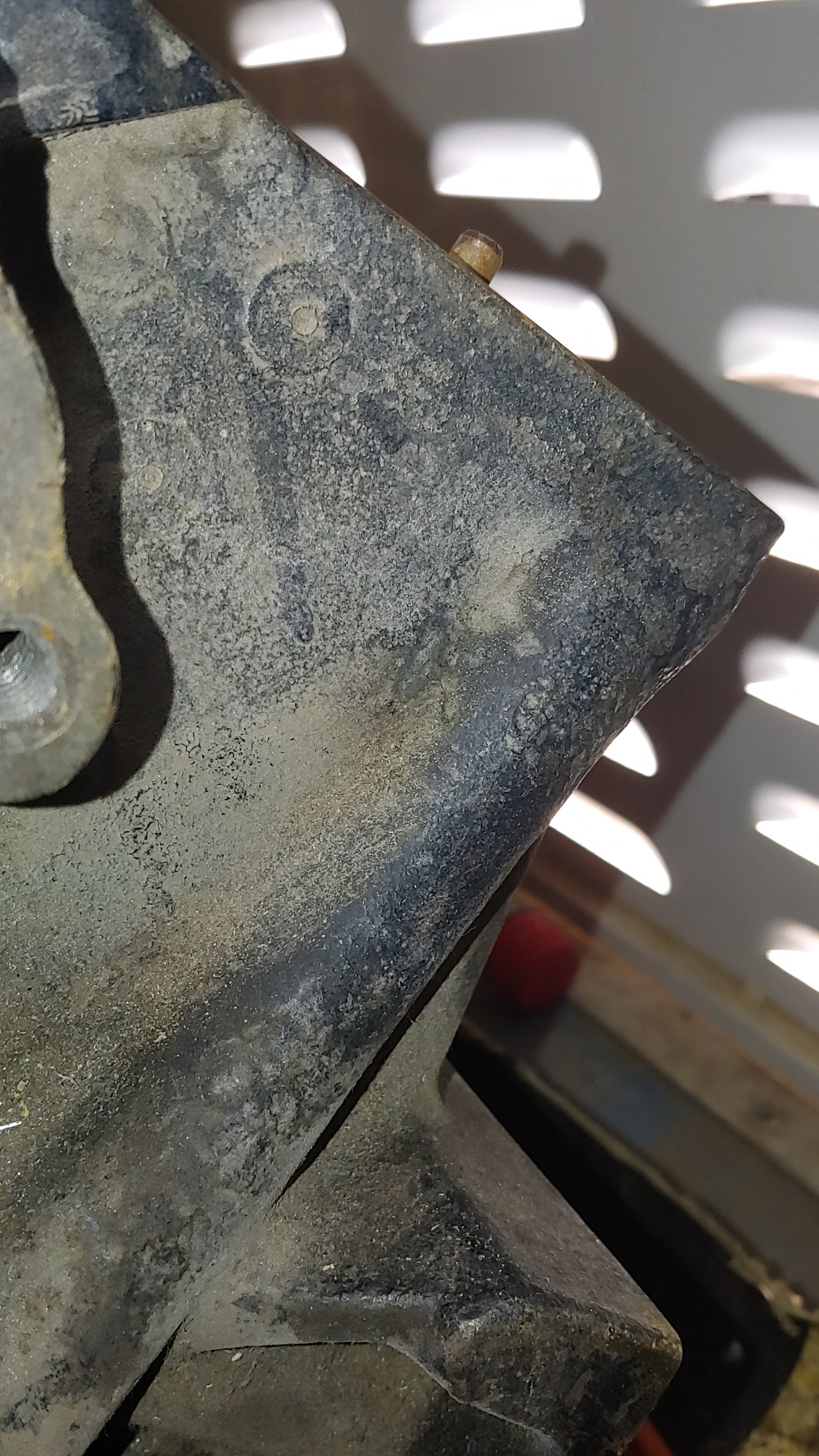

The one I am after is as I recall, a 1968 block as it has markings on the bell housing mounting surface.
I can't find that picture but will keep looking for it. No vin stamp.

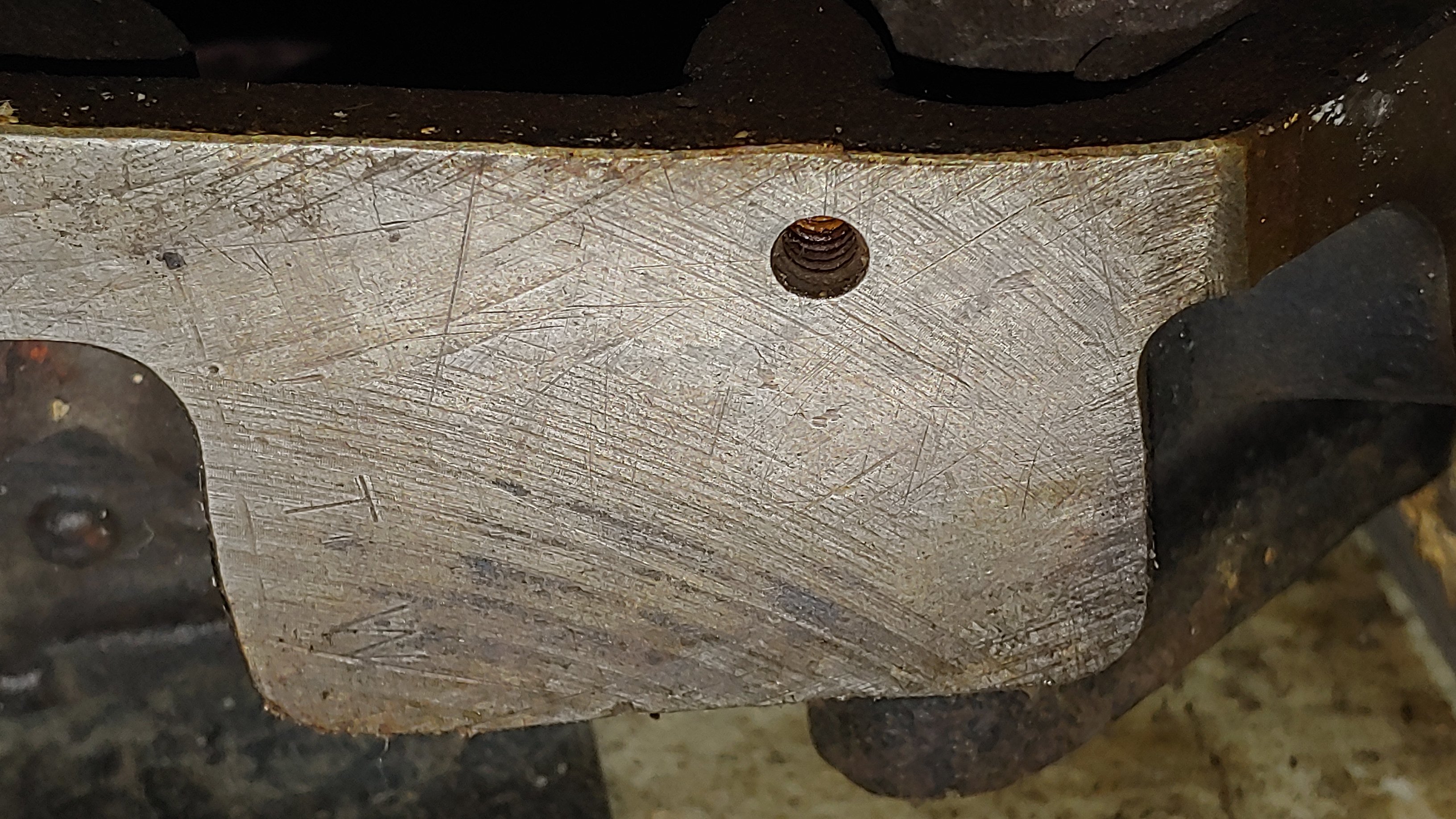

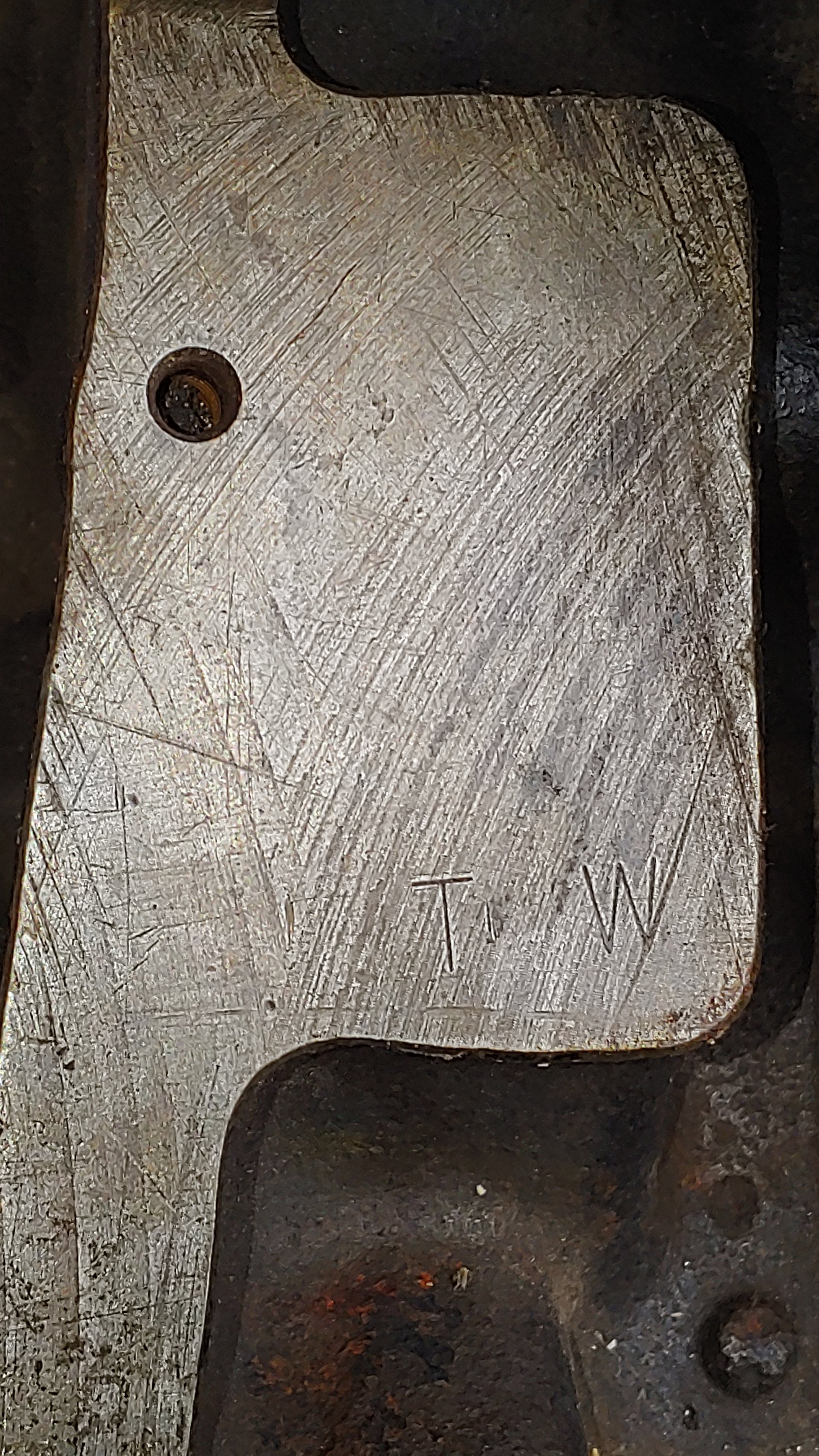

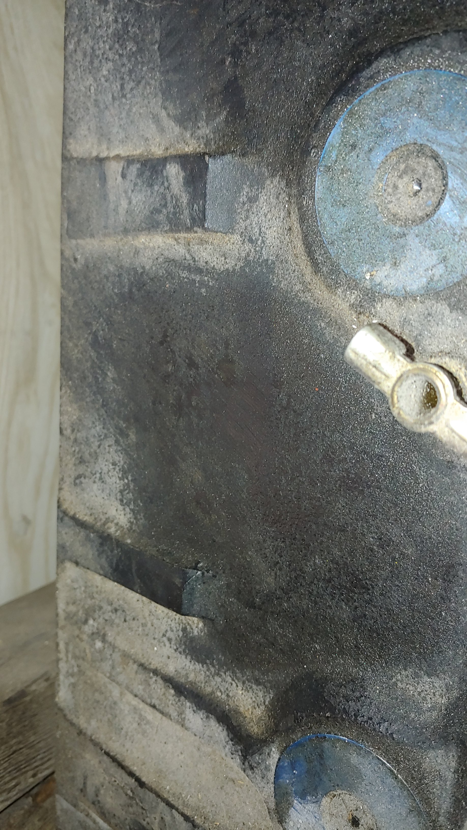

The only marking on the front upper pad is TW and the pad appears to have been shaved? Not sure.

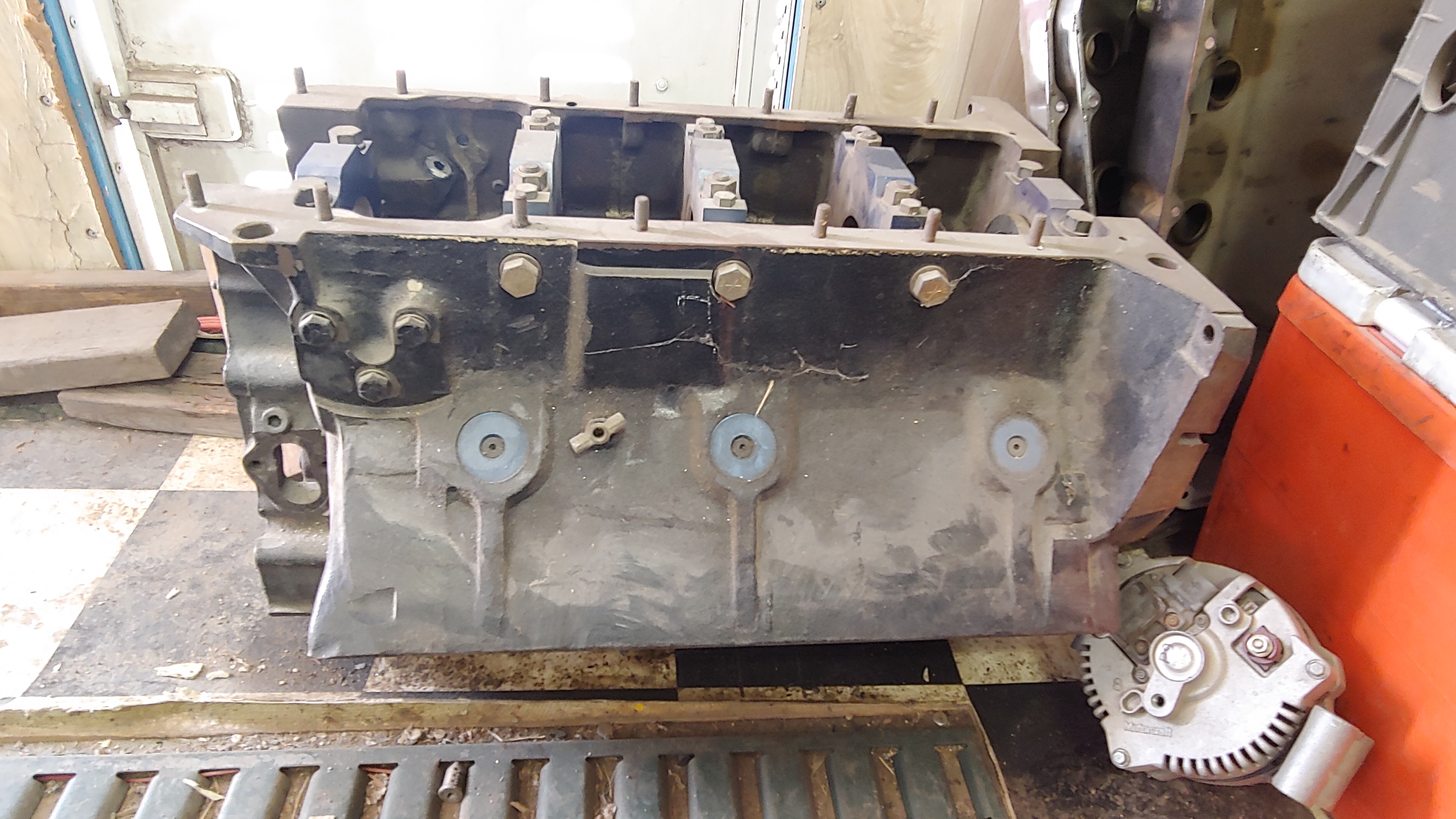

The block also has on it (as seen in a picture to follow)

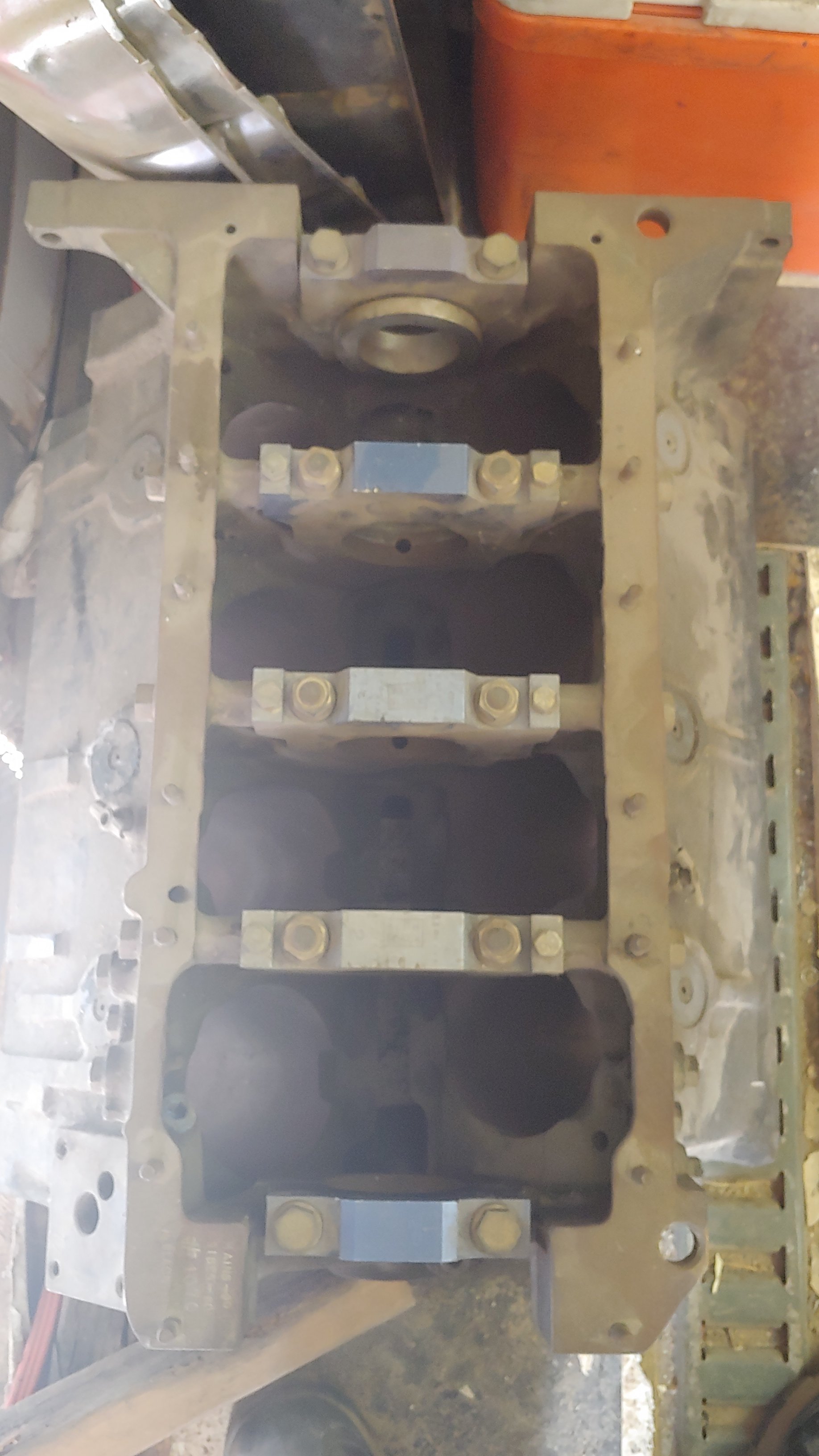

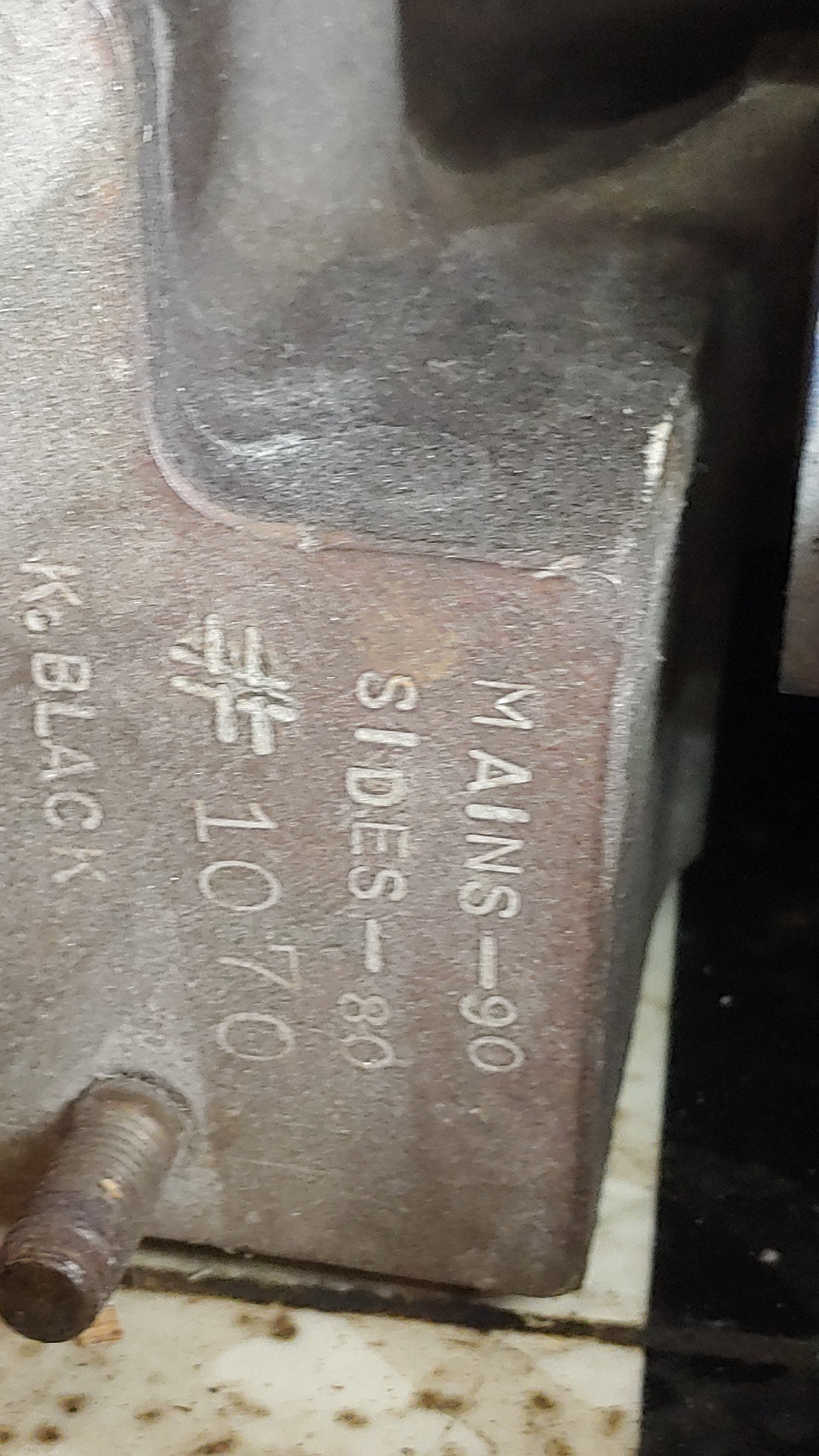

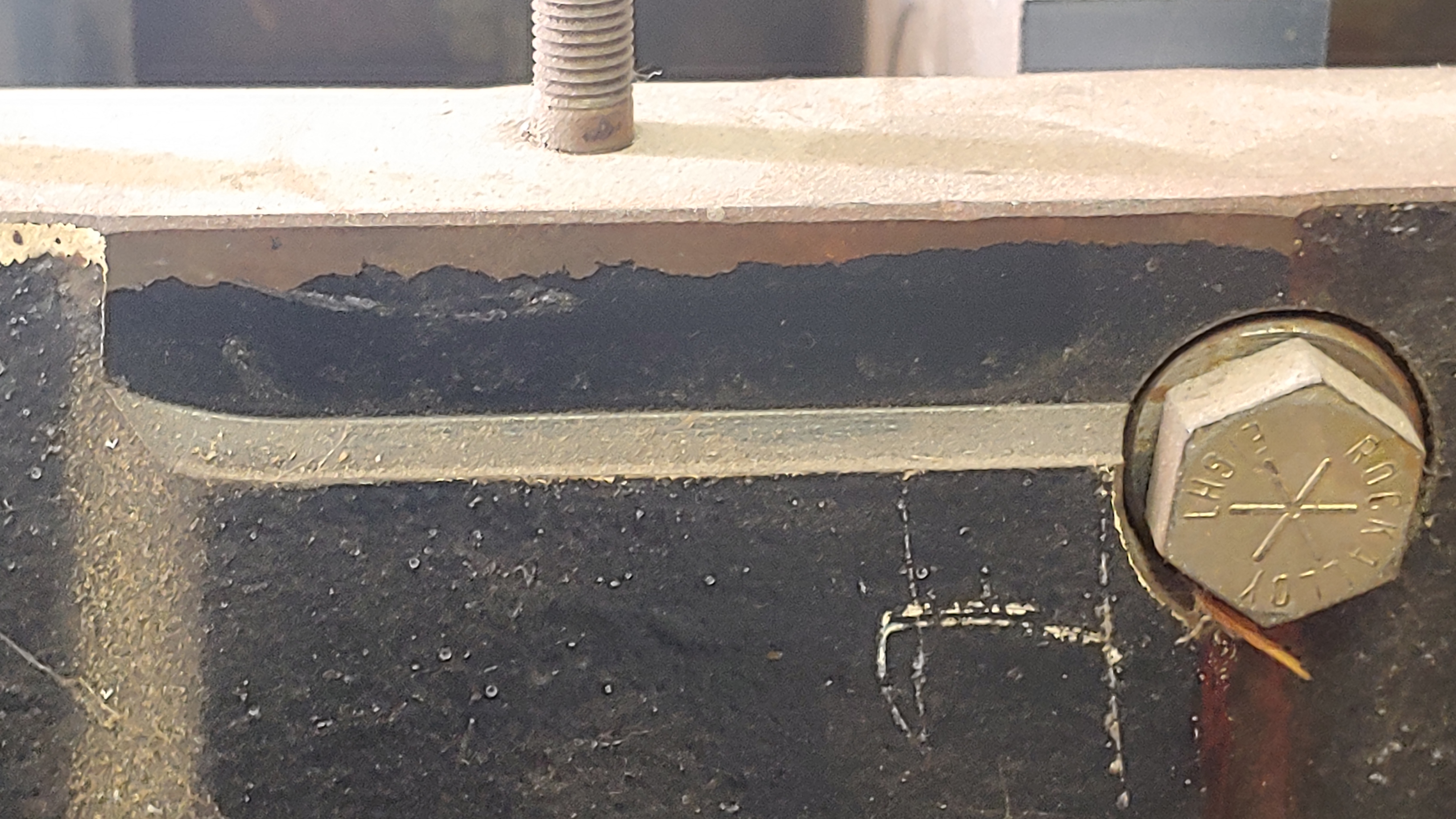

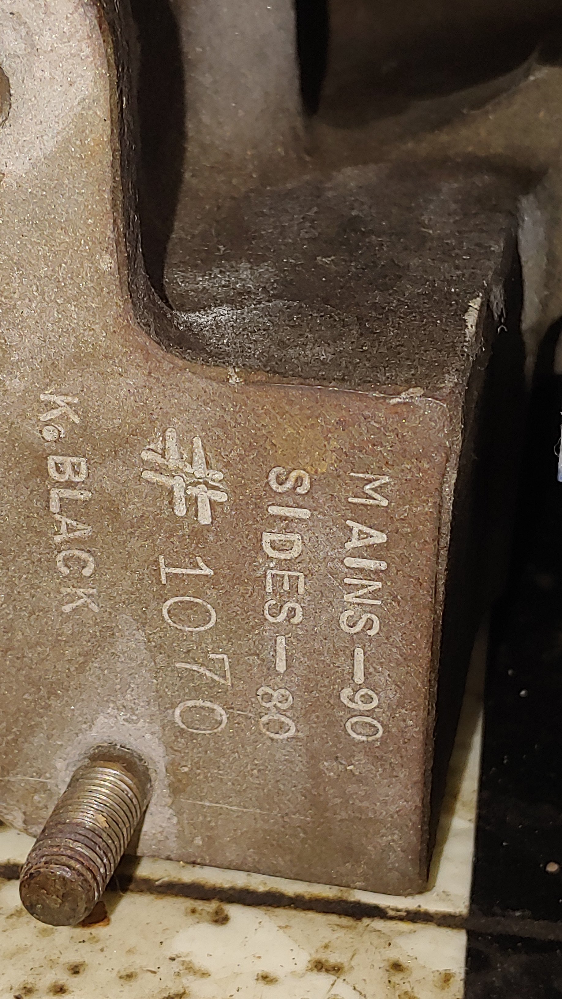

Mains-90
Sides- 80
# 1070 (this is the number Keith could reference as to when and who it was sold to)(good story)
K. Black

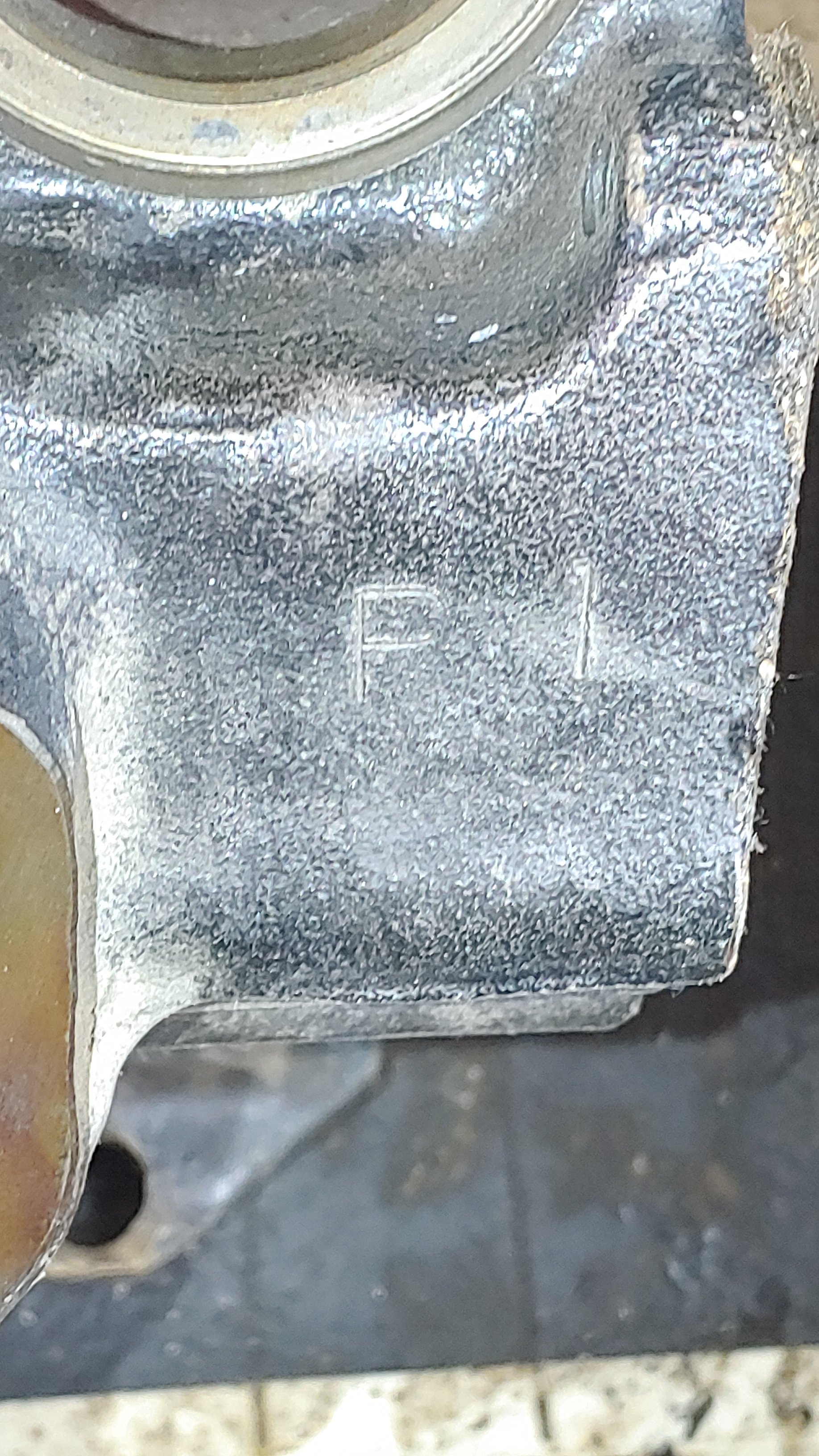

There is another pad that has F1
The block has not been filled and is a water block.
It's said to not be cracked and has been stored inside for it's entire life.

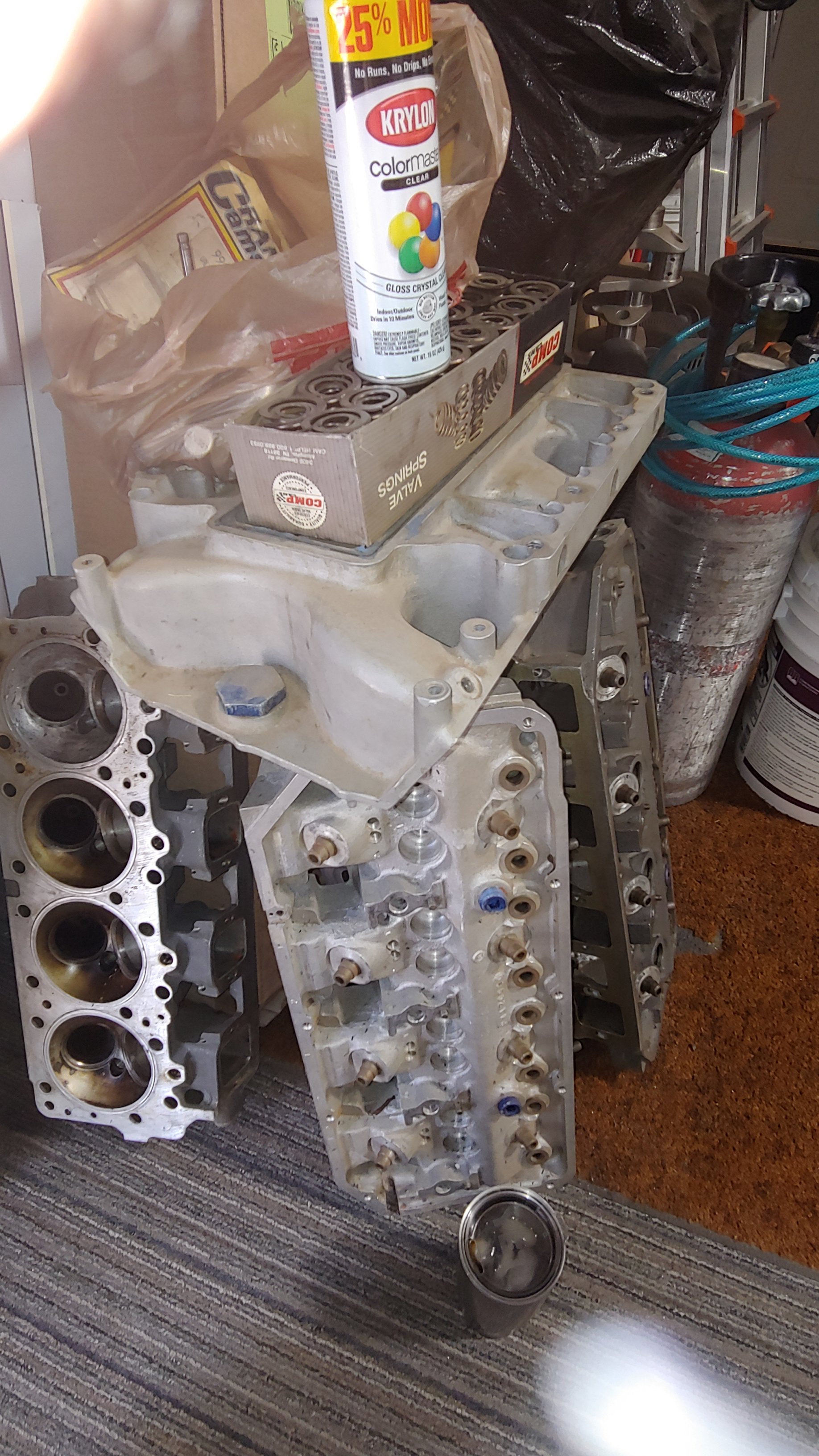

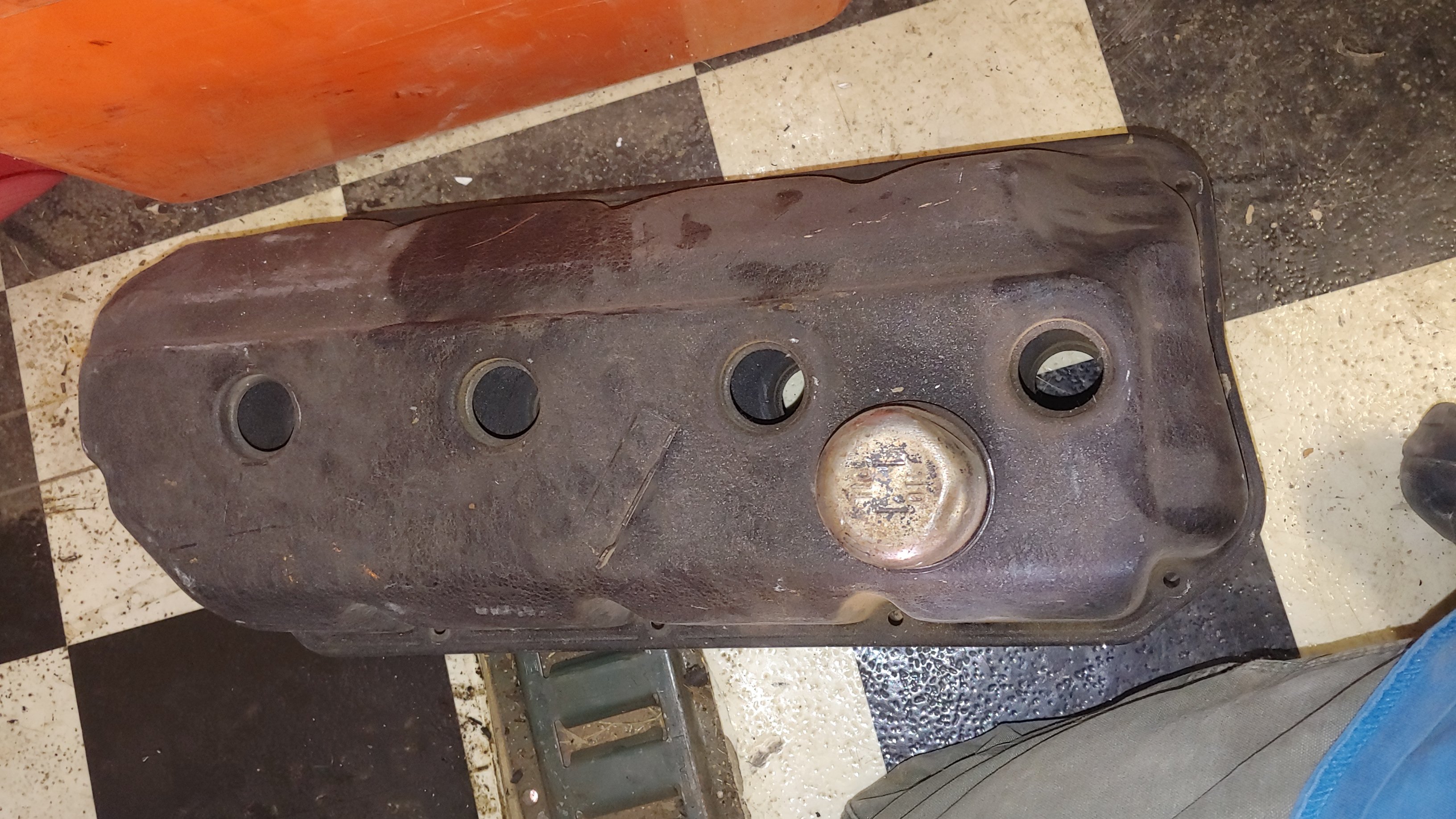

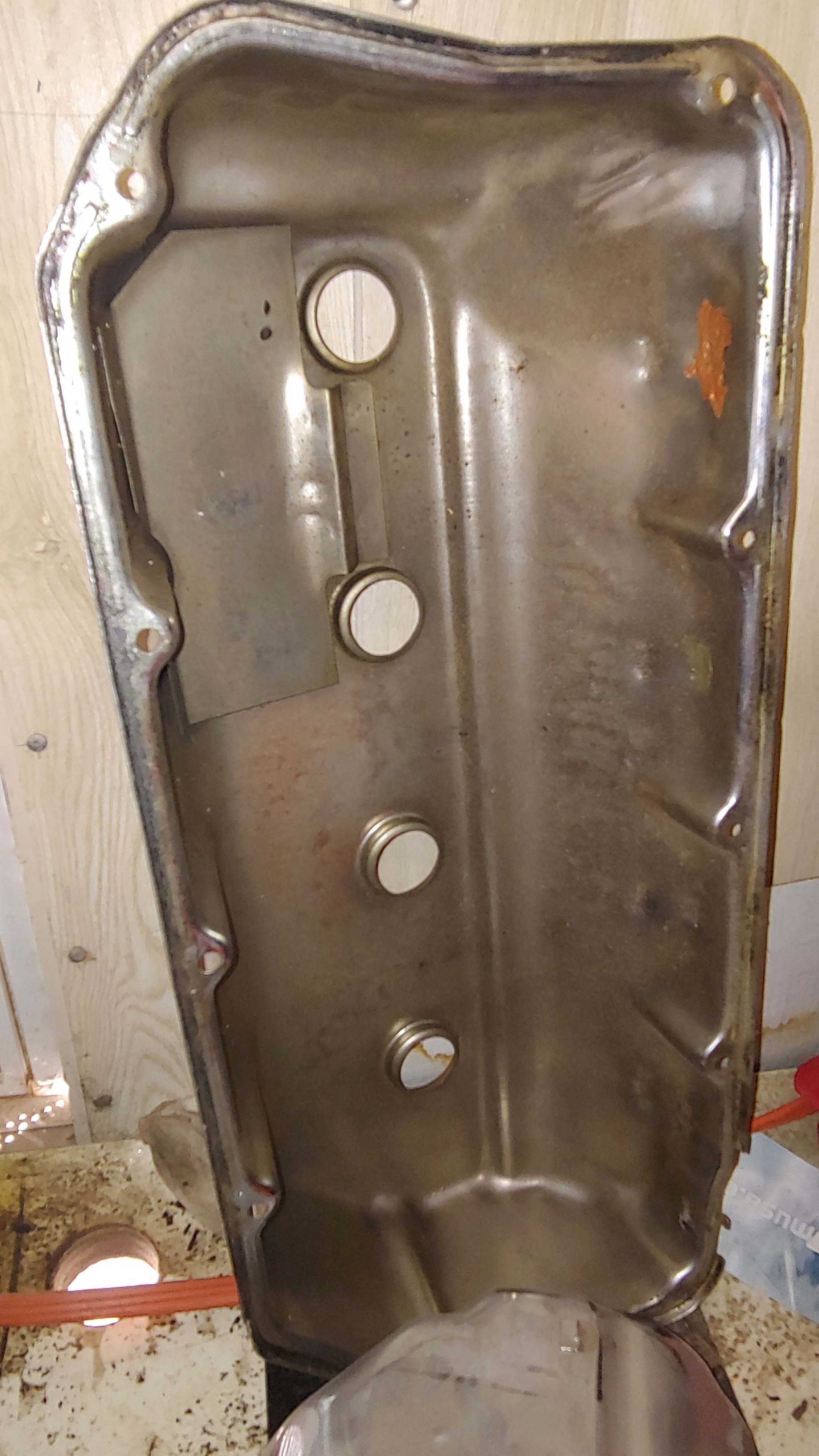

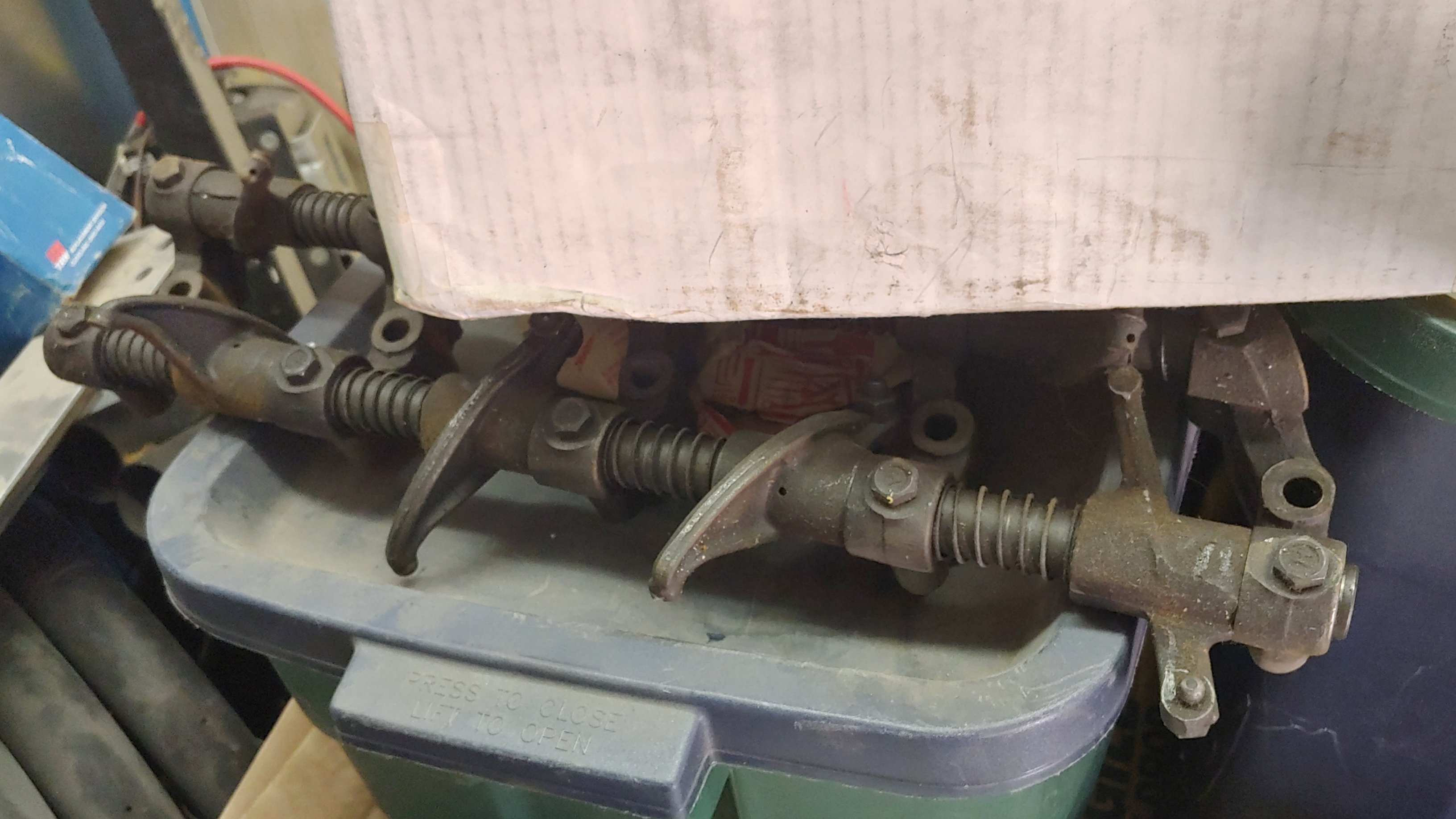

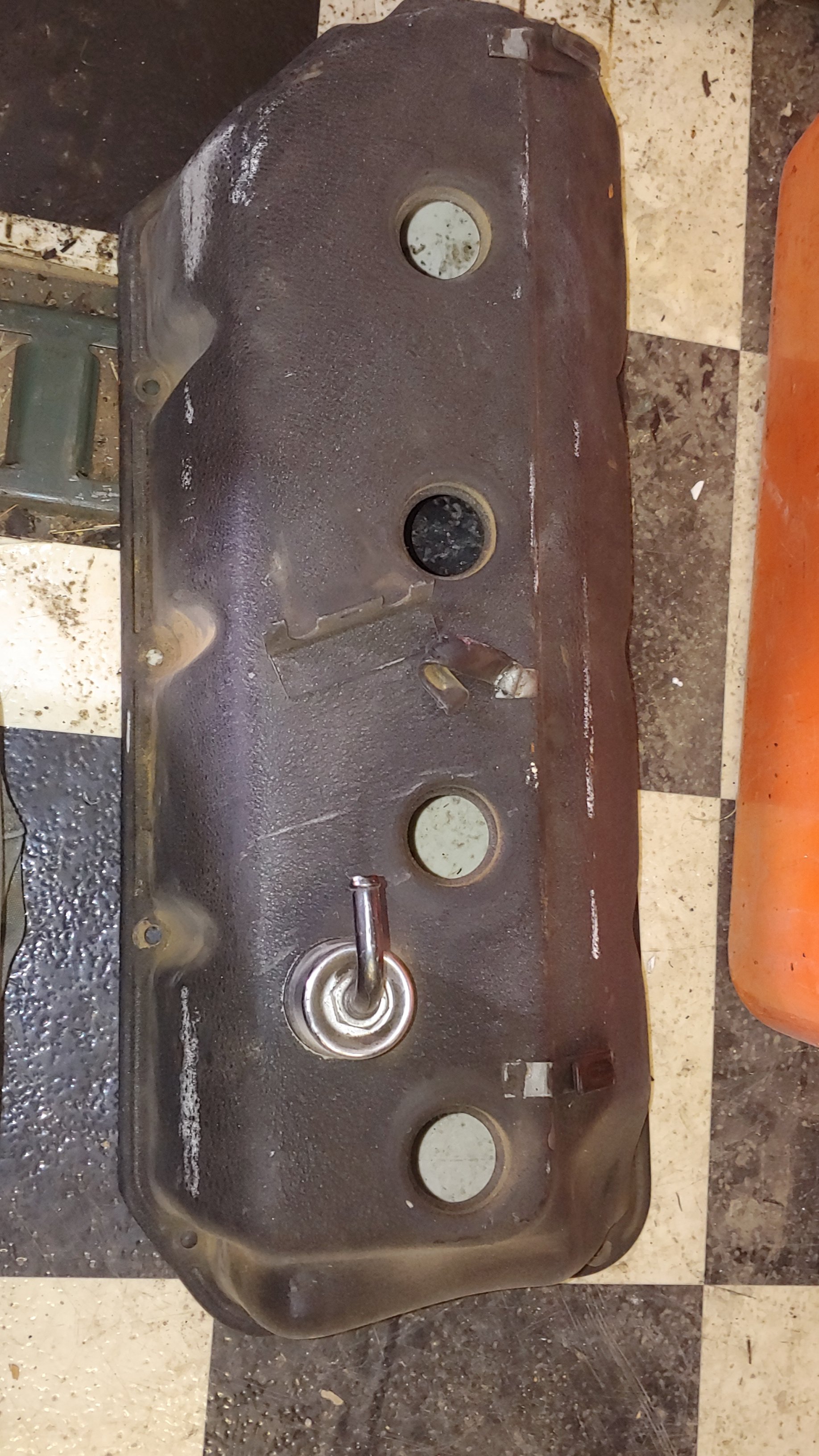

There is a set of iron heads. Some valve covers and as I recall the valve train.
I think, what is missing is a crank and an oil pan/pickup.

Mains - 90
Sides - 80
That's the torque for the main cap bolts in ft-lbs.

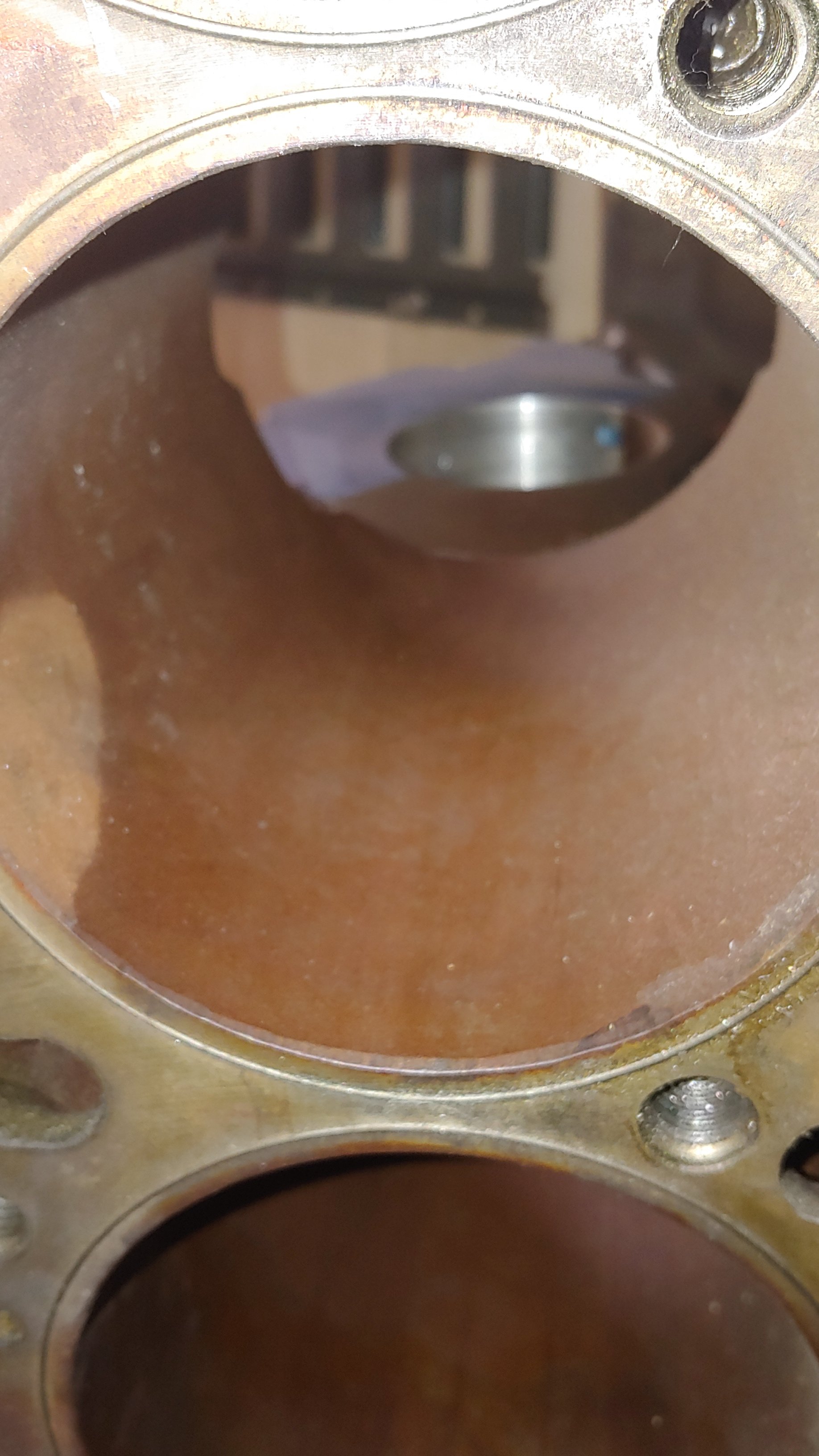

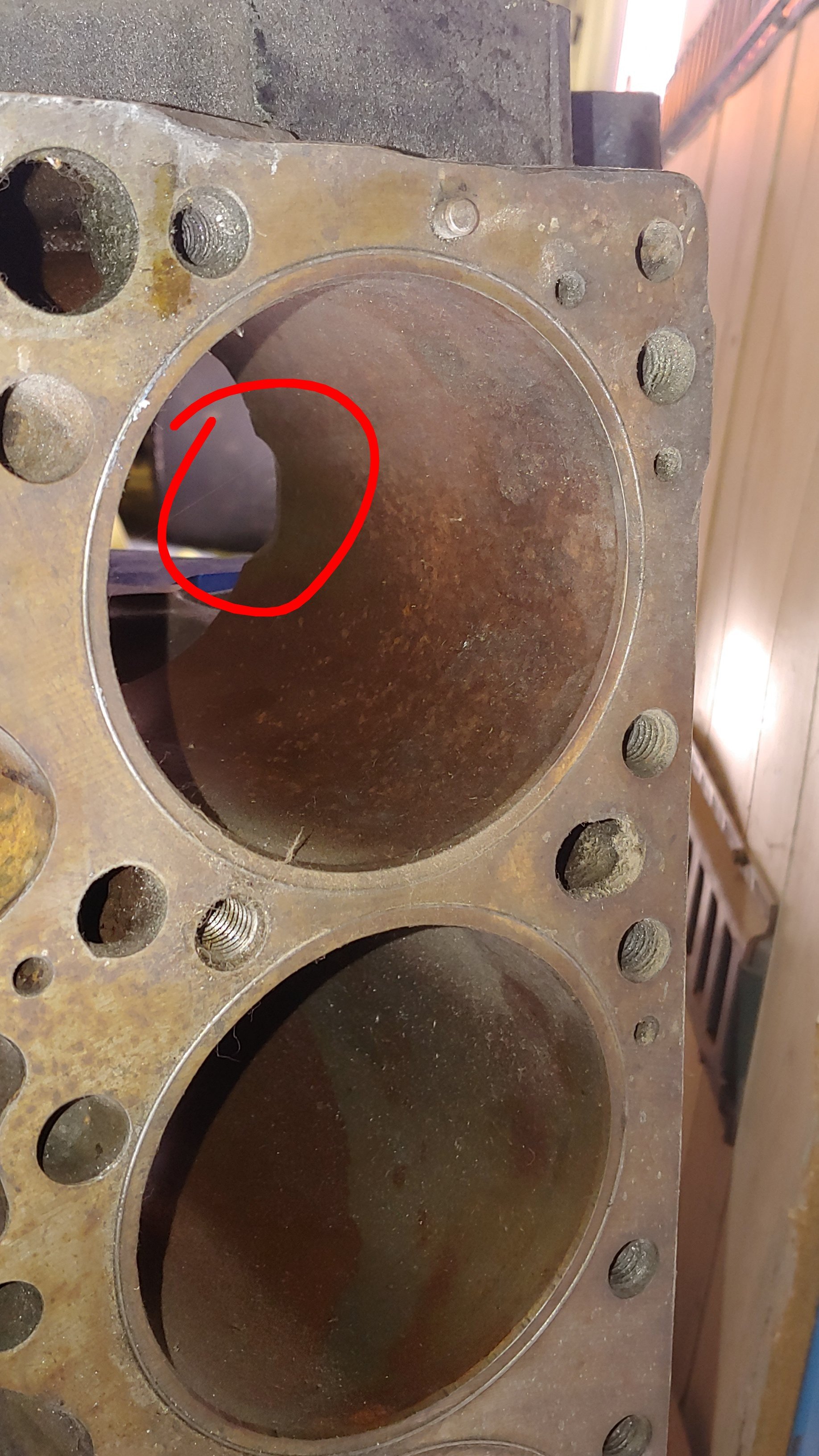

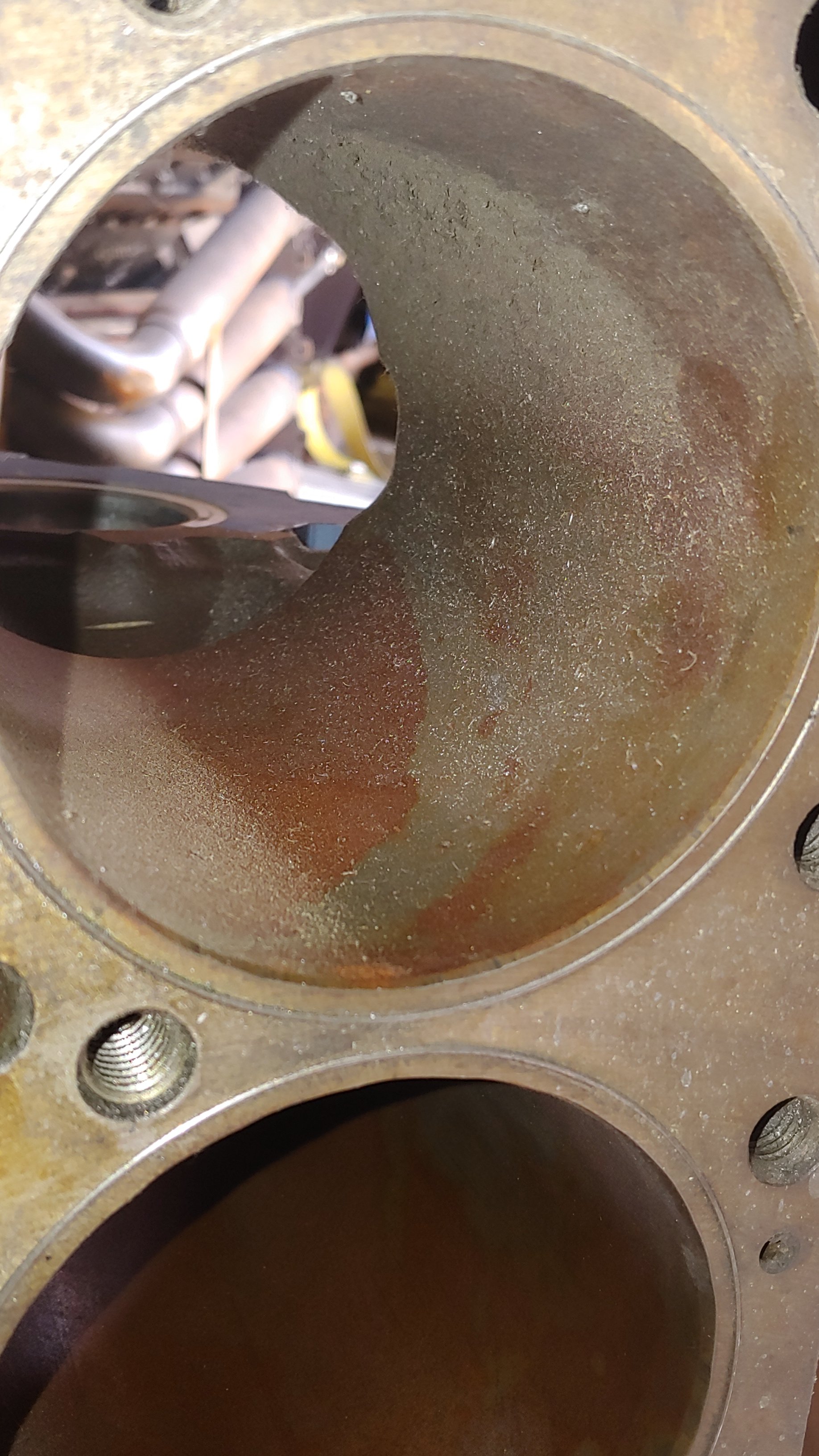

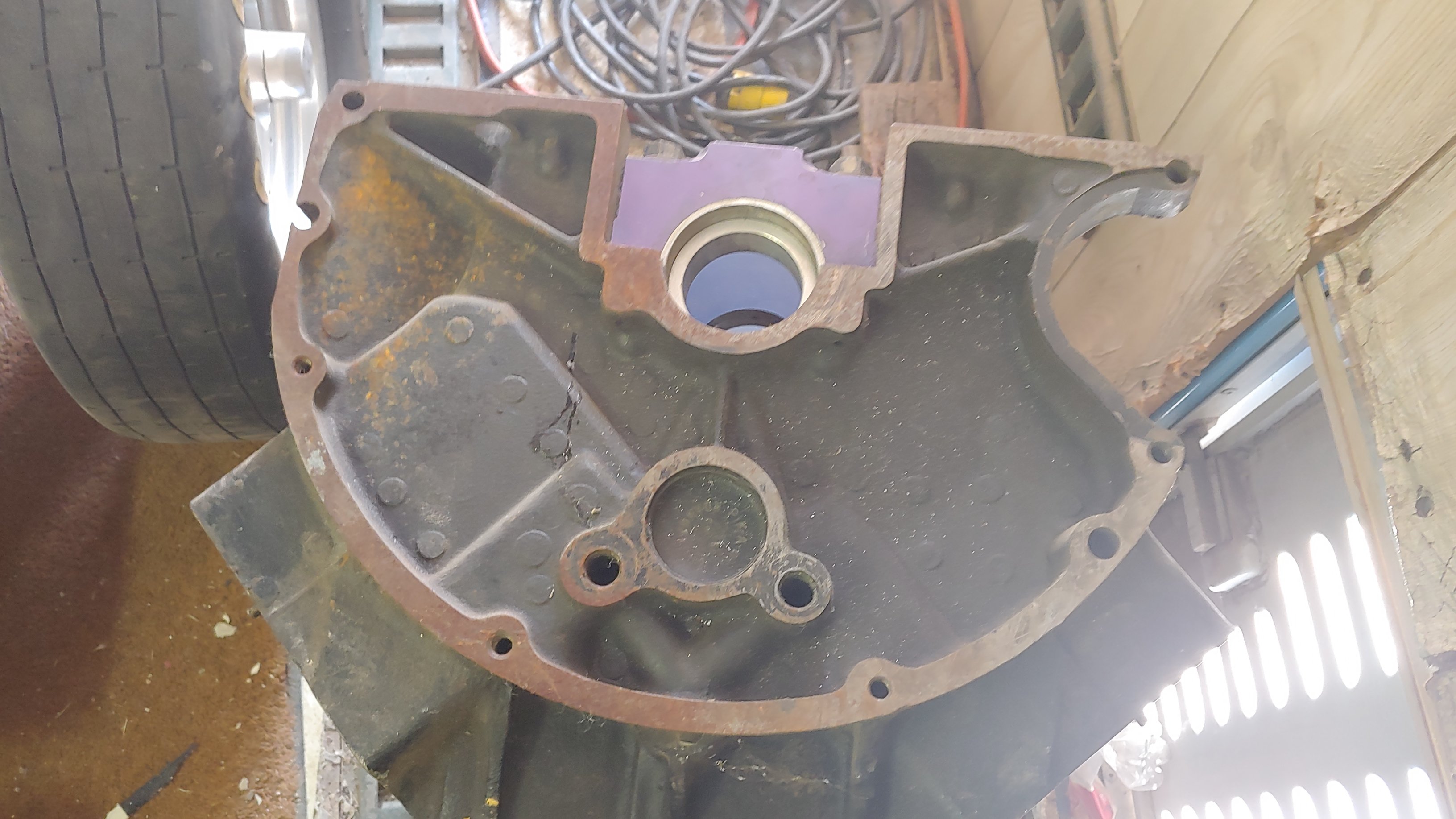

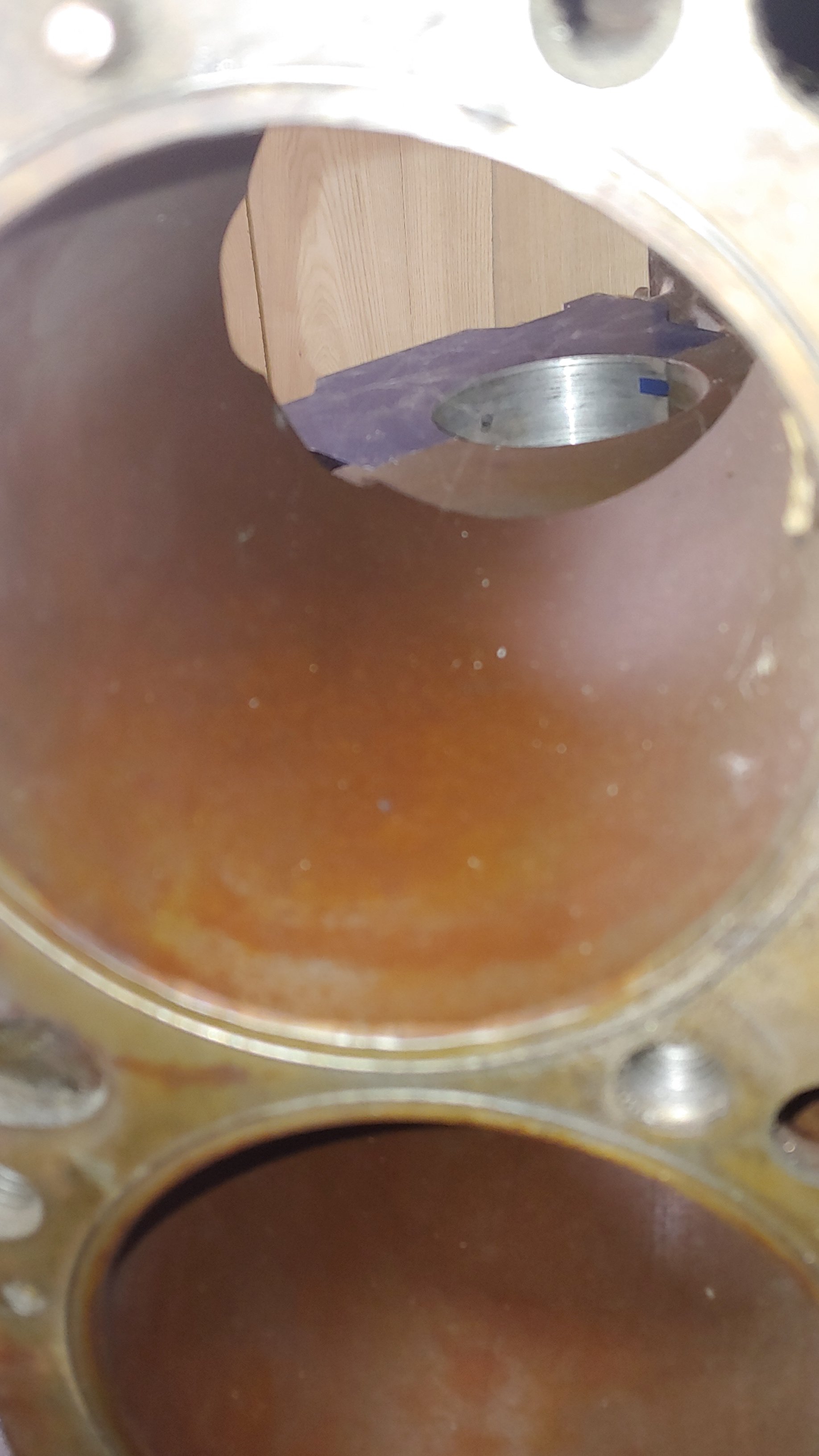

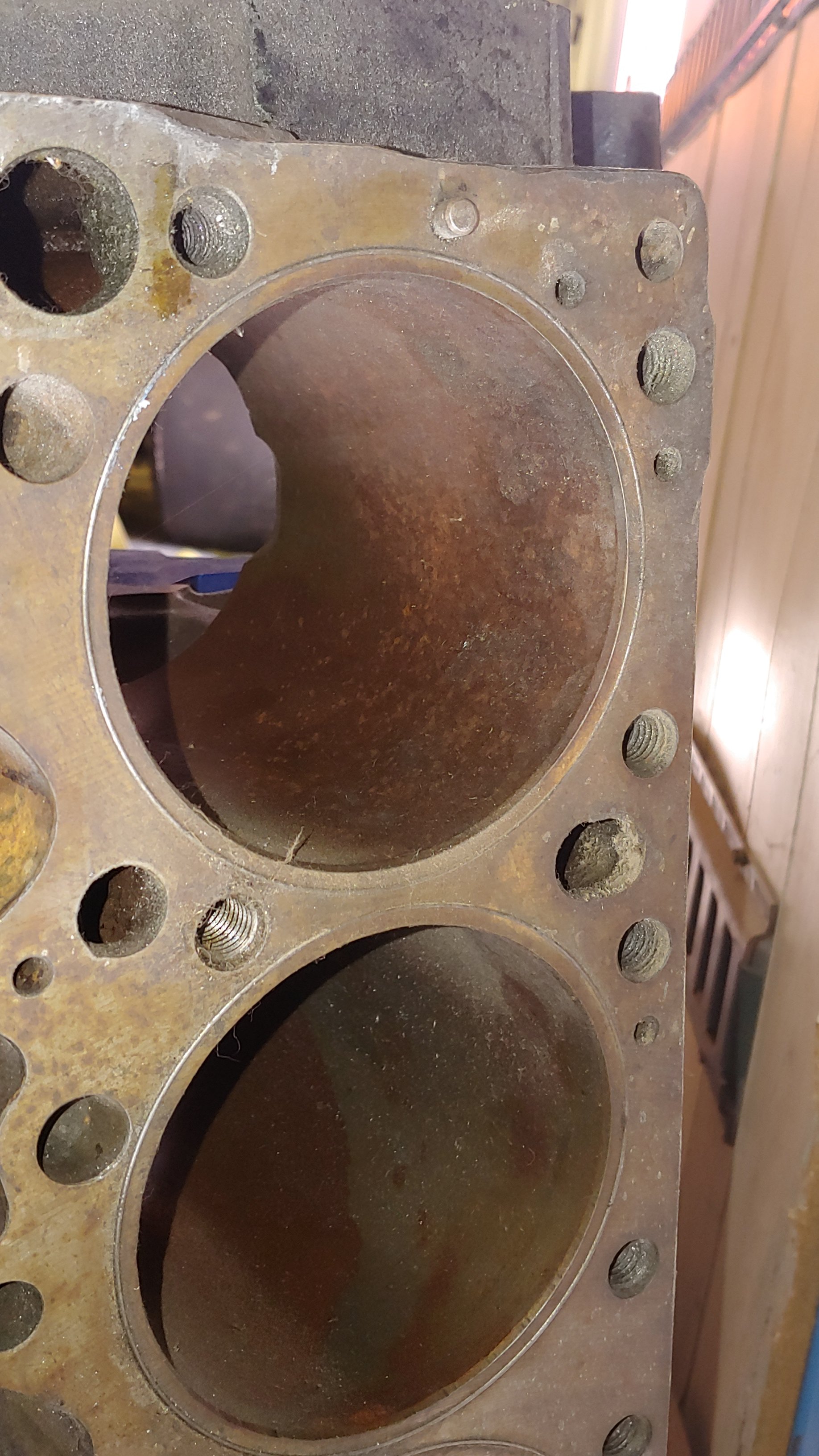

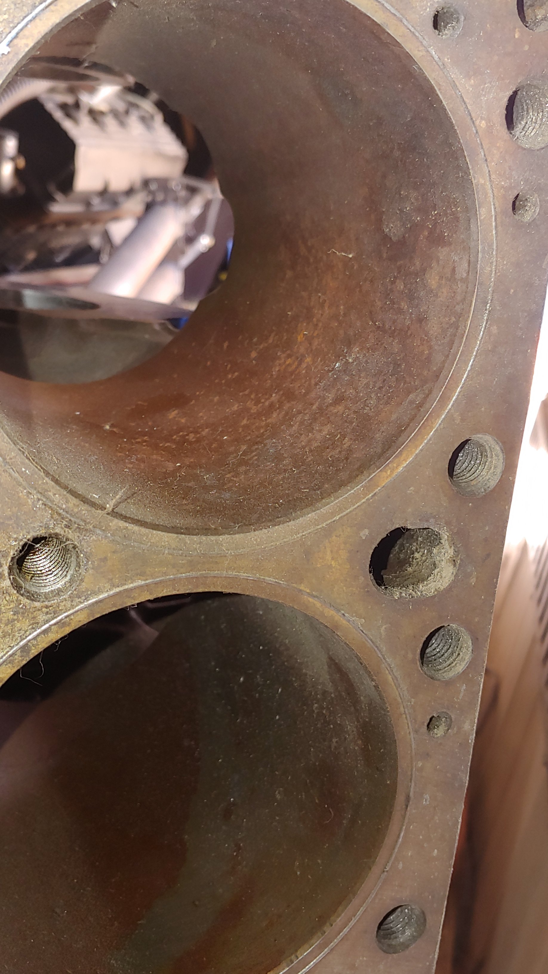

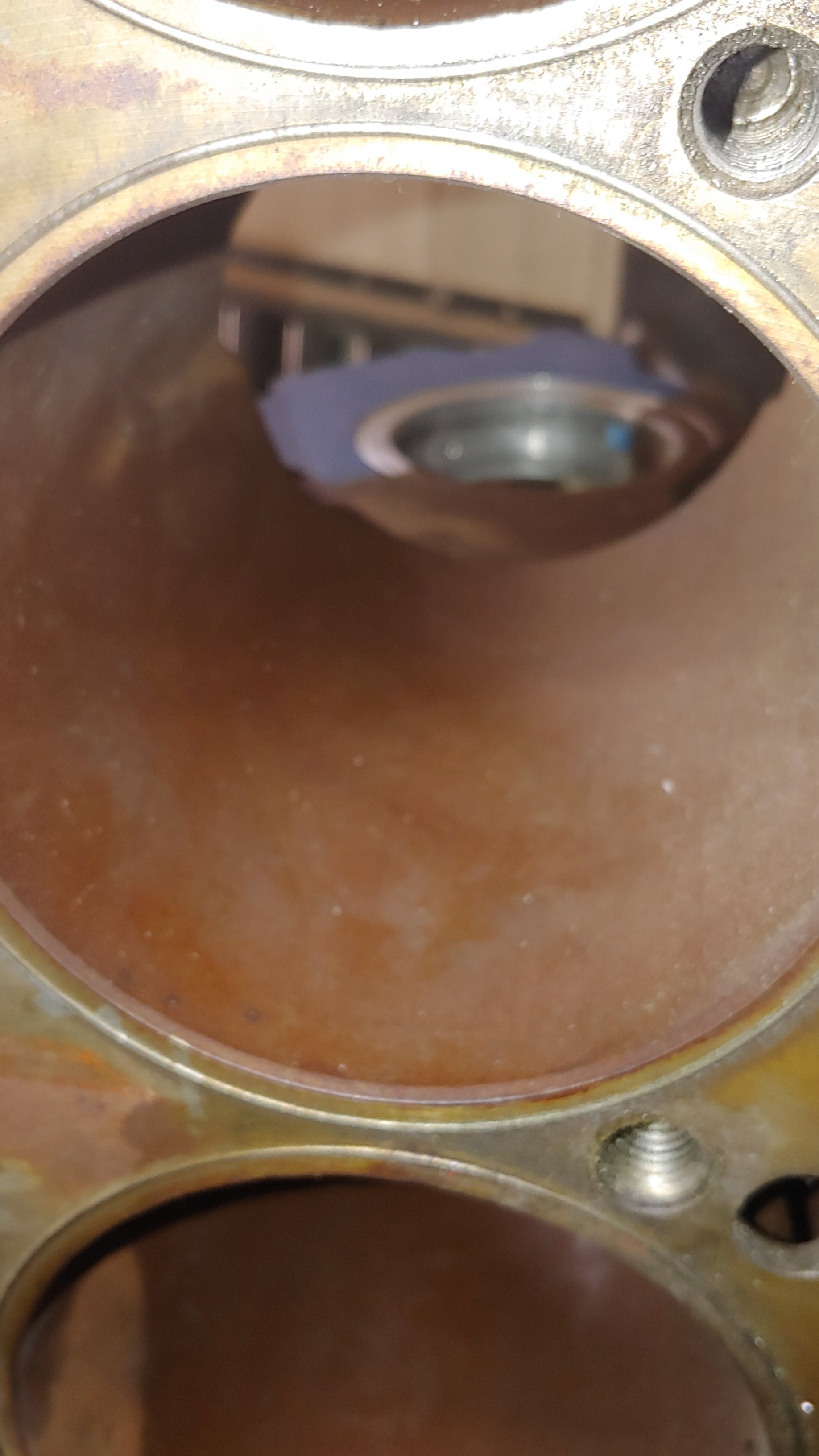

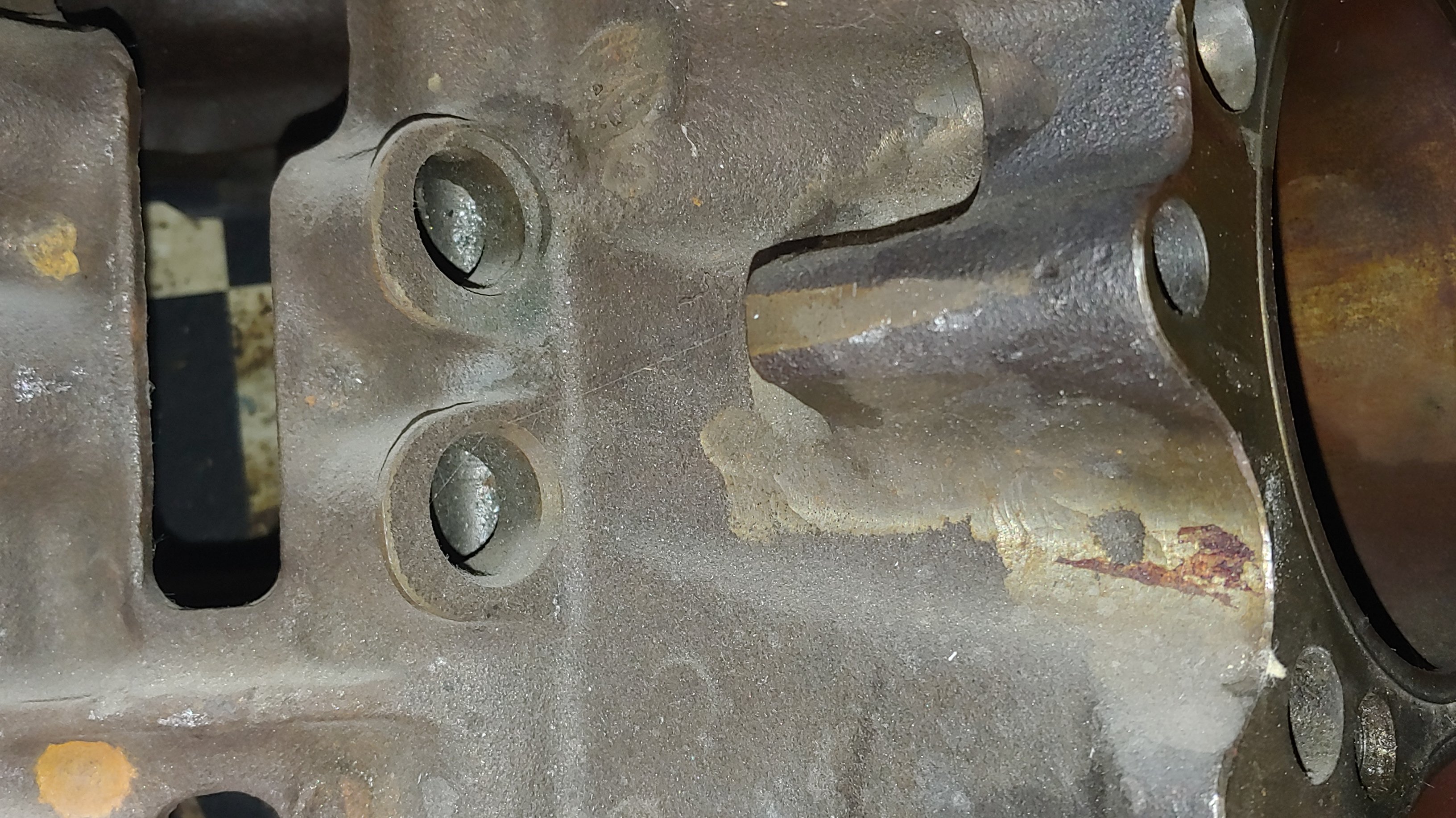

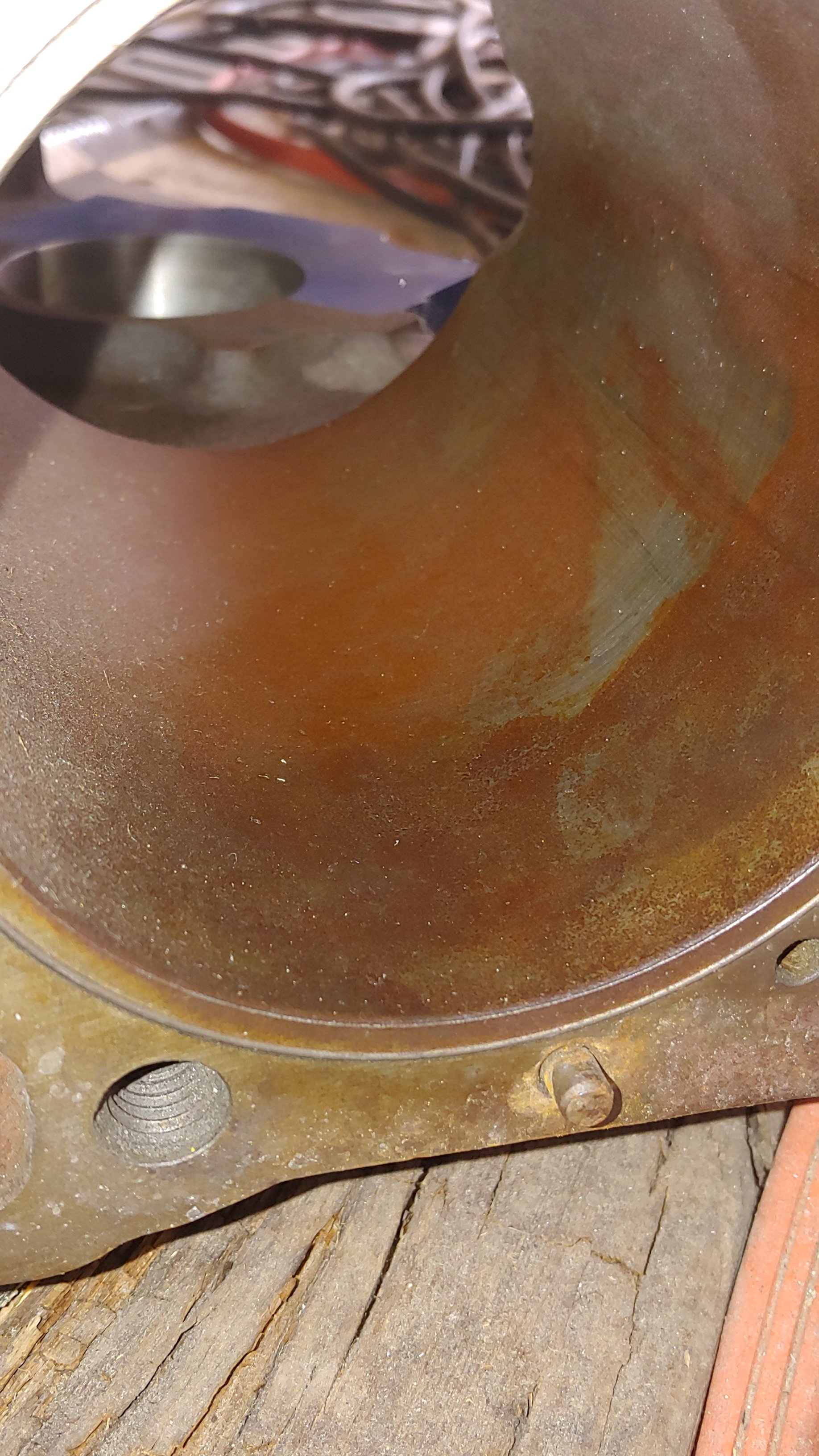

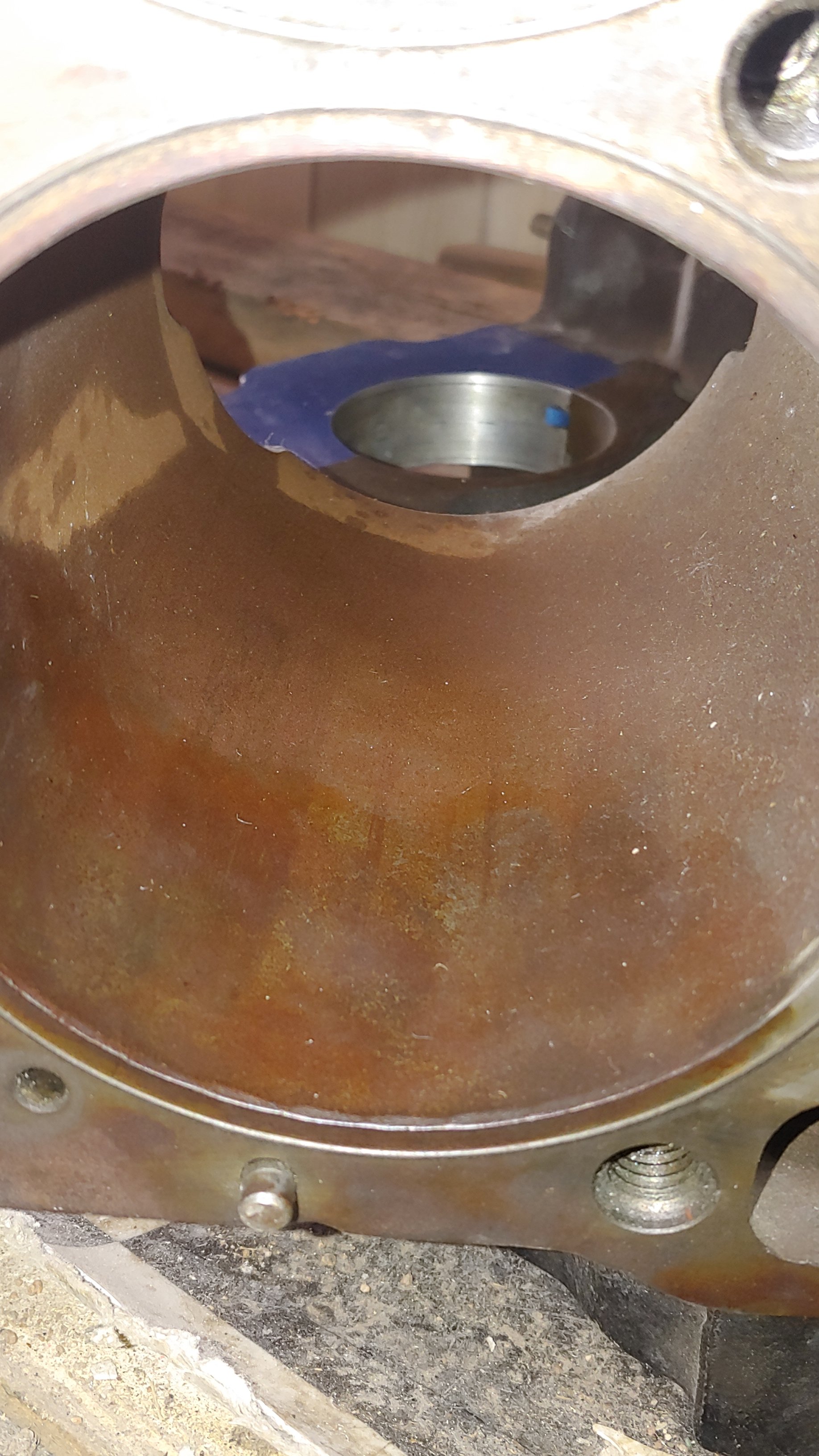

Obviously the block is notched to allow a stroker crank. Do you or your buddy know the current bore? Stock 4.250" or bigger?
Some 413 industrial engines had the eight bolt rear like the 426 Hemi, but they stick out further like the late 50s early 60s big blocks. The 70 413 industrial I walked the rebuild through with my son (that was fun!), had the regular six bolt rear flange.
You can run a standard 413/440 forged crank in a 426 Hemi block with no issues. It won't have the eight bolt flange, but who will know unless you tell them?
If you can get the block, a pair of good heads with a good set of rockers, just about everything else can be bought. Also the connecting rods are unique to. the 426 (longer than a 440 rod). Getting a good set of them would be a blessing.
I ask about the 413 because I have several industrial motors as well as a few 6 bolt motors.
The bore is 4.25. The owner ran this motor 3 runs, pulled it and put his 73 in and has run 150 runs on the 73 motor.
You say obviously it is notched, but to me it's not obvious as I am not a builder.
Which picture shows the notch, clearly?
Almost all of the pictures of the bores show notches. I highlighted one so you know.
Hopefully some of the Hemi guys will chime in regarding which parts are hard to get. But I think my list is a good start. And nothing wrong with a "budget" 426 hemi build!

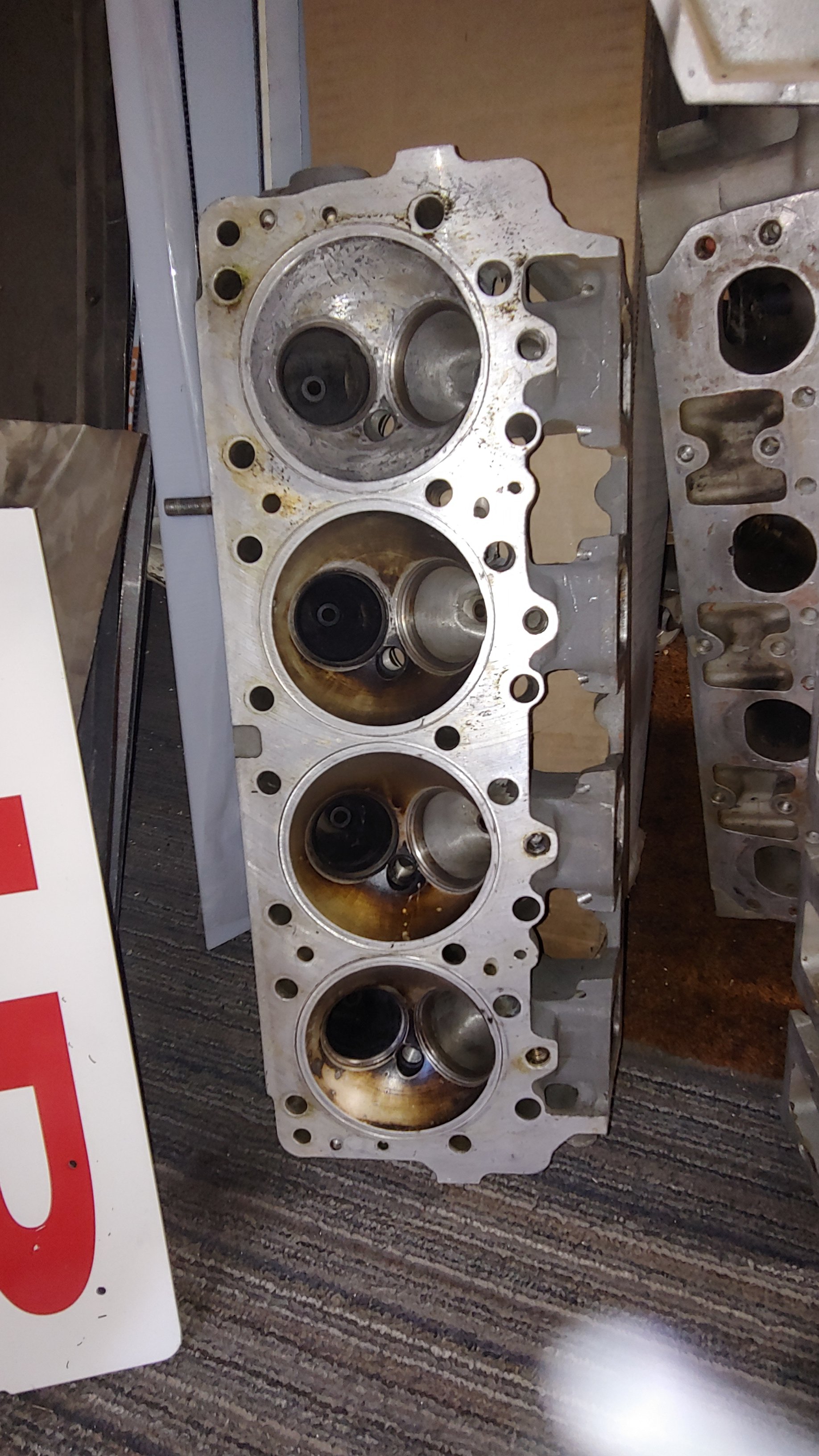

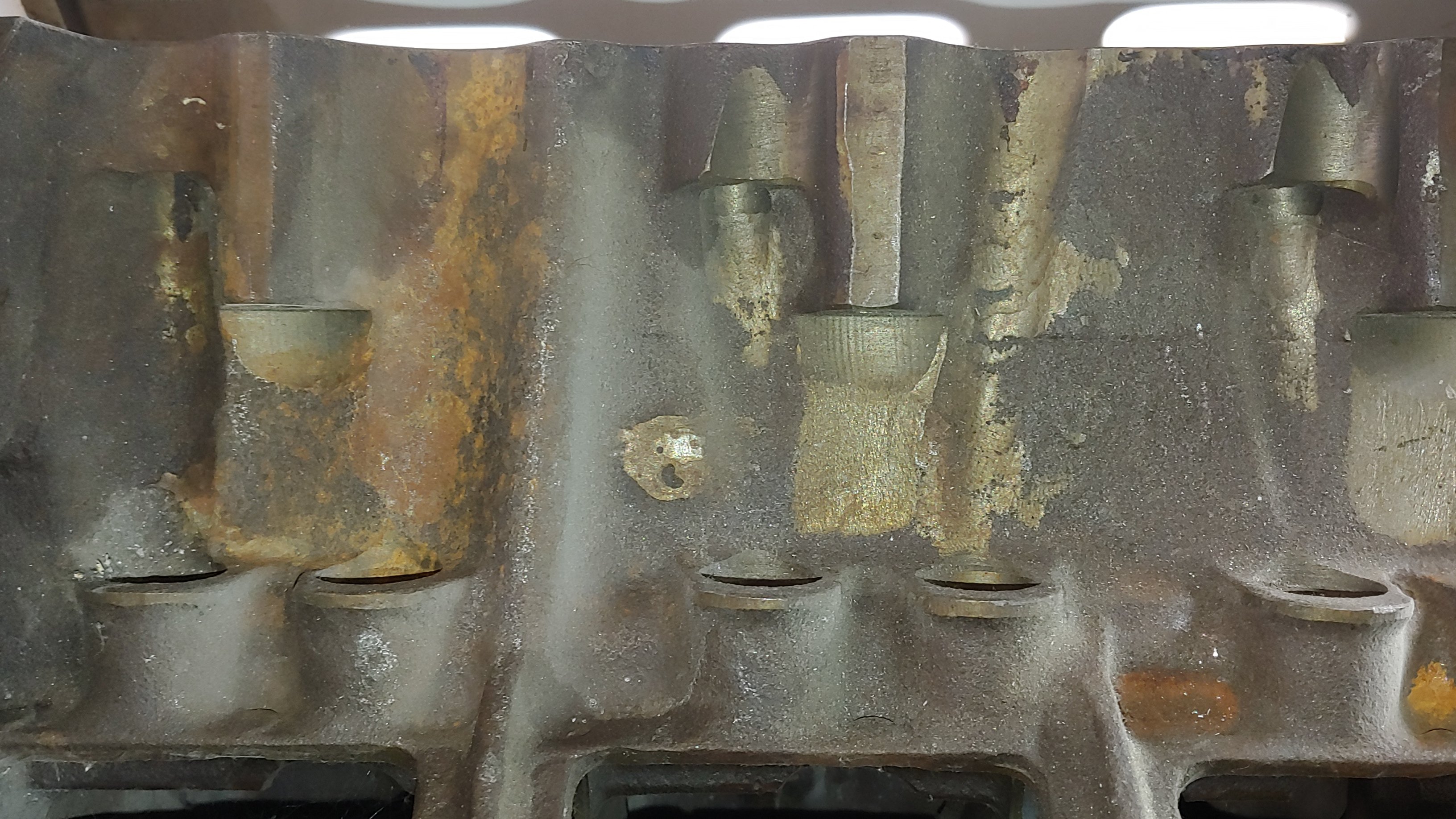

That block and the heads shown are cut for wire Orings, a common mod for drag race engines back then. They ran solid copper head gaskets with the wire Orings, which was a pretty much race only setup. I honestly don't know if the Oring grooves would be any kind of problem with running street type head gaskets, hopefully some of the older racers here would have insight on that. Just thought I would point that out.

Funny thing - I'd never seen those Keith Black blue anodized main caps before until yesterday when I bought a set.
The WT stamp is "Water Test", and if there are no other markings on the pad then it's prob an over the counter block - I have an NOS 1969 cast block like it.
