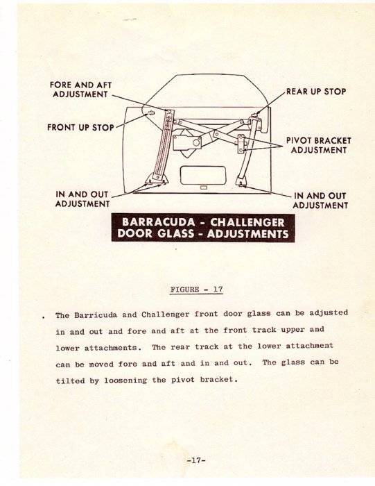

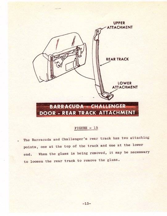

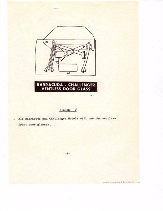

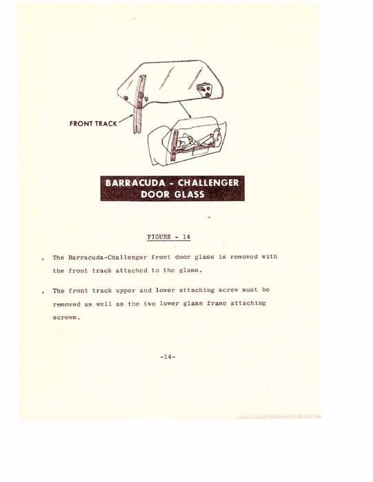

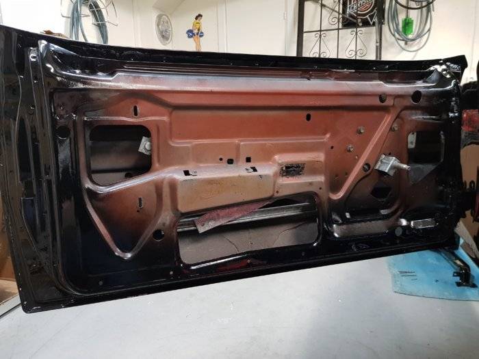

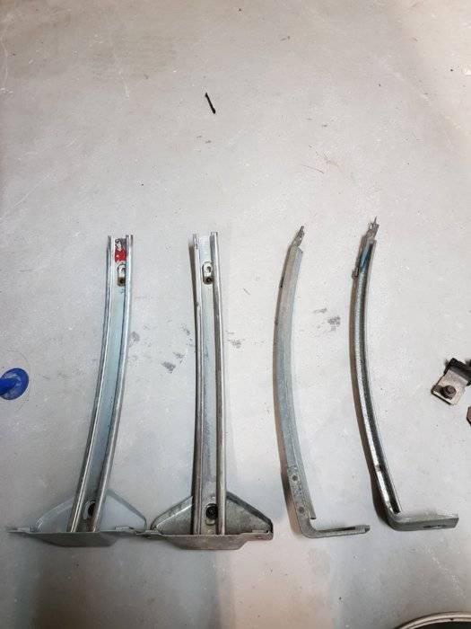

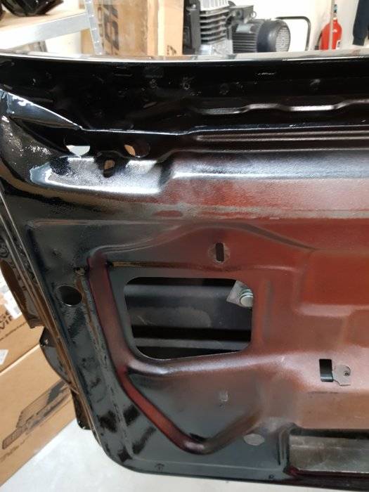

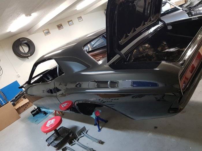

Iam from Sweden and have a -70 challenger that I have been renovated for 3 years, and now Iam starting to assembly it again. But I have problems to install the windows mechanism in the doors..
So I just wonder if someone here has some pictures on how it looks when its completly installed or maybe has some video of it? I have read the original manuel but i still dosent get it really... pictures would be easier for me..
