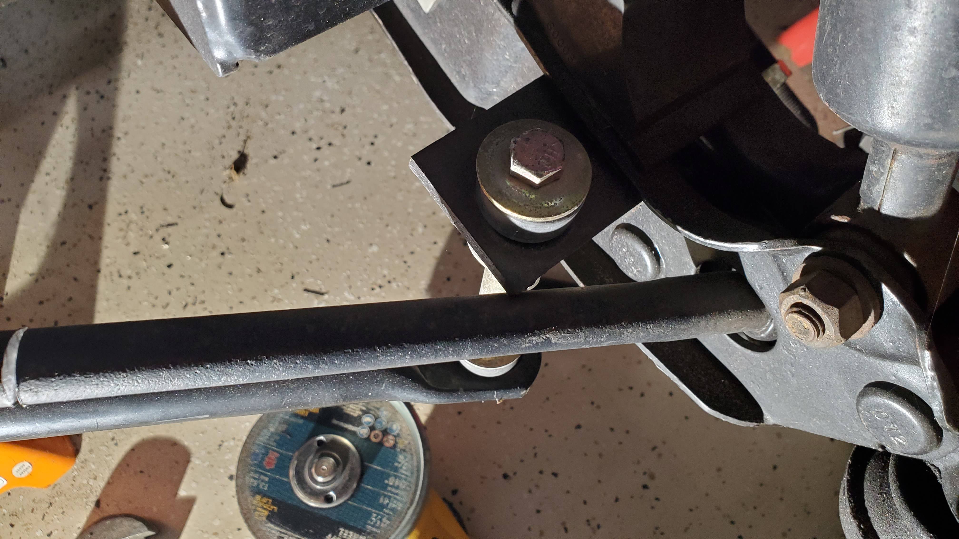

Yes it worked like charm. I just cut the old strut pulled it out and slip the hotchkis in. I had to trim the sway bar mount a little with a grinder. I have the bolt on sway bar bracket to the lower control arm. This maybe different on lower control arms with the bracket welded. Took a jack and put under the control arm and moved it up and down and seems to work fine. I put a car jack on the other side of the car to keep it stable while I did this. I didn;t want the car to tilt or slide with it up in the air on jack stands.

I have a bolt on sway bar. You can see in the pic that the original bar was hitting the bracket. I ground this area back to make sure the news cleared. There were really easy to do like this.
