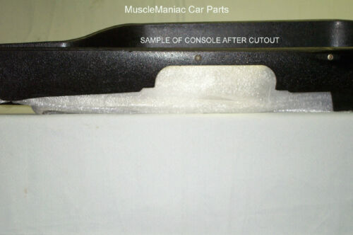

The lower half on the drivers side is cut out to accommodate the 4 speed boot, not cut on automatics. Picture from ebay, that company also sells the template.

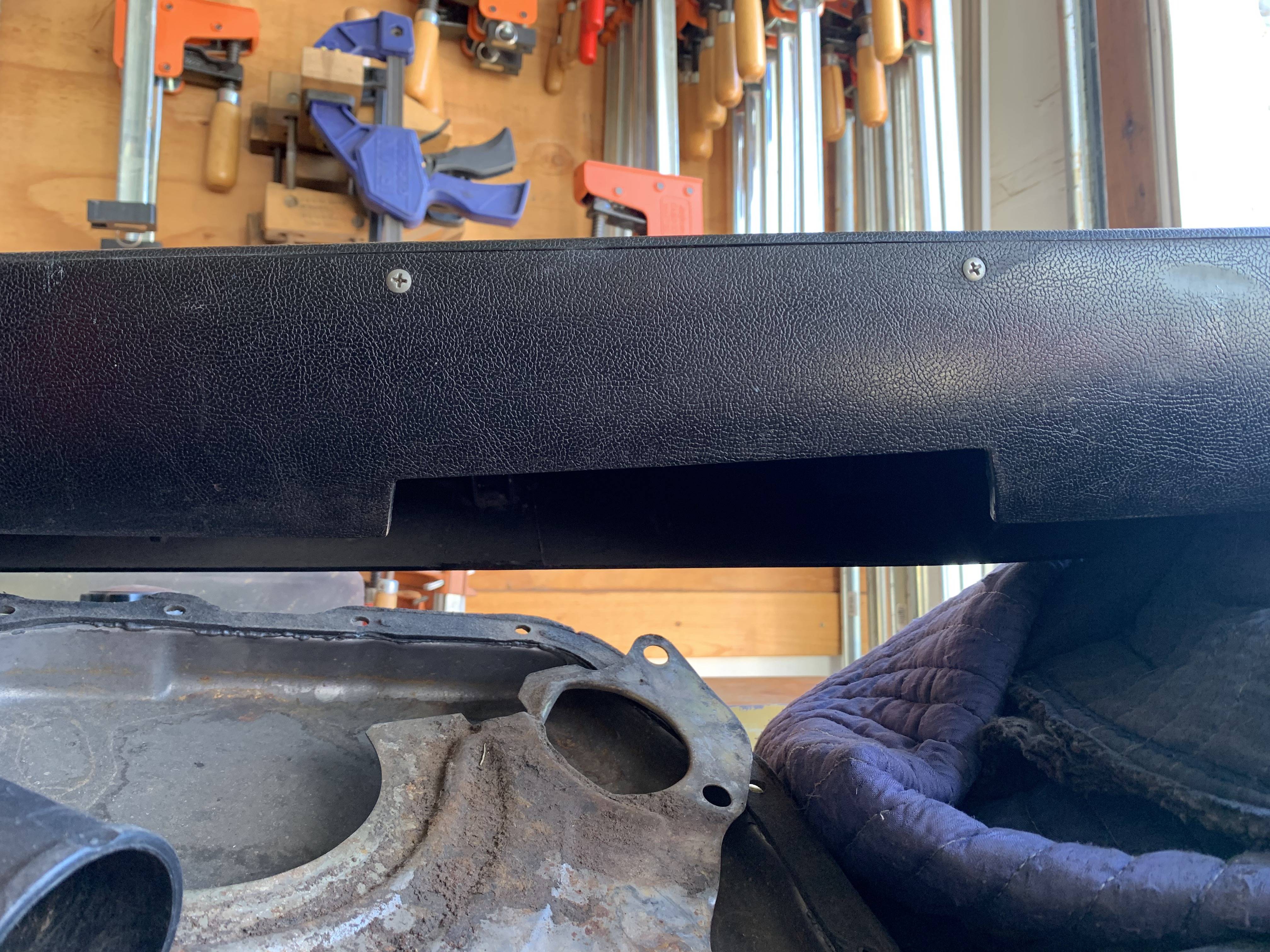

Thanks for all the replies. After looking at this image and comparing it to both of my consoles, I realize I have two auto consoles -- one with a 4 speed top plate. The reason I was asking about the differences was because they looked identical to me, and that's because they are.
I'll swap out the current console for the other one that's in better condition and switch top plates, so I have an auto top plate.
