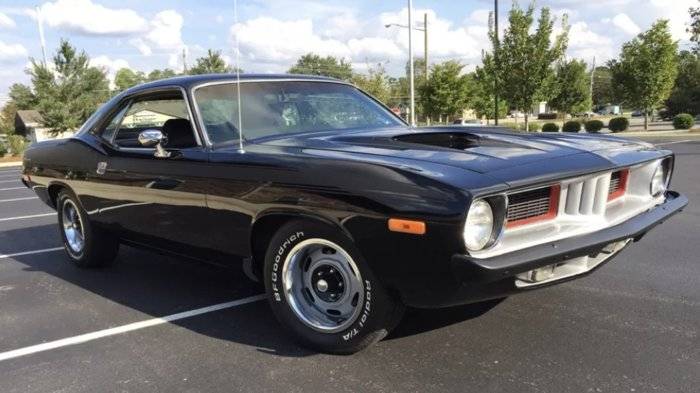

Welcome to the site from mid Michigan. Show us what your Barracuda looks like before you turn it into that "peeing machine":lol:
