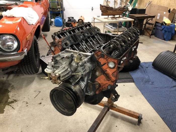

From California to Long Island (By way of Connecticut). So I already introduced myself a few months back when I first purchased my 1972 Barracuda from a great guy that recently moved to Connecticut from California. I first saw this car for sale on Bring a Trailer (great auction site) and it never hit its reserve. After the auction we wound up striking a deal and my dream of finally owning a real Mopar Muscle Car (not a 1975 Chrysler Cordoba) came true. I am a true muscle car fan with limited wrenching skills. I could never repay my best buddy John (who is mostly in the photos) who is helping me through this journey. He is a Chevy guy but has warmed up to this little mighty mopar and is just as excited as I am to start making her even better. As said earlier car lived 98% of its life in California. 3 previous owners (last one since 1999). It retains all its factory sheet metal and in early 2000's was fitted with a rebuilt 1969 340 with x heads, mild cam, TTI 904 tranny and fi-tech fuel injection. At first I figured to just drive it as is and did so as much as possible over the last few months. Couldn't really get the fi-tech dialed in and was disappointed with its off the line power. Once she got going she quite the runner but what good is a muscle car if it cant do long smokey burnouts. At first I wanted to just change from a column shift to center console floor shifter and replace the racing seats with factory reupholstered ones. I was also going to replace the fi-tech with a Holley Sniper Fuel Injection (rated for up to 600hp). The engine compartment also needed some tidying therefore I was going to pull the motor anyway. That lead me to my current journey. Of course things change. We are gluttons for punishment. While the motor was pulled we pulled the heads and saw that the block was already bored out 40 over and was in excellent condition. The cam bearings showed some wear and needed replacing so what the hell, lets build a stout small block that sounds mean and can do all the smokey burnouts to my hearts content.

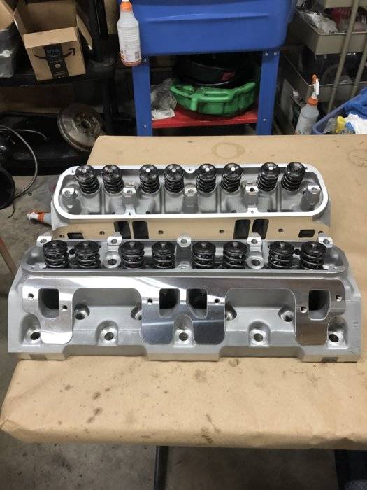

I recently just bought the following:
Speedmaster Cast Aluminum Cylinder Heads with Hydraulic Roller Cam 65 cc / 170 cc
Comp Cams Mutha Thumpr Hydraulic Roller Camshaft 522/509 lift, 291/311 duration

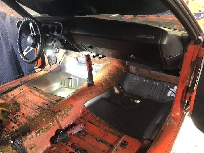

Replacement front floor pans

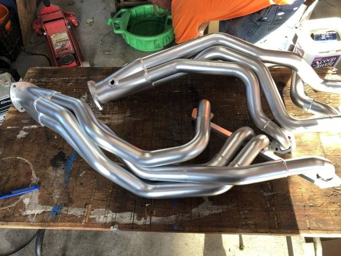

TTI Headers

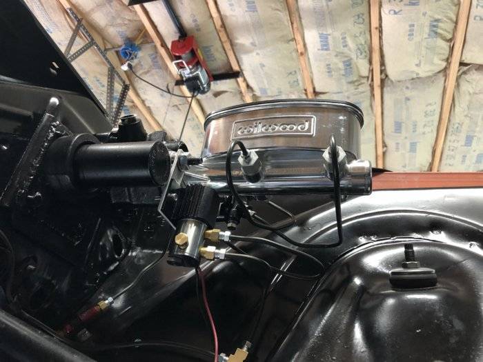

Talon Hydraulics Hydroboost Wilwood Brake set up

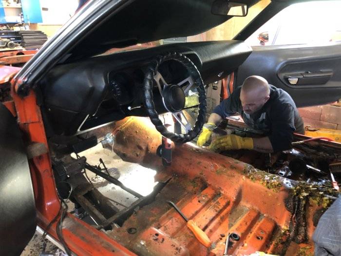

Here is me pulling the car into the garage the first day I got it home:
