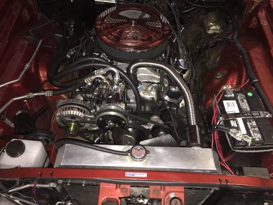

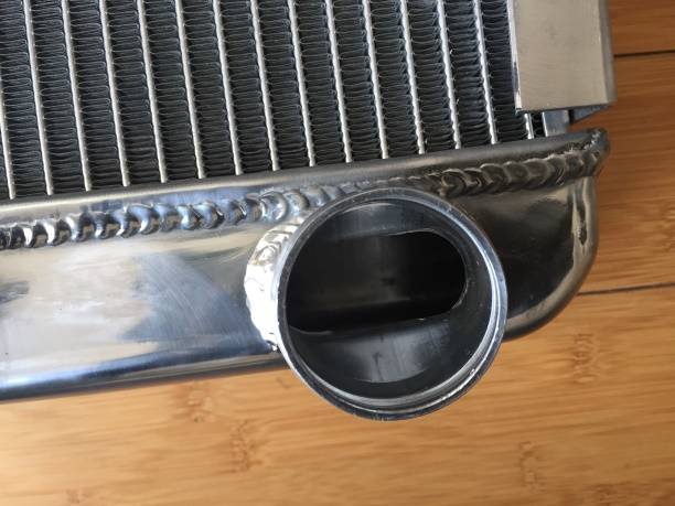

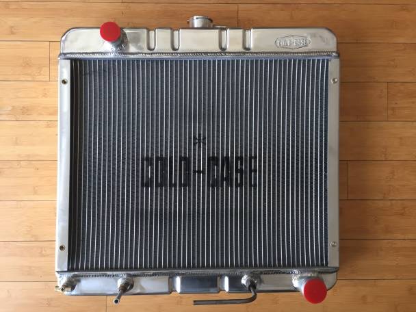

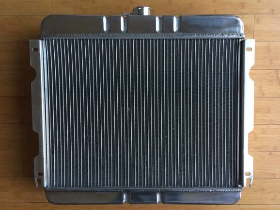

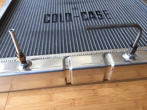

My super positive experience, installing a Cold-Case aluminum radiator in my 1971 Barracuda pictures included.
Was having what I thought were radiator overheating problems with my aluminum Champion 4 row radiator that came with the car originally at purchase as fairly new.
After much ado I found out that the engine may have a blown head gasket so the radiator was not the factor for the extreme overheating issues.
I posted on my Mopar forums the problems I was having with another radiator company I tried and their lack of customer service.
That is when a representative from Cold-Case Radiators graciously reached out to me with an offer to try their radiator and that they would work with me and the Mopar community to address any fitment issues so that they would be able to sell us a product that fit right the first time hereafter.

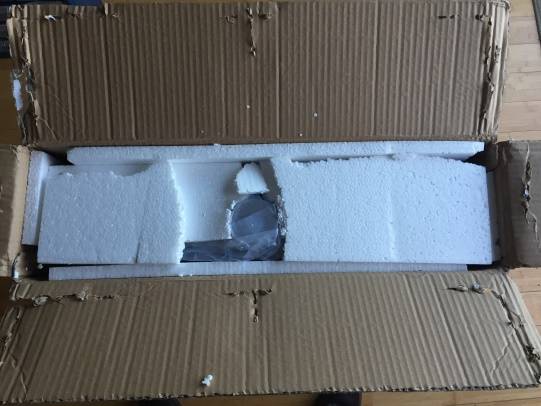

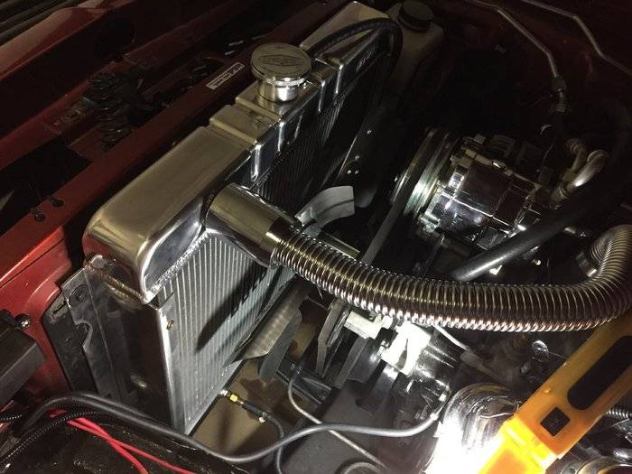

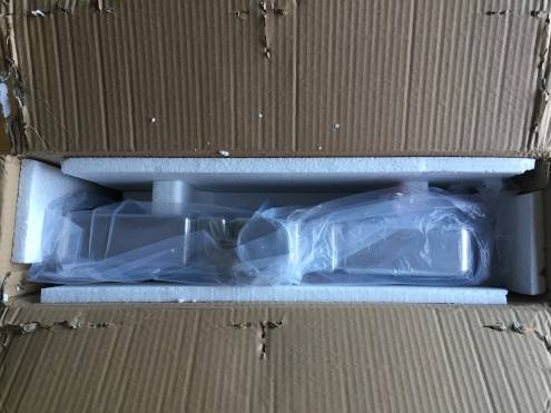

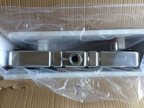

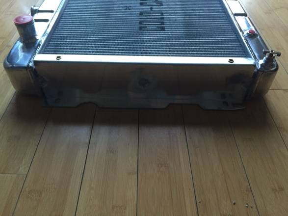

Long story short I bought the radiator and installed. It was way easier than I thought. When I opened the well packaged box I was impressed on how well it looked already polished. They can be painted black for those that like or prefer the stock look. Once painted would be hard to tell it was not an original old Mopar style radiator. Also came with a fancy aluminum billet radiator cap.

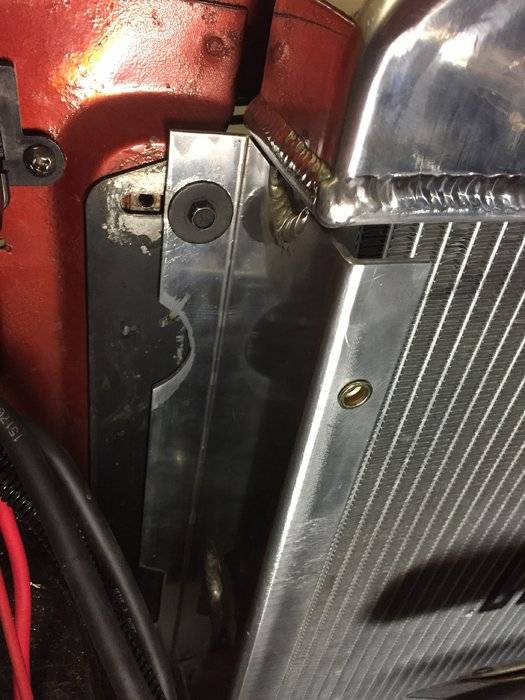

The radiator pretty much fit as is but the holes at one end of the radiator support were not in the correct location. I had to drill 2 new holes.
Here is the BIG difference between the prior radiator company and Cold-Case, Cold-Case offered from the beginning to replace it with a correct fitting one if it did not fit right. The other more expensive radiator manufacturer said to just stop complaining about the little things, drill holes and live with it.
Cold-Case just asked me to give them the correct measurements in order to do so. So I will replace it with the “new” one when it comes in and report on that installation in the future.
I will insert pictures in order from the way it was packaged, opening, and preparation to final installation in installments. If any questions, I can answer them before proceeding to the next steps, in the pictures below them.

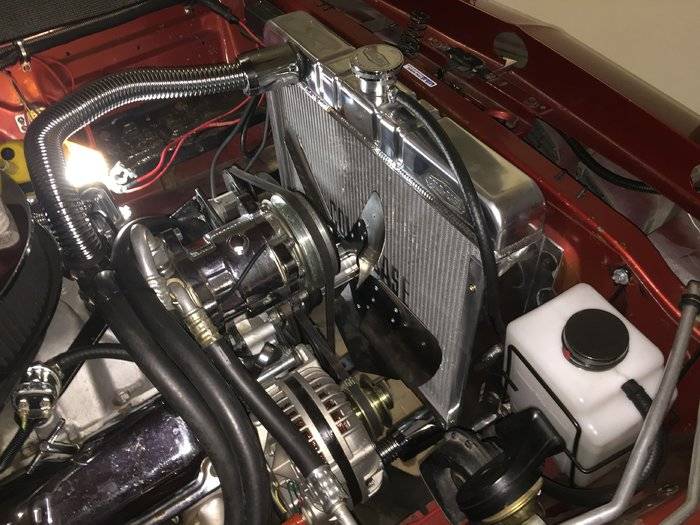

With Champion 4 row temperatures would reach up to 230 if ran more than a half hour in idle and about from 190 to 200 on the highway. Once off the freeway and onto the street would quickly overheat to around 220.
Under the same conditions the Cold-Case 2 row temperatures would only be 210 at idle and down to 180 to 190 on highway. Once off the freeway and onto the street would heat up to around 200.
Even with the overheating engine problem quite a big difference in temperature range.
I know I have to fix the underlying engine problem but at least in my mind it shows that even under those conditions, at least in my case the new radiator lessens the overheating problem.

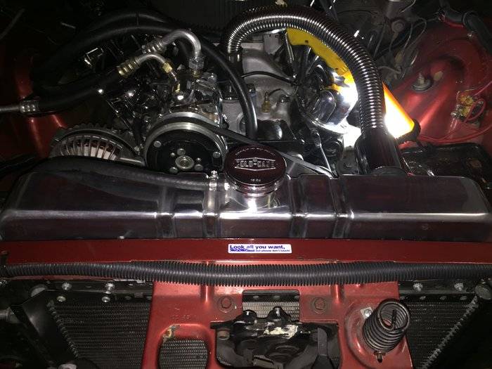

The way it was when I bought it. Except with new chrome top radiator hose and removed chrome 5” radiator shroud.

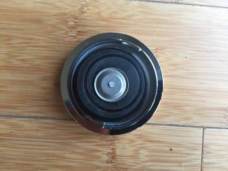

Test and replace your thermostat as needed. Use factory recommended temp. Use high quality parts. Test and replace radiator cap. For the older Mopars (60's and 70's) a 16 lb. is the most common size to use. Install a coolant recovery tank/system. This keeps the radiator always topped full of coolant. Use a fan shroud, always. Use the original rated clutch fan, not fixed flex blades. The clutch fan only works when the cooling system requires more air to flow through the radiator and disengages when not needed. No constant parasitic drag, loss of power. The most common cause of overheating is not the thermostat, which is the item most replaced when the car starts to run hotter than normal. But is rarely the problem. Check the radiator cap first. The purpose of the radiator cap is to pressurize the cooling system which depending on coolant condition will raise the actual boiling point several degrees above the normal 212 degrees at sea level. 220 degrees is not necessarily overheating. Modern cooling systems run on the hot side. It helps to lower emissions. Always perform PREVENTIVE MAINTENANCE to keep your ride happy and dependable.

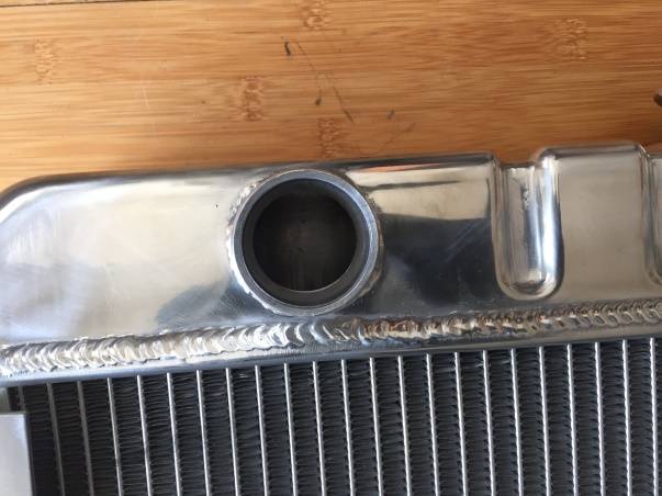

Look at the photo showing the inside of the radiator. Look at how small the openings are on the core passages. Wouldn't take much to restrict the coolant flow. Oh, and btw black is a better radiator of heat. The black paint used on conventional radiators is actually a special formulation to help radiate/dissipate heat more efficiently but any black will work better than none.

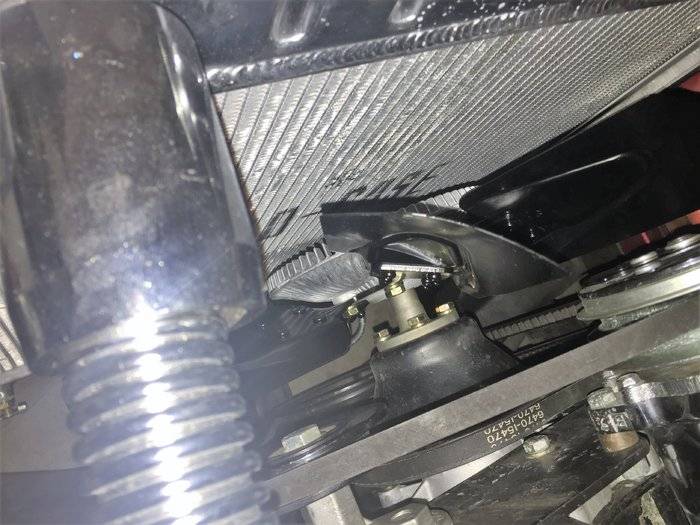

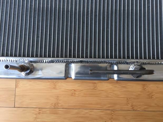

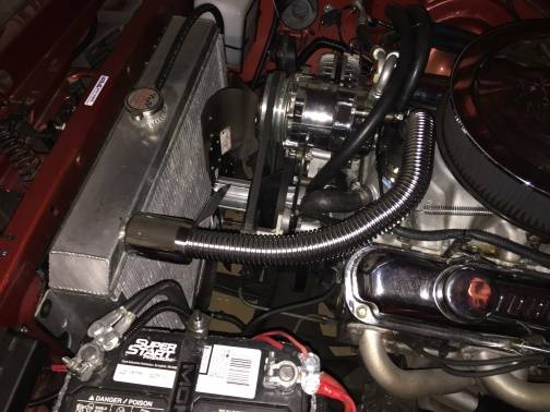

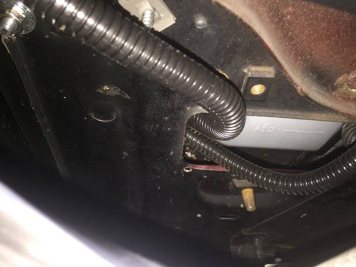

Some easy prep installing automatic trans cooler lines. Also some installed with aforementioned hole placement shown.
I need to clarify that the transmission lines on my particular car had been cut that way because instead of an OEM 727 automatic transmission I have an upgraded A518 modern overdrive transmission.
So that is not an issue with the Cold-Case radiator but with my customized transmission.

That radiator is a nice piece! Try to insulate it from the brackets or you could get electrolysis eating it up...
MoparcudaRay
Sep 19, 2016
120
14
Riverside, CA
Excellent idea, can you give us more detail as to how to do it? Such as Plastic or rubber washer insulators?
Adam
Dec 25, 2012
1,647
703
Washington
I used strips of rubber b/t the radiator and mounts, top & bottom. Also make sure the radiator is not used as a ground. There is a lot of info on the web, including Griffin Thermal Products, at griffinrad.com

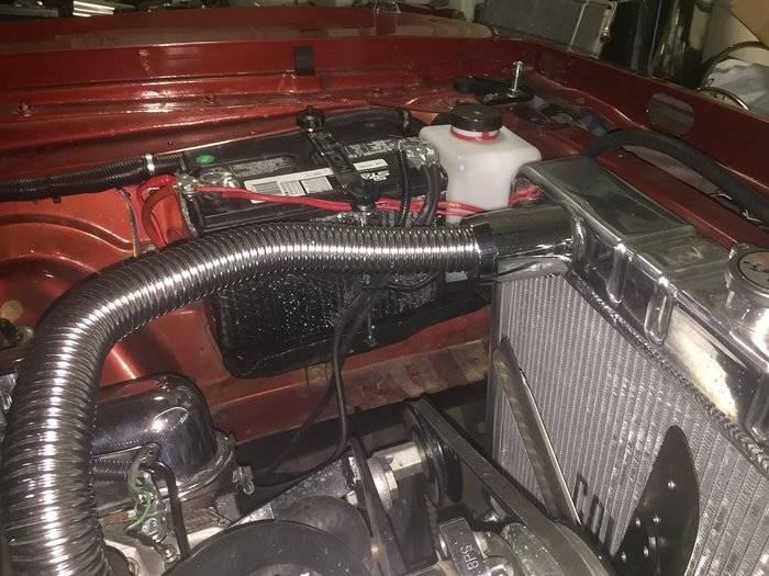

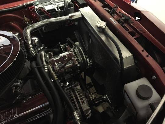

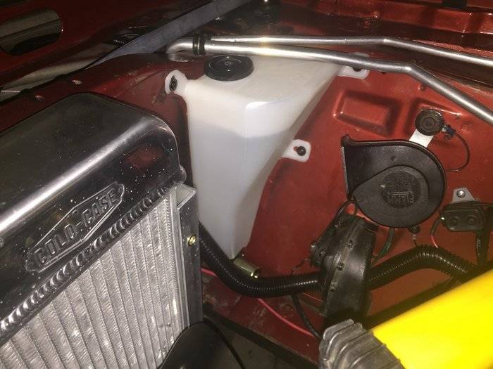

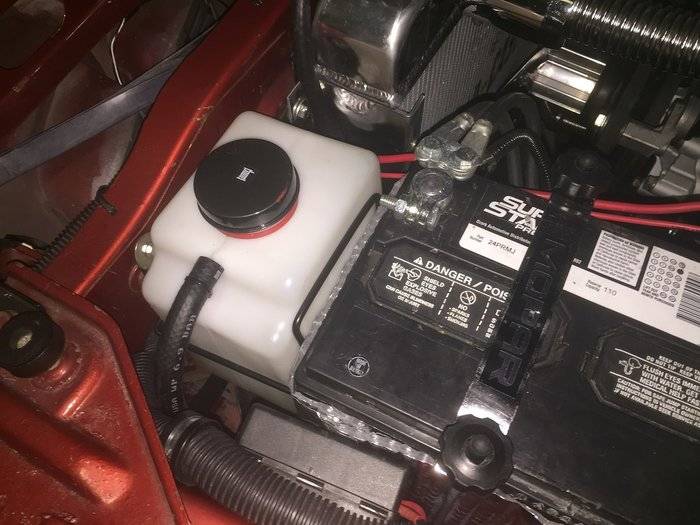

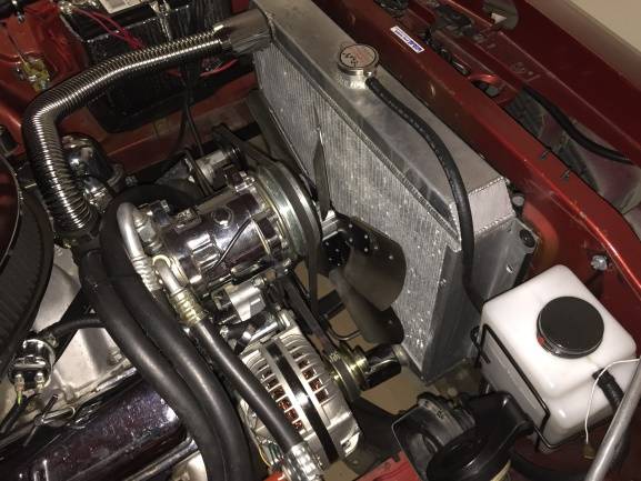

While at it I decided to put a replacement OEM wiper liquid reservoir and use it for its intended purpose and not like some who I have seen use it for a radiator overflow tank instead.
My understanding is that not until '73 or '74 did they even have an overflow tank it just ran from the radiator nipple to the street from '70 to '72.
Below is my setup for both. Mopar put it between the battery and the engine which I did not like.
Notice it also lets me see the anti-freeze level at a glance from the front radiator support hole.

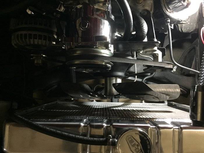

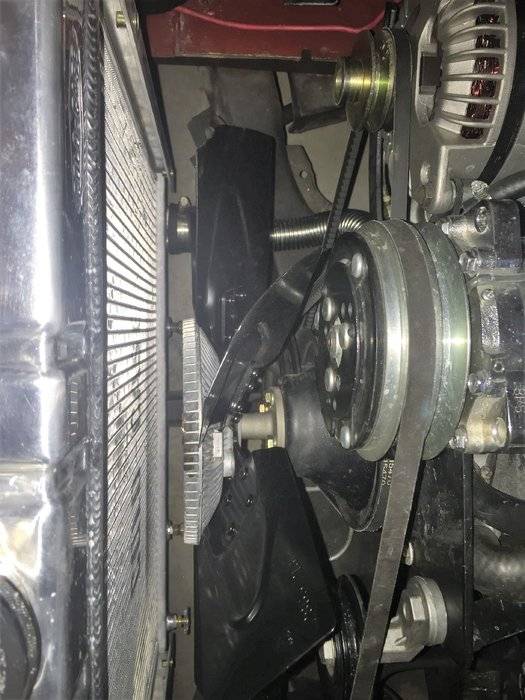

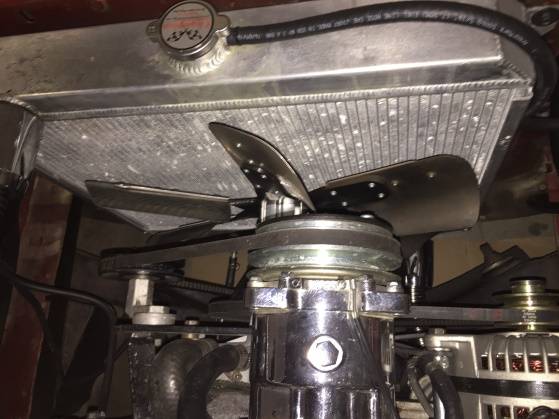

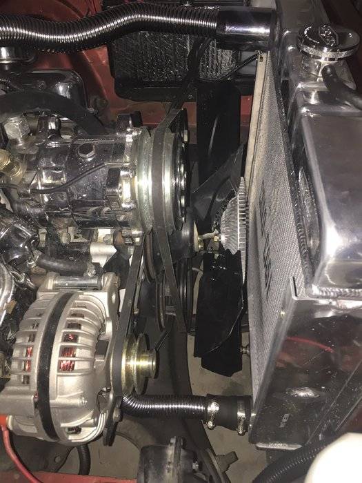

Installation of Mopar 7 blade clutch fan and clutch fan assembly. Seems to be the perfect distance so just awaiting to install OEM fan shroud.
I used Grade 8 bolts for added piece of mind.
