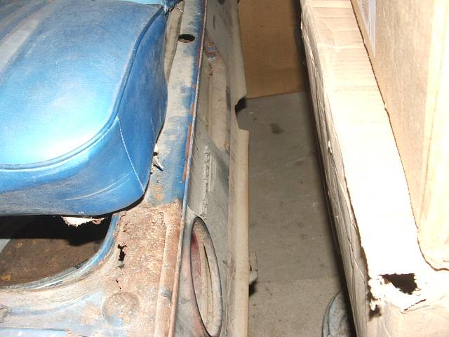

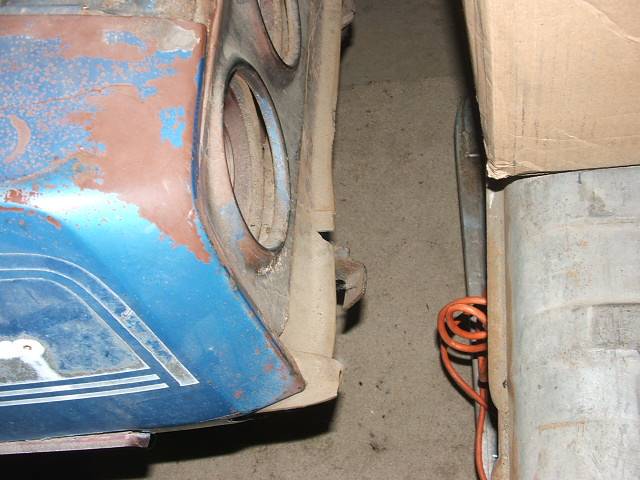

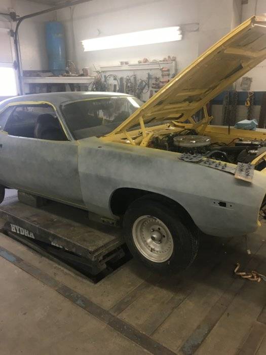

you didnt,there almost 50 year old plastic parts that get brittle over time,i did mention the damage before taking the pics,just a suggestion have you thought of just eliminating the filler pieces,all you need is 70-72 cuda rear bumper brackets,it will tuck the bumper nicely under the tailpanel,thats what i plan on doing to the car i sent pictures of
