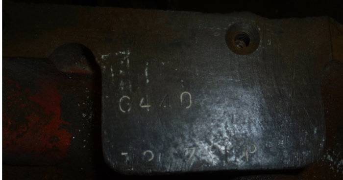

Hi,
I have a 1971 Challenger RT 440 built on April 6th, 1971 and looking for a date code correct motor.
I found one that has a casting number on the side October 22, 1970. The top plate is stamped G440, 12 7 HP.
My question:
#1) Is this engine built on December 7, 1970?
or
#2) Is this engine built on December 7, 1971?

Here is a picture of the stamp

Most blocks were used approx 3 months after casting & the G stamp confirms it was built for use in a a 71 car

Thanks, but do you believe it was built in December of 1970 or December of 1971?

if it was built in Dec 71 the 72 cars were already in production so it would be stamped H not G
so it had to be built in Dec 70 for the G or 71 production cars

Super, in your opinion would it make sense that a engine built in December of 1970 would have been installed in a car with an April 6th production date or is the gap too big? I’ll be investing a lot of money in building and engine, I want to make sure I find a block that has the closest date possible.

Hi RBBrun03, yes, the cast date is Oct 22,1970, which is good. However the stamp date is December 7,1970. I just want to confirm that the plant would have actually built and engine for a car 4 months in advance or if the build date should be a few weeks before the build date of the car, which is April 6th 1971.

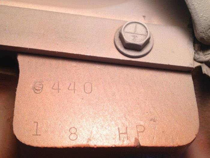

My ‘71 V code cuda, built 5/26/71, G 440 1 8 HP, block casting 7/30/69 with the vin on the pad...the G actually is super imposed over a F for 70...must’ve been already built for a ‘70 car awaiting install and never got used, then when my car was built and a motor was needed, G was stamped over F and vin was assigned, trans is good with vin also
