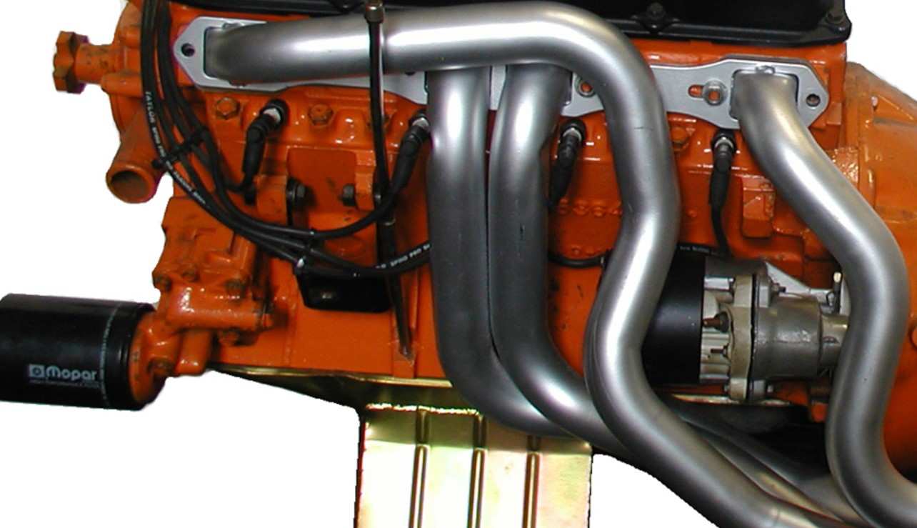

I am looking for pictures and details on 70 Cuda fitment for the TTI 1-7/8" 440 headers when using a Borgeson power steering box (Berman Auto Craft kit).
TTI does not guarantee fitment with the Borgeson and neither does Bergman but my Internet research is sketchy and says "tight fit" or "clearanced one tube". I am assuming that clearancing would be at the cylinder 3 tube. See picture from TTI's website below. I do not want to dent a brand new set of TTI headers so clearancing the steering box's body or a bolt head would be preferred.

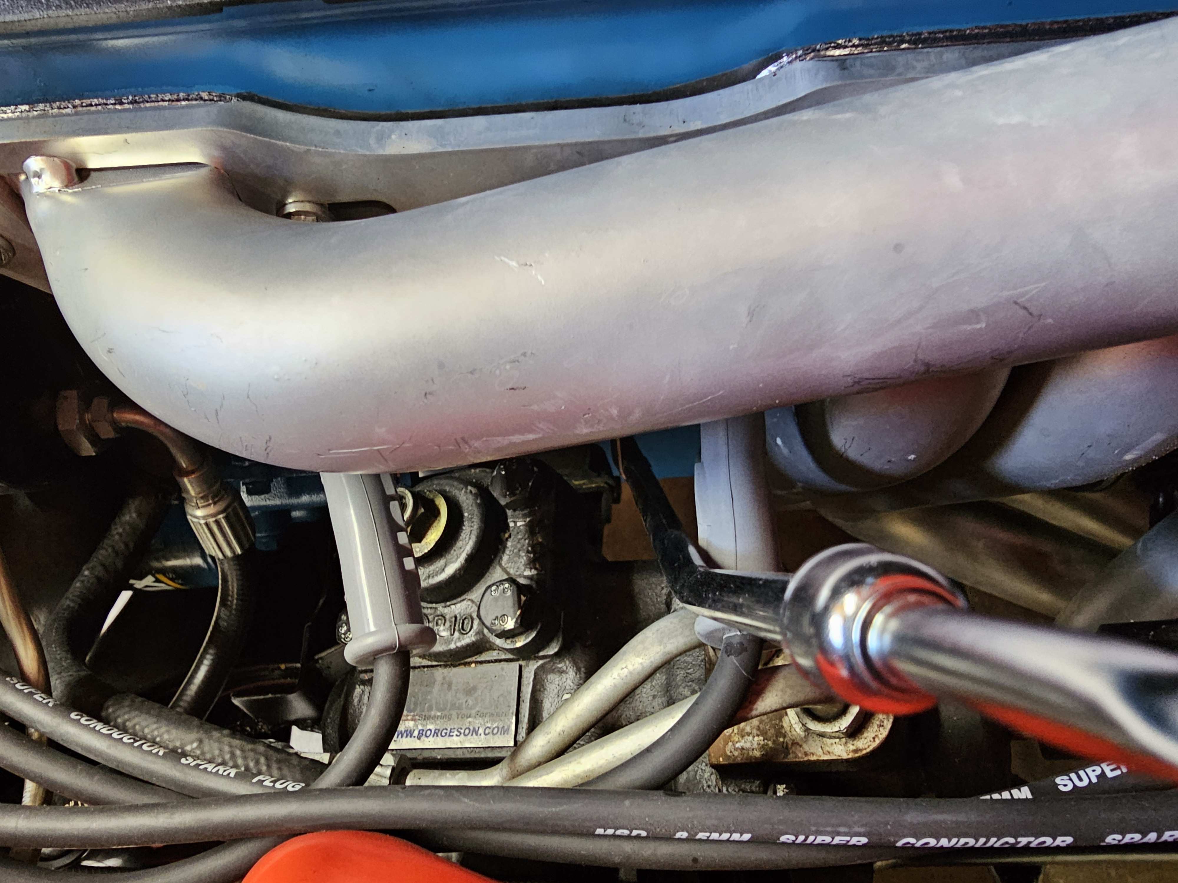

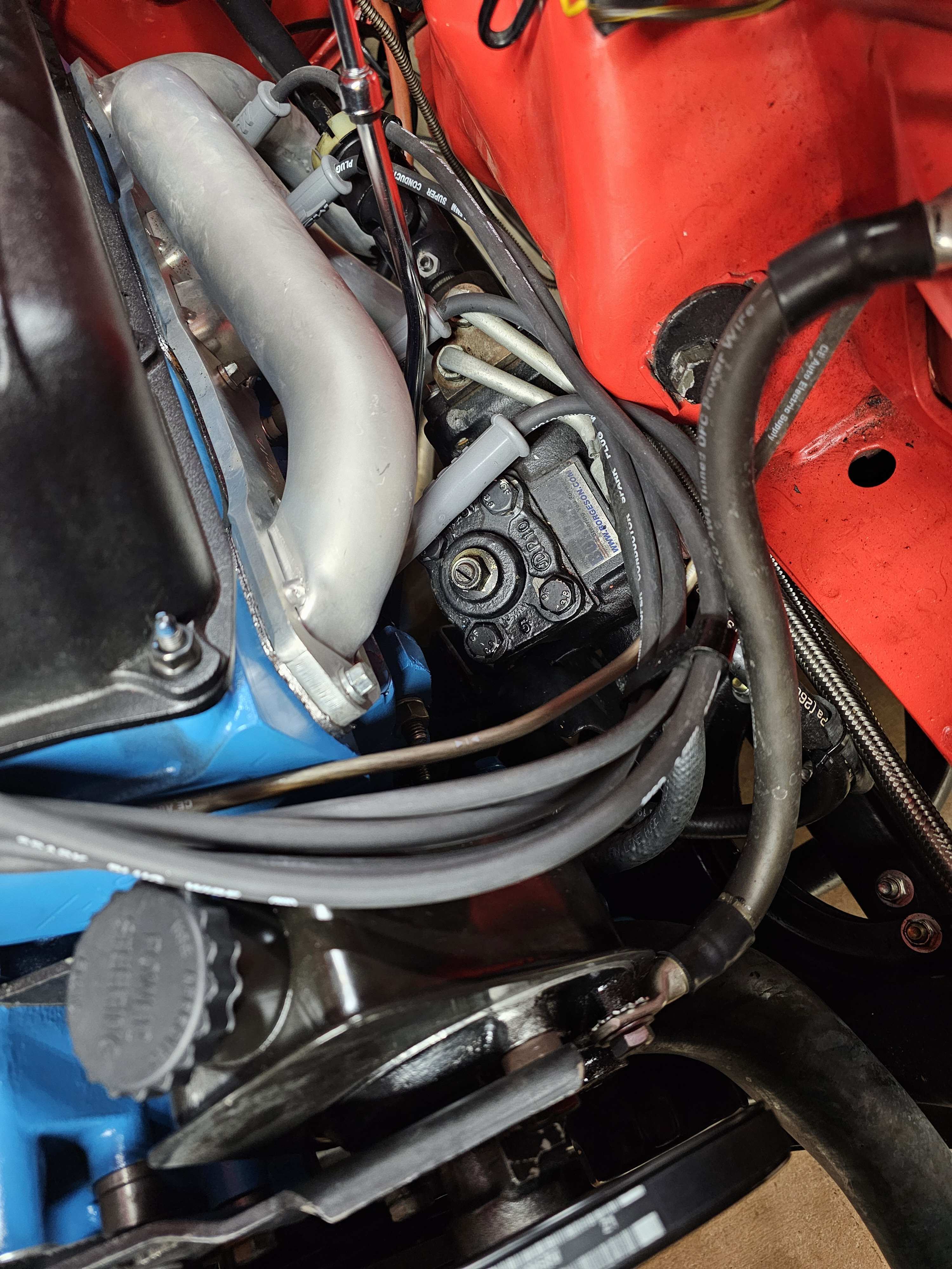

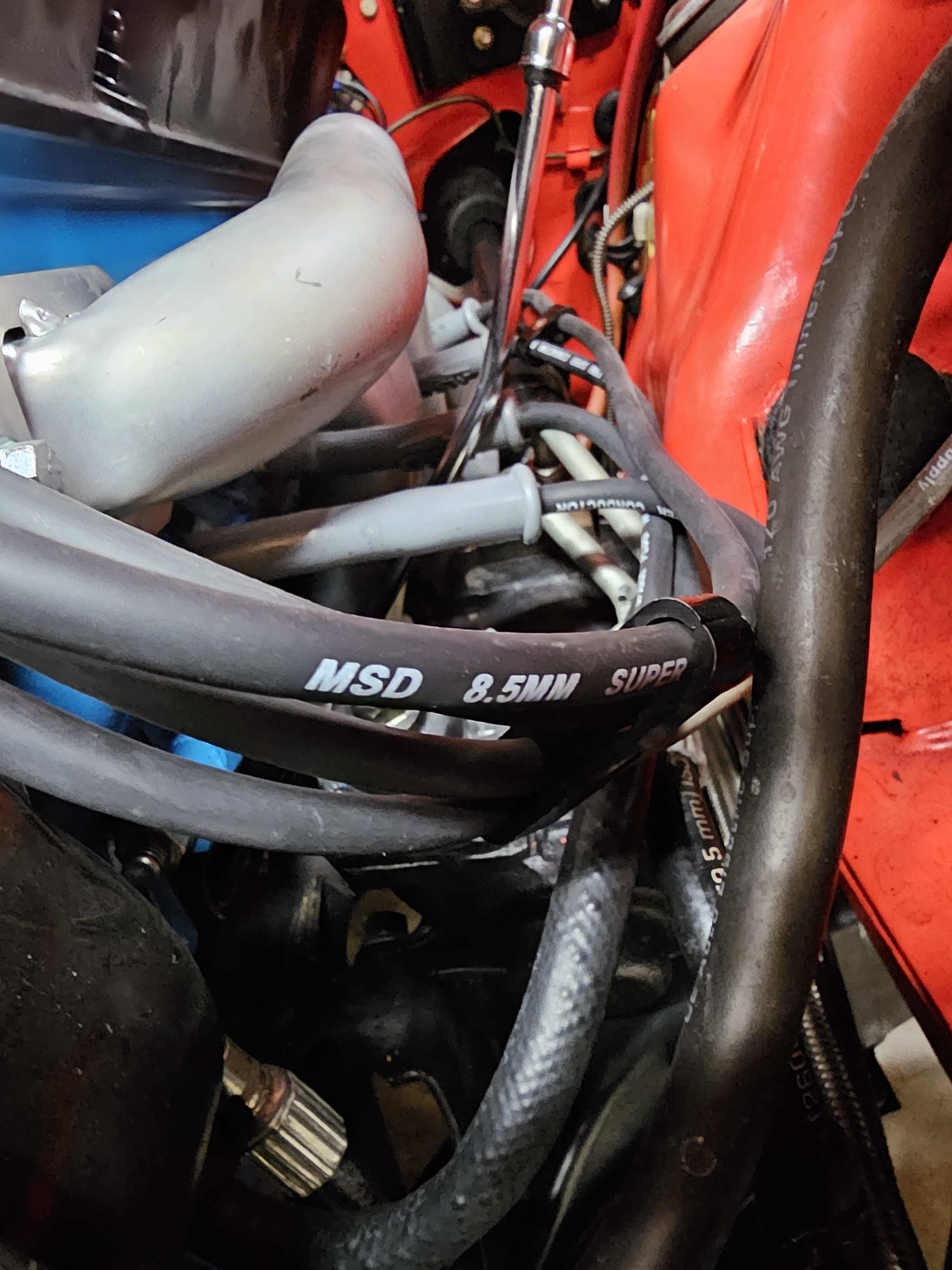

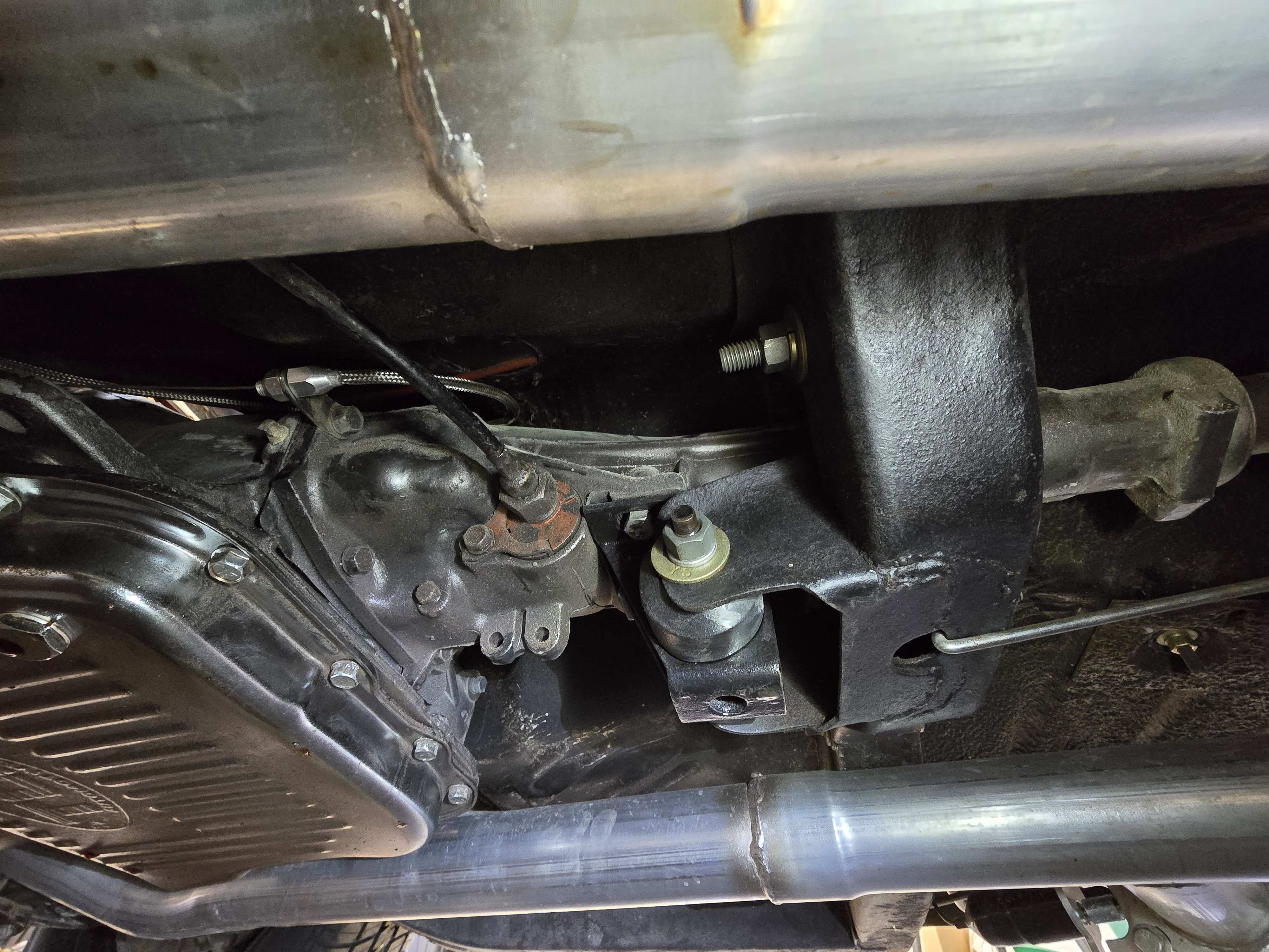

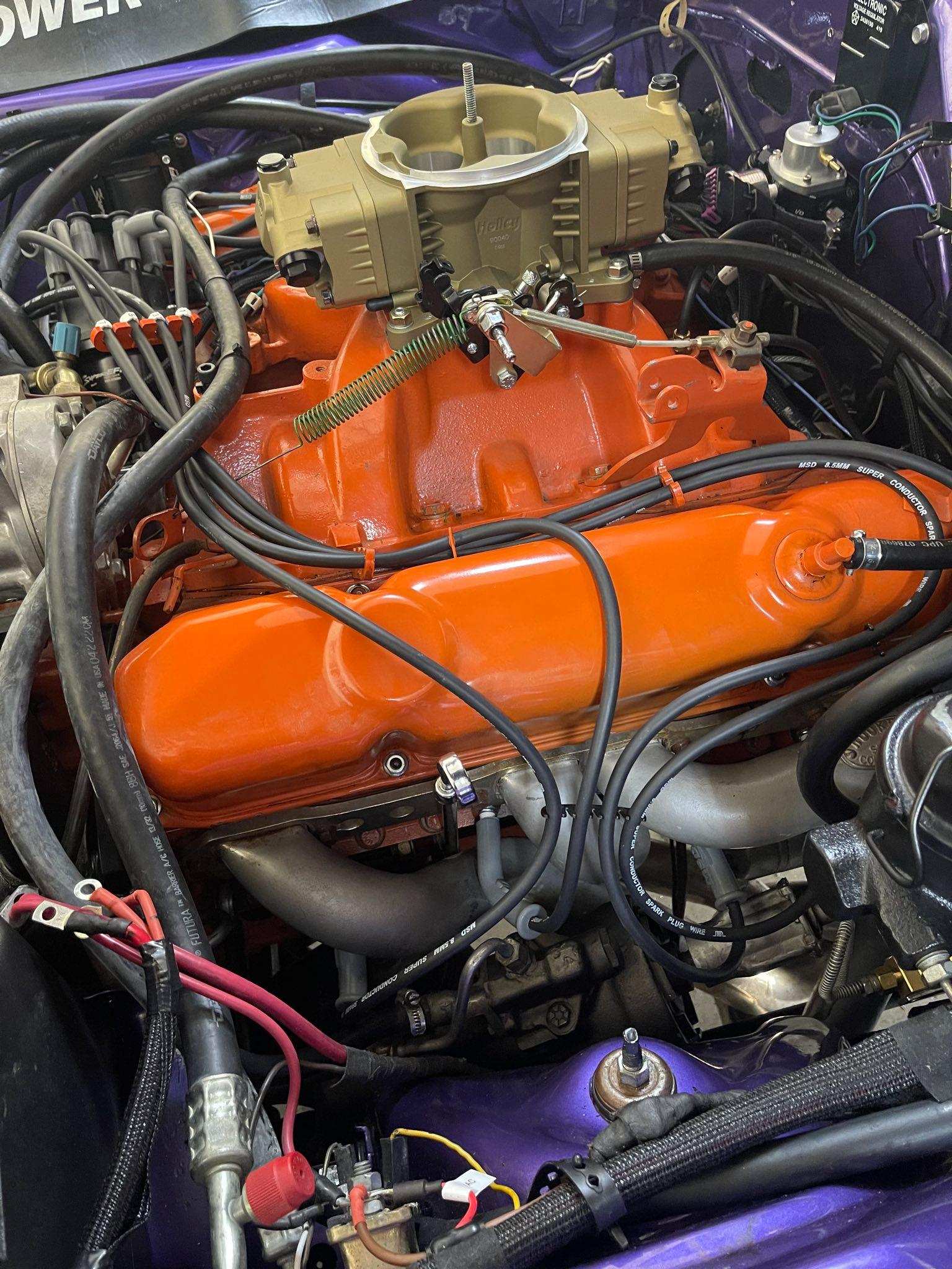

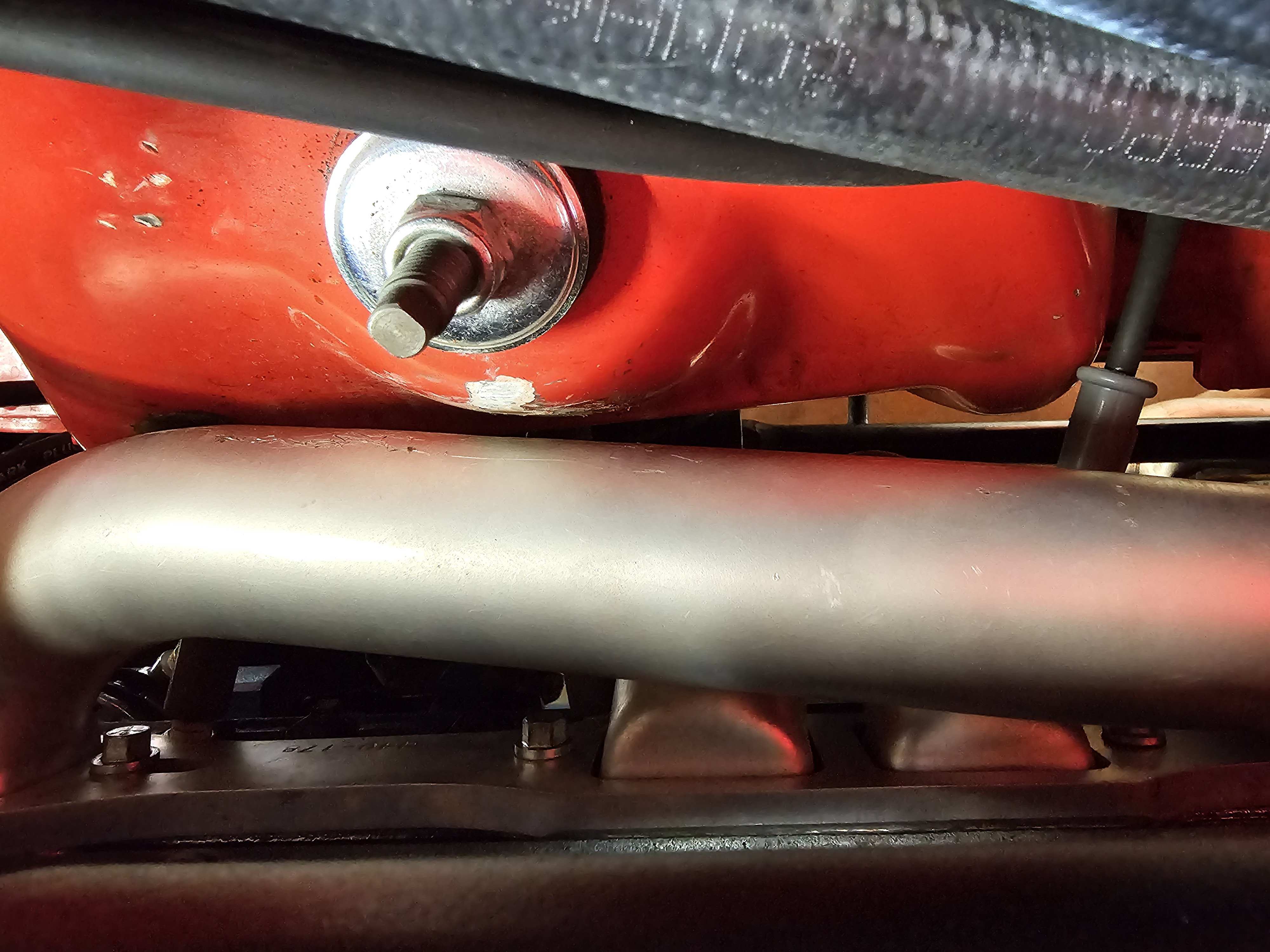

I am running those headers (TTI part number 440-178) on my 440 engine w/Trickflow 240 heads in a 72 Challenger. No clearance issues at all. The picture you provided from TTI shows a full size starter, which you will want to change to a mini-starter. I had no clearance issues even with upgrading the torsion bars to 1.03. I did not like the weak stock type "anchor" engine mounts so upgraded to the Dynatech mounts from 440source. The passenger side header is VERY close to the shock tower area but does clear. Just had to raise the car and raise each side of the engine to install. I am also using the Borgeson P/S unit and their Saginaw pump. Sorry, not the best pictures. Let me know if you need any other info.
Thanks for the quick responses. I am already running a ministarter and Hooker SuperComp 2" headers now with factory steering.

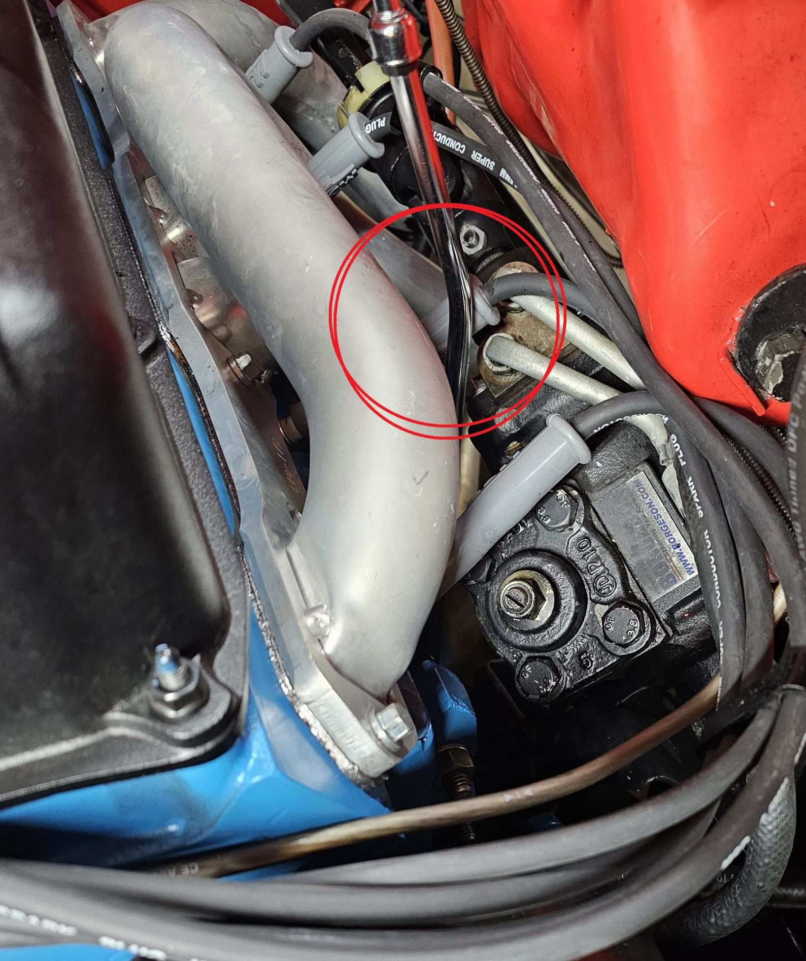

So is the clearance issue with Cylinder 3 on the Borgeson box? Can you snap a picture of the areas close to the Cylinder 3 & 5 tubes or other clearance areas that are tight?
On the driver side there are no really close clearances so you'll be good. Only on the passenger side (you'll see where I dinged the paint!). The dipstick tube in the photo looks close but it is not.

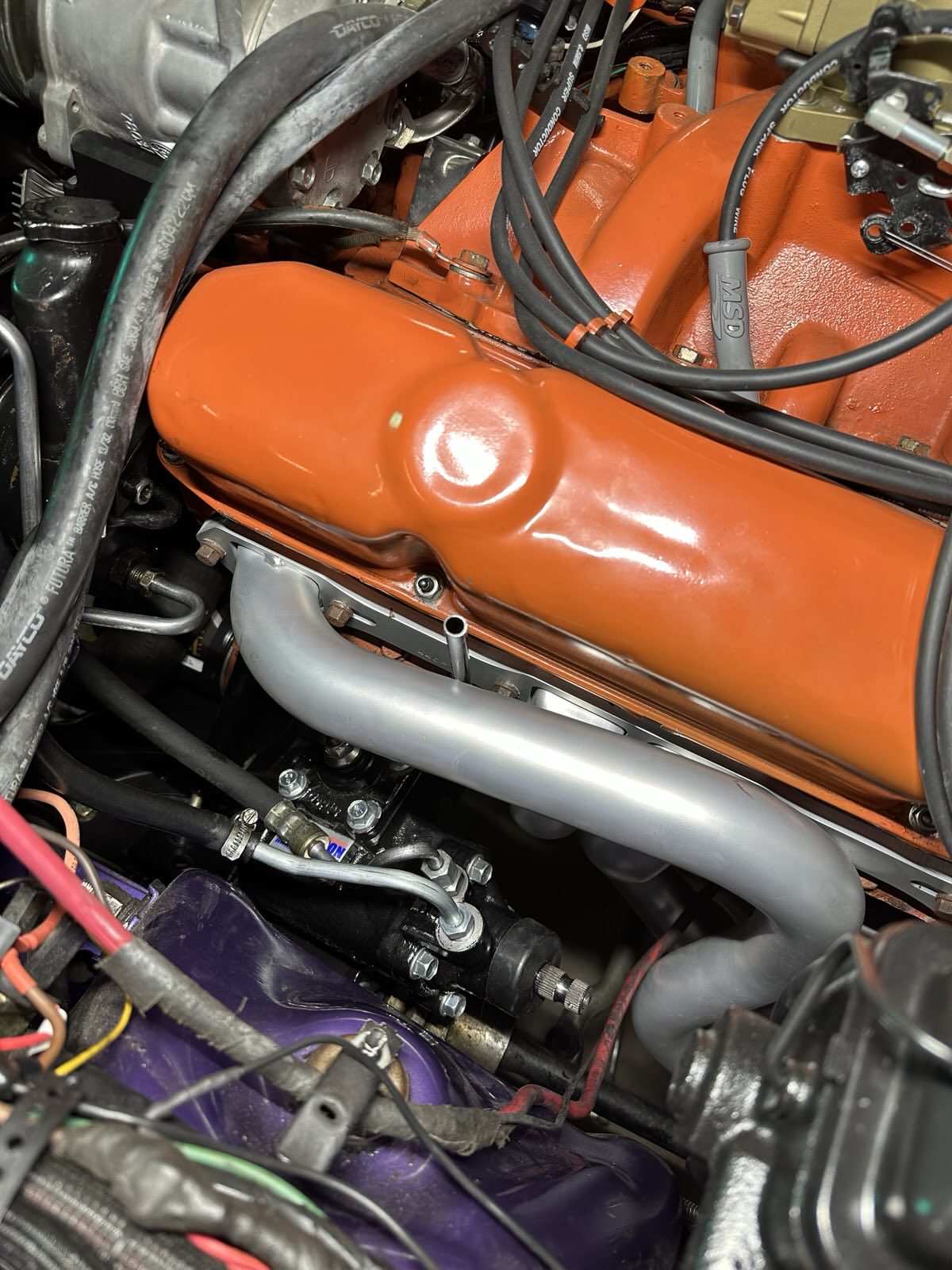

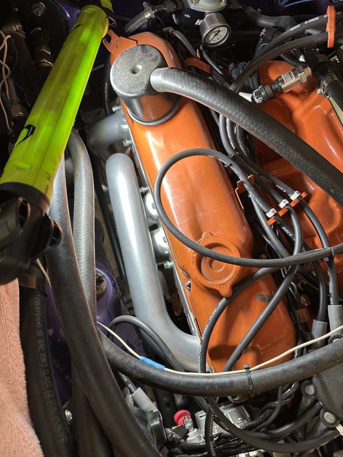

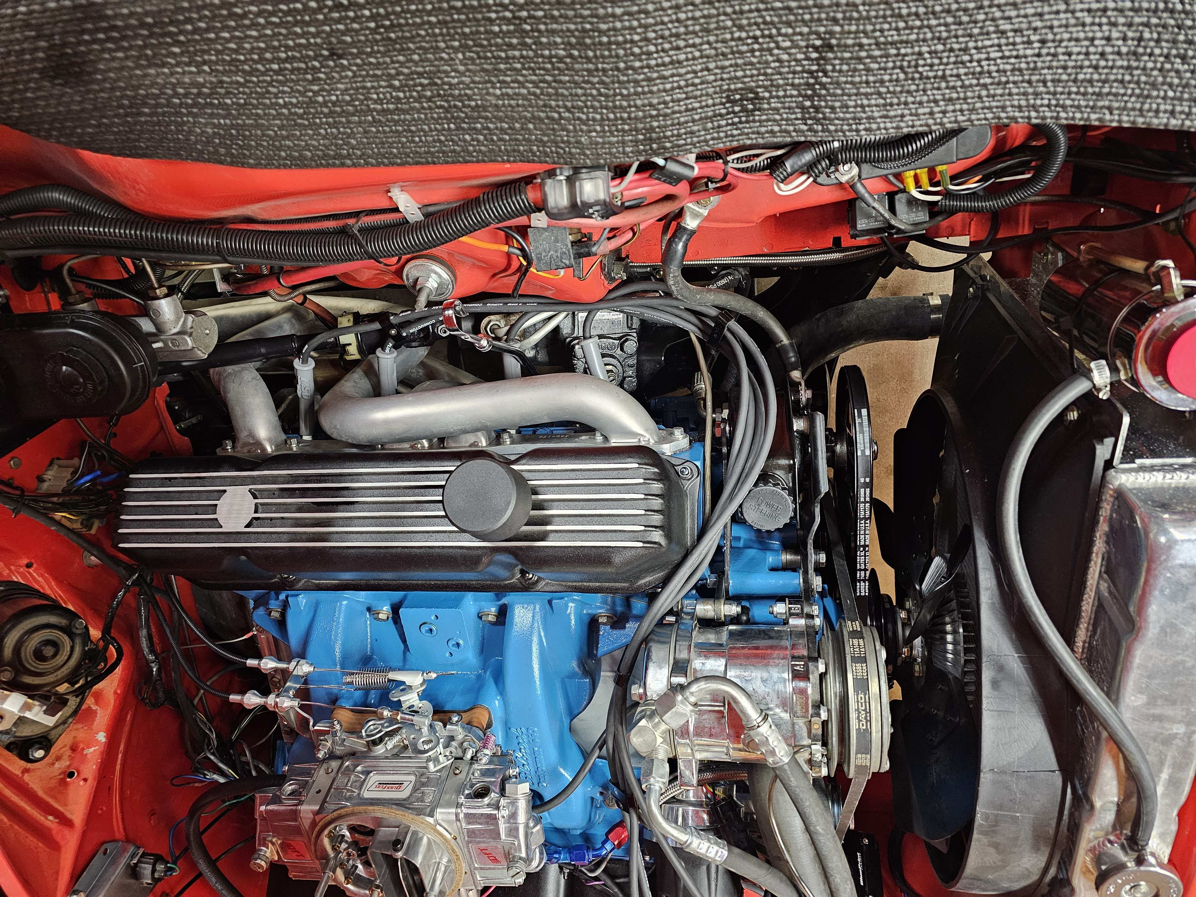

Current Hooker 5209 SuperComp headers and factory PS box. Holley Terminator X EFI...best modification ever to my Cuda.

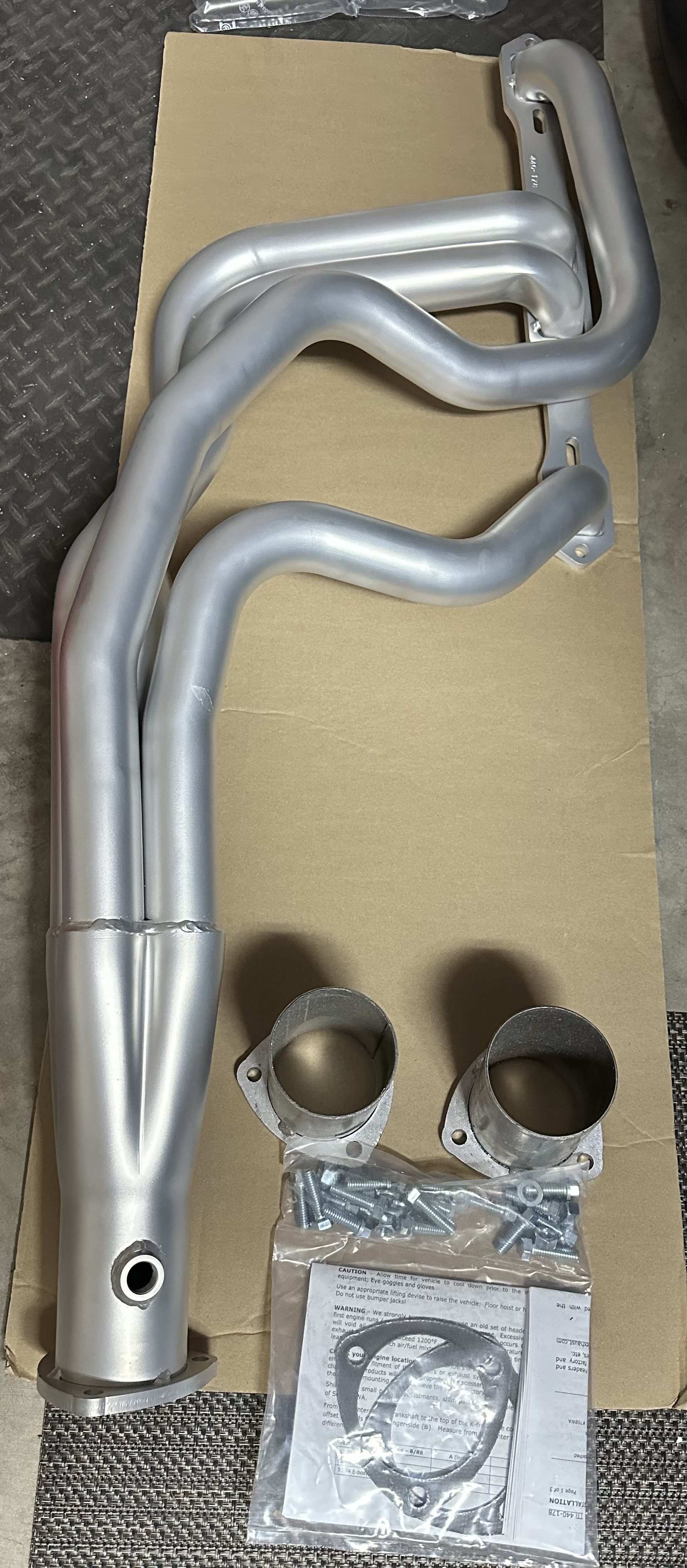

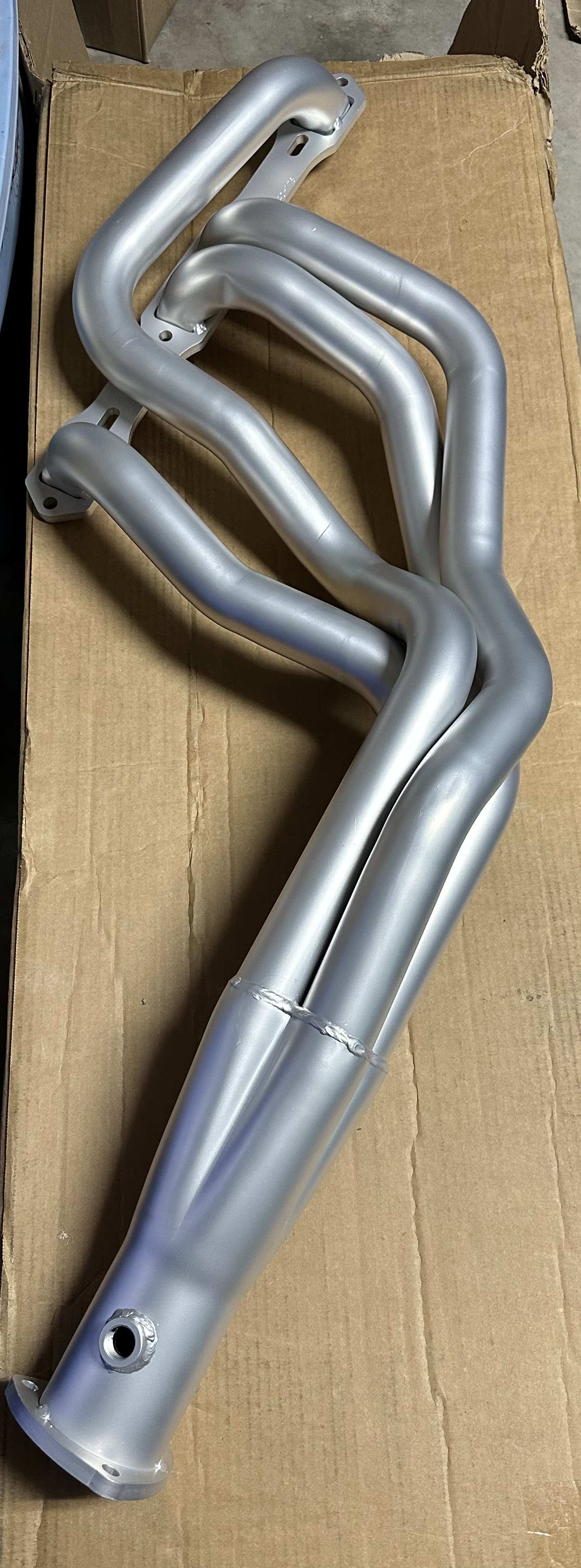

TTI 440-178C4 headers arrived on 11/29/2024. Barely over a week after the order. :oops:
This project includes an Auto-to-TKX 5-Speed conversion, Borgeson PS box, and a rear gear swap to 3.91's so it will be bit before the headers are installed. More pics later...

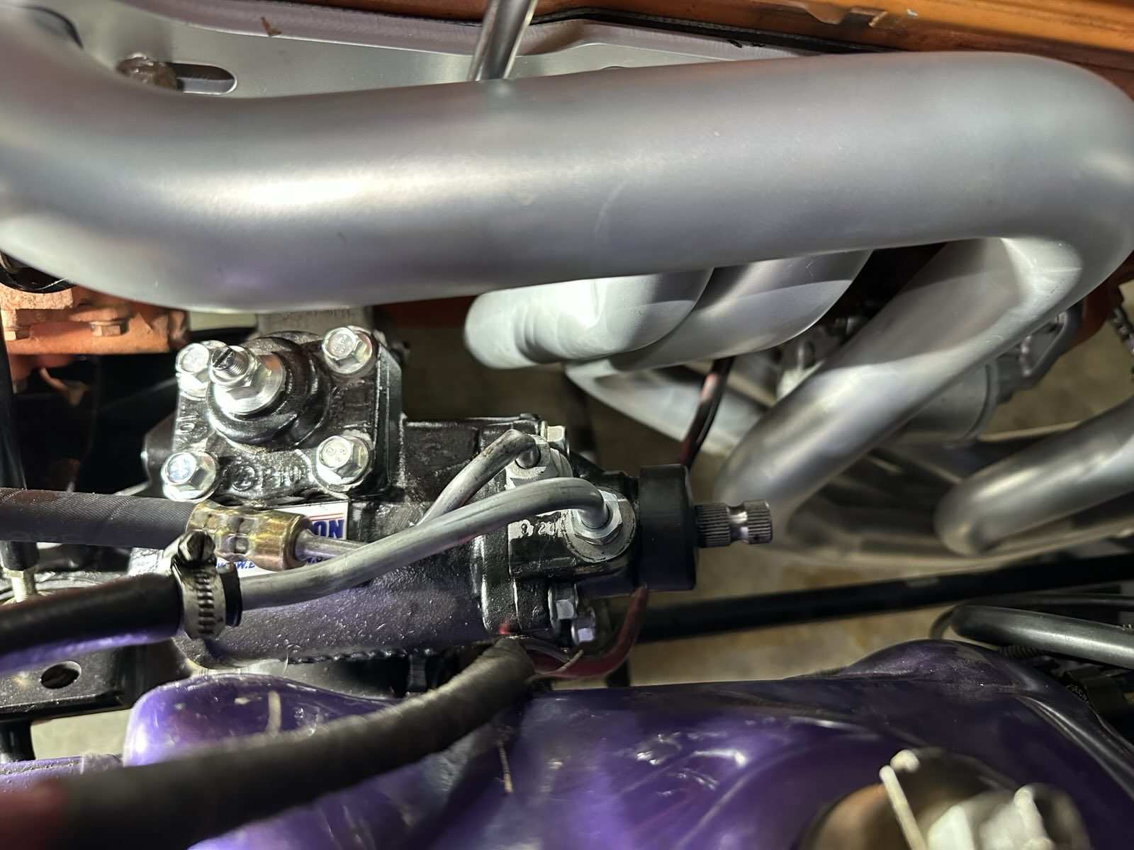

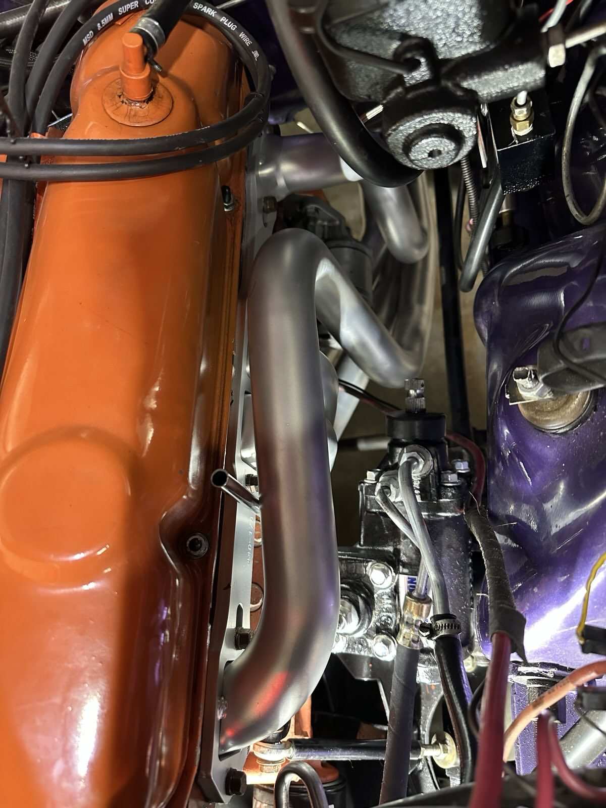

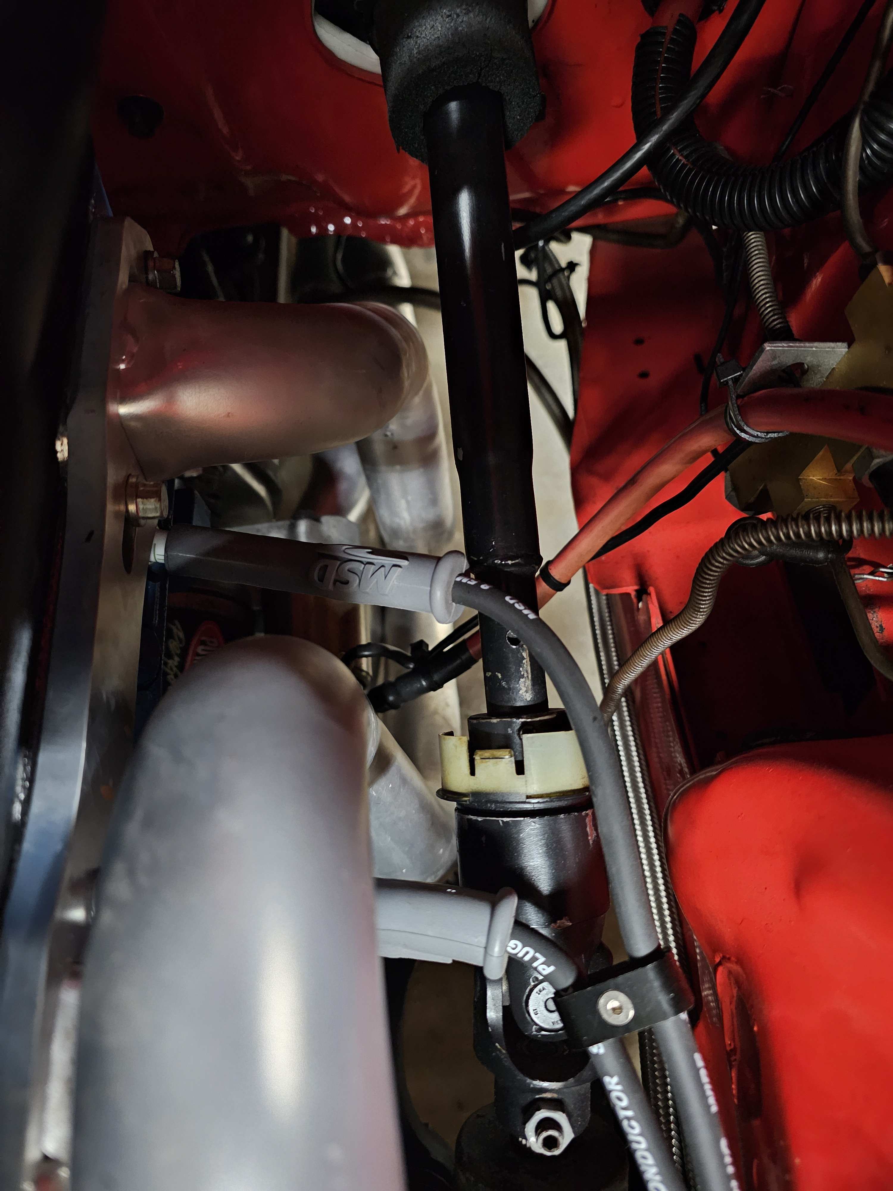

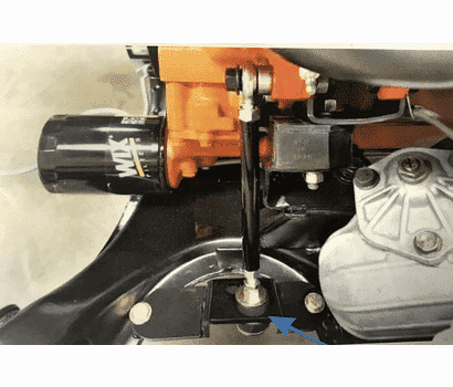

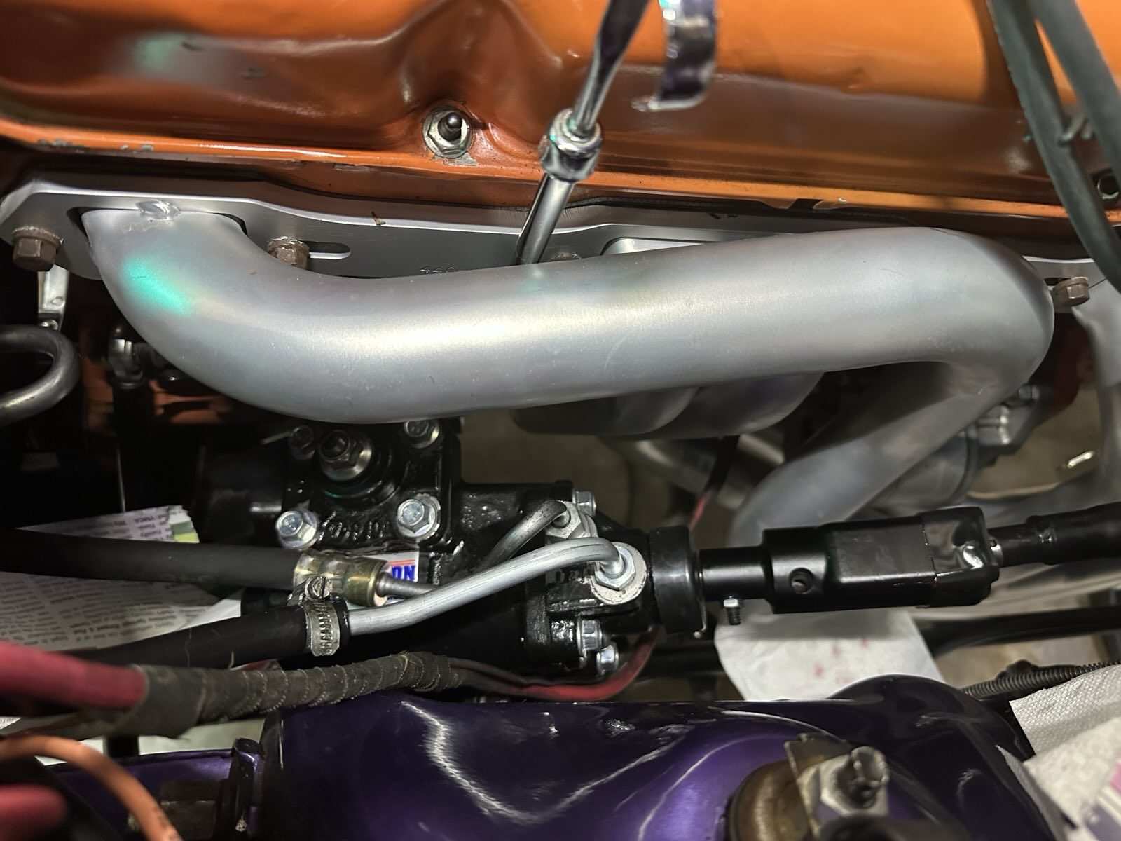

I installed the TTI 1-7/8" Big-Block headers. The headers were a breeze to install and the fitment is extraordinary. The Borgeson power steering box from Bergman Auto Craft has plenty of clearance to the header tubes. Again, TTI has the BEST headers for Big-Block E-Bodies!!!
FYI - These are Indy EZ Cylinder Heads with stock exhaust port locations. The the TTI-supplied 1" length header bolts were bottoming out in the Indy heads so I had to use shorter (3/4" length) header bolts.

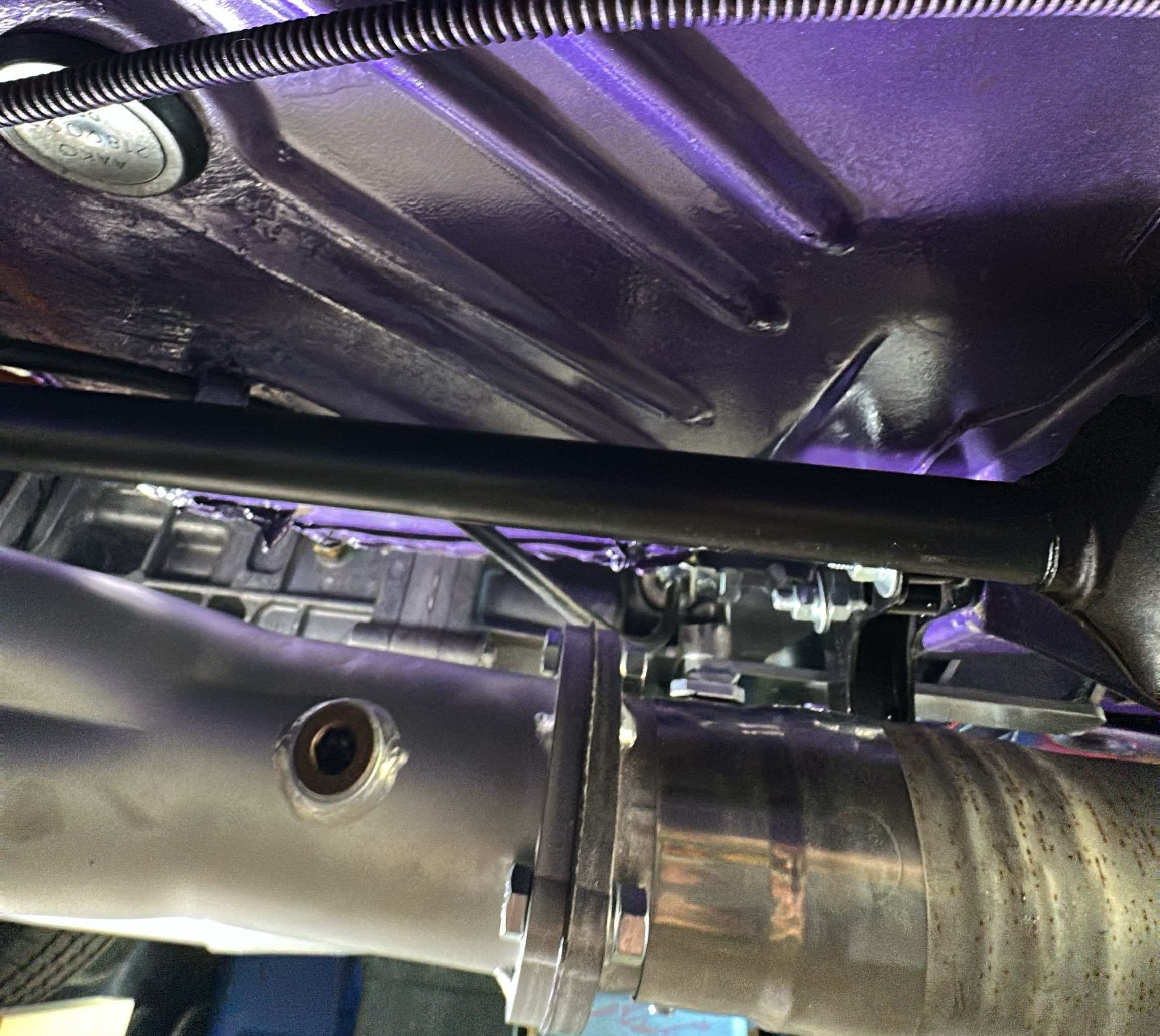

Thanks for the photos. I just spent some time under mind a couple hours ago trying to figure out where exactly those headers end. It looks like just behind the speedometer cable, a few inches in front of the cross member. I'll have to cut some exhaust out and make them fit, since I've currently try got Hedmann shortys, and it looks like I'll be able to keep the cutouts I've got in the same place they are now...hopefully.
From my not very precise measuring, the current exhaust weld is about where the TTI end so I should be good without moving the cutouts.

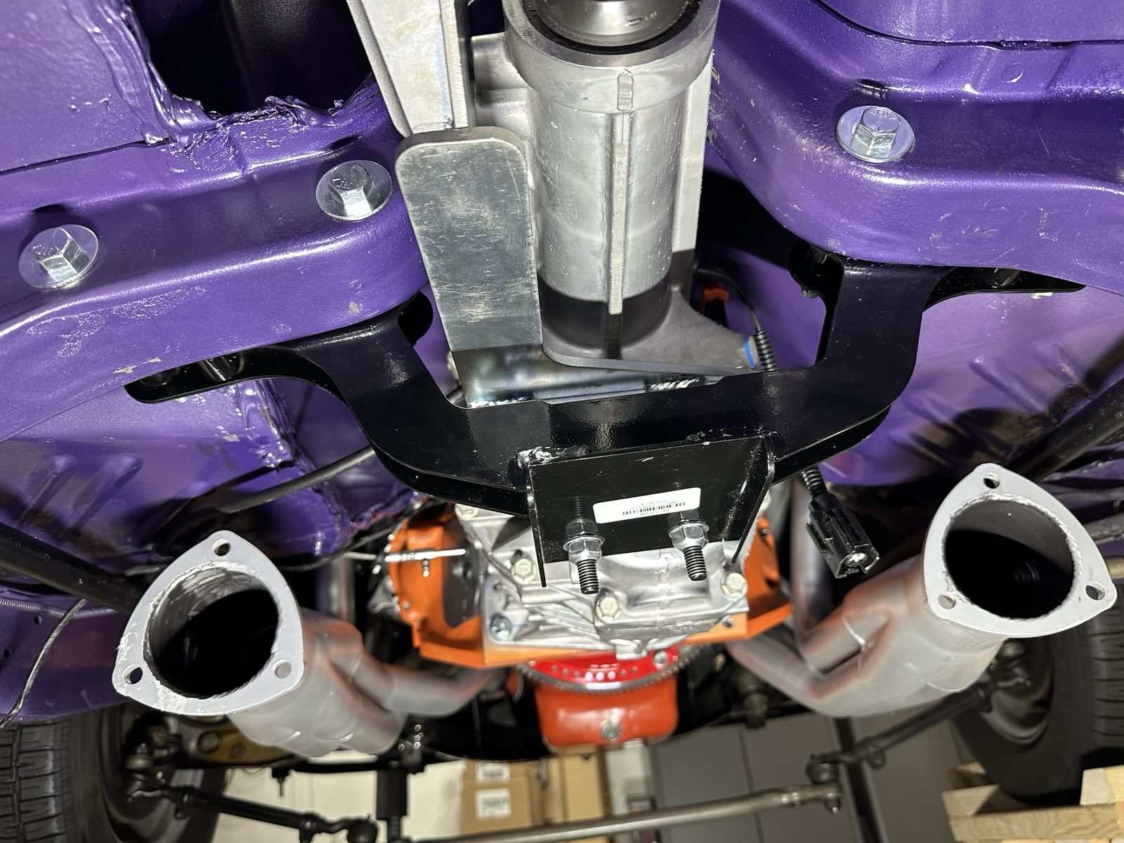

I can take a better picture from the side for you but here is a picture showing the end of the TTI collectors at the Silver Sport Transmission TKX crossmember area.
Your exhaust pipe picture looks pretty close to the right location to work with the TTI adapters.
That picture shows pretty much exactly where I was thinking they'd be. Thanks!
I bet it'll be no proble at all to fit them to my current exhaust. I'll find out soon, engine is just about ready to pick up from the machine shop and then I need to do assembly, paint my engine bay, and stick it in.

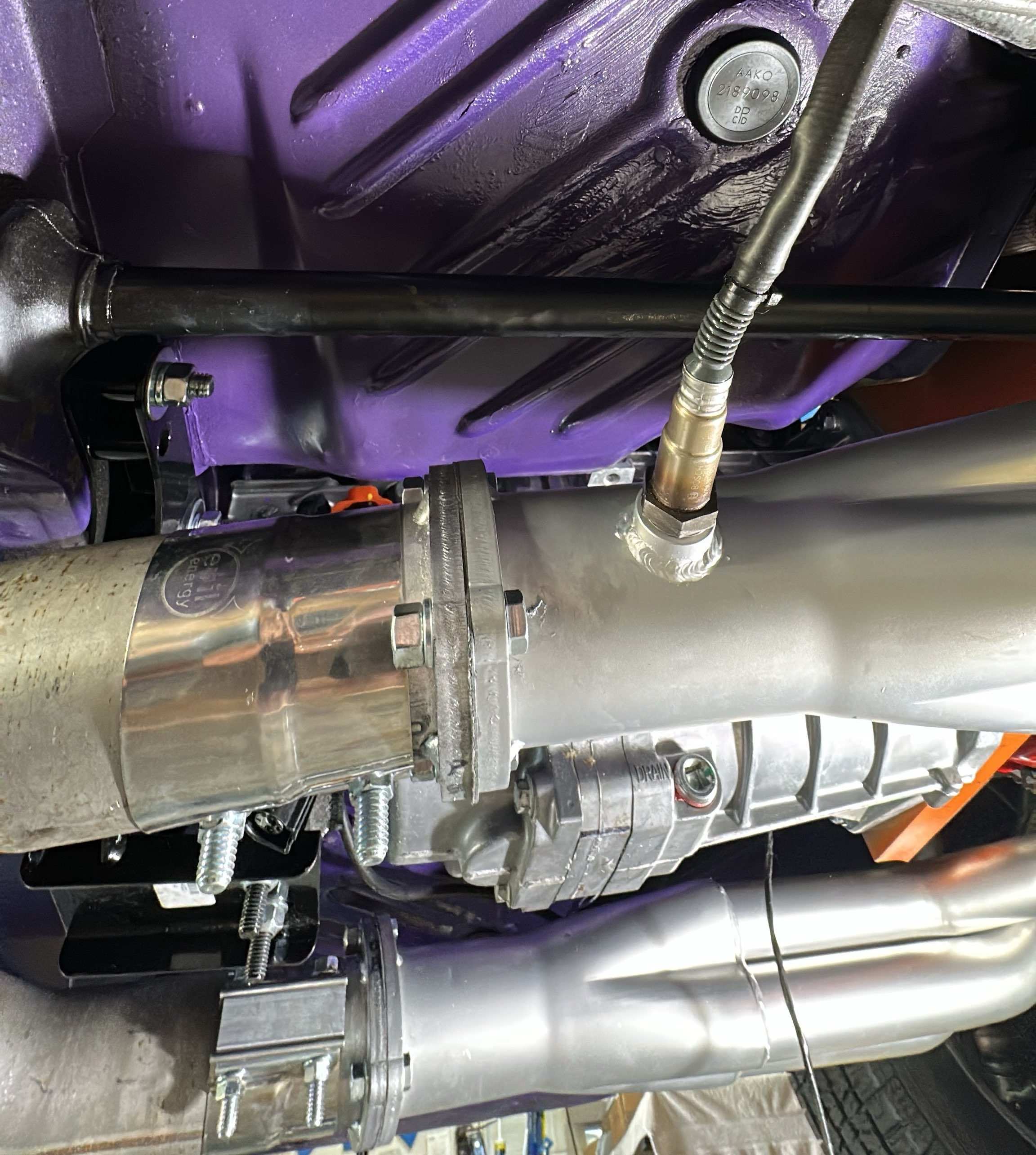

Here are some better shots of the TTI 1-7/8" headers' collector flanges in relation to the floorpan and crossmember. I just finished reinstalling the midpipes for my TKX 5-Speed project.
Final result with plenty of clearance to PS box and steering column.
