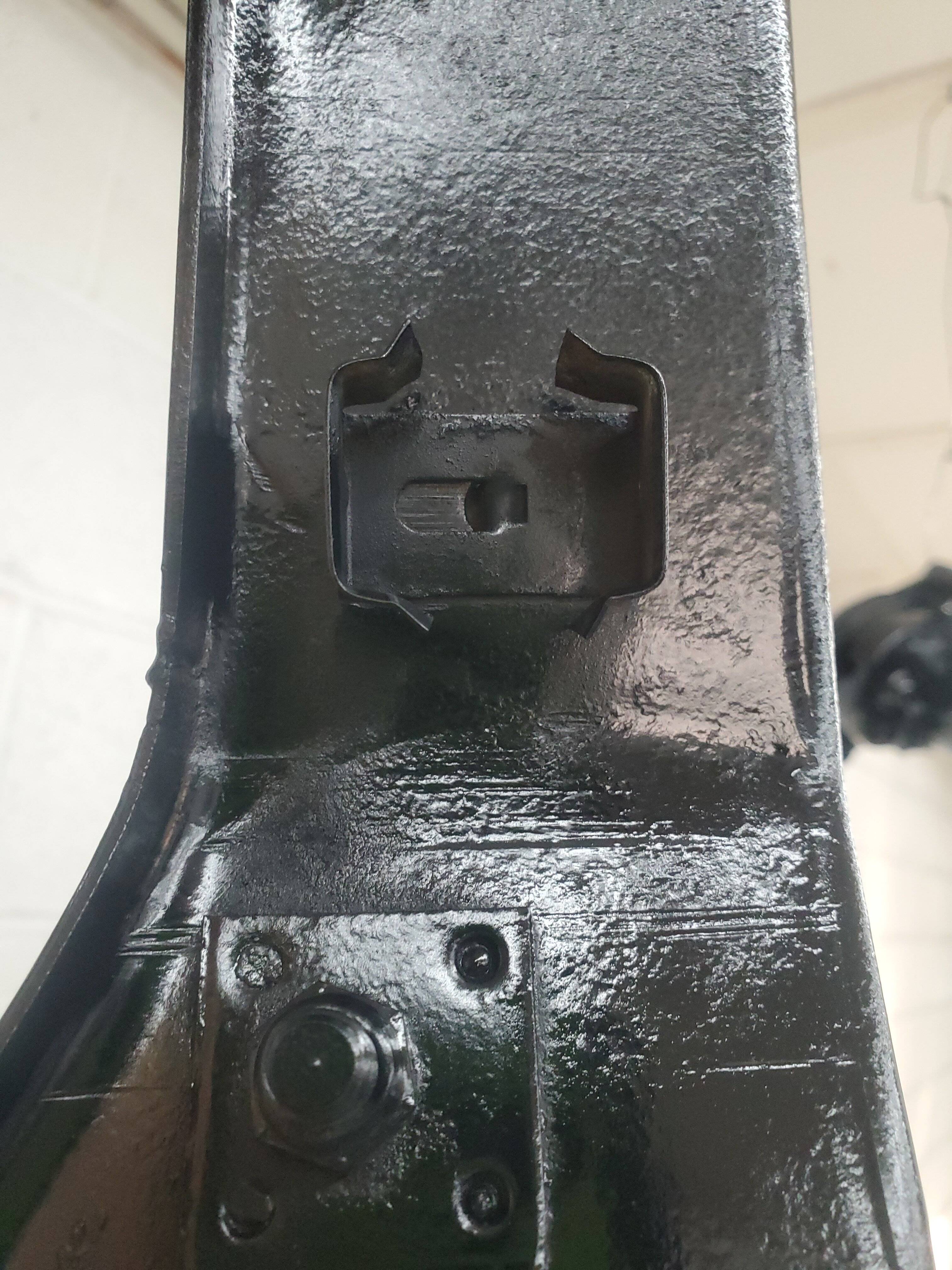

Need help identifying what goes here?
MyR/T
Mar 22, 2018
79
25
Hey guys I'm working on a 1970 challenger 4 speed car. On the side of the clutch/brake pedal assembly is this bracket. Does anyone know what goes in it? As always I appreciate any help. Thanks.

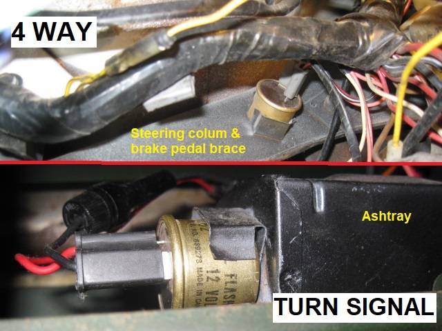

For the flasher canister, there is also one on the side of the ash tray. One is for the turn signals and one for the 4 way flashers. I can't remember which one is which though.
