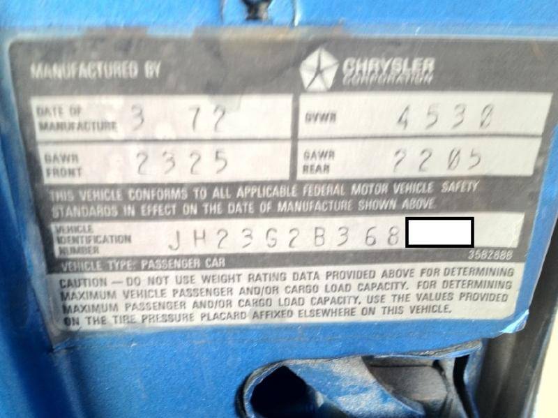

Just happen to have a 1972 318 Challenger in the archives. If you need a better copy, just send me a PM.

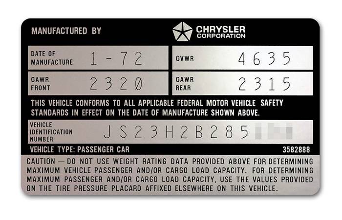

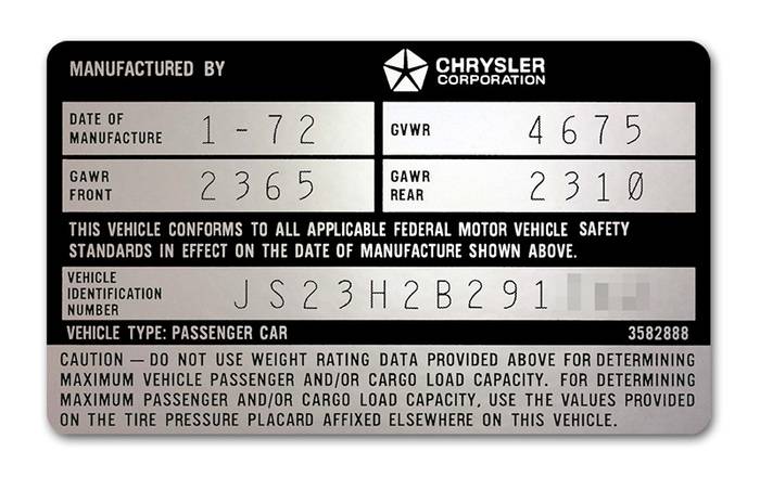

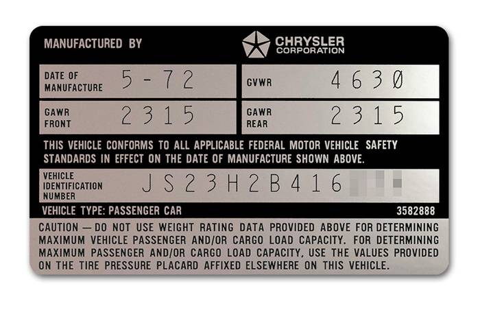

We have every Chrysler VIN template setup from 1969 to present day. We never require the Customer to send us a picture of their VIN to see the format or layout. A copy serves as documentation (required by Chrysler) and it also provides valid vehicle information. Weights are specific to each car. Most people don't know that the weight specifications can ONLY be found on the VIN sticker. (This applies to 1972 models and later.) They cannot be found on the Broadcast Sheet, the Fender Tag or the Monroney Label. A car having the same power-train did not guarantee that the GVWR total (as well as Front & Rear weights) would have been the same.
Below are 3 Chrysler VIN decals from 1972. These are actual Chrysler VIN decals that we reproduced for different Customers. All of them represent the exact same model, year and have the same engines. Notice the differences in the weight specifications. I could have pulled 10 more random examples and they too may have exhibited different weight specifications. The combinations of weights are almost infinite depending on the option combinations that could have been ordered. In 1973 they started using MDH numbers on the VIN decal which makes this information even more unique to a particular vehicle.
