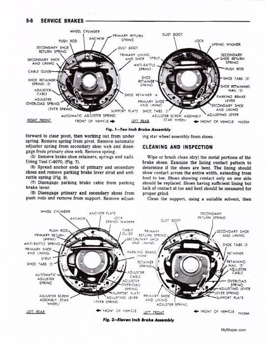

I took apart the front drum brakes on my 1972 Challenger Rallye before winter, and now that it's time to put them back together, I forget how they are supposed to look when reassembled.
Can anyone provide a few photos for me of what their front drum brake looks like so I can compare mine to it?

You need a factory service manual now don’t you. I’m sure there’s a google image of the very thing you need, just ask it.
5,177
2,707
Front drum brakes Mopar

The picture is a 1969 and older, the self adjust parts are different that your 1972. The manual is the 1970 and newer self adjust parts.

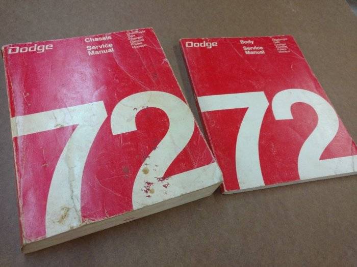

I have an original factory service manual set, both books for ‘72 Dodge if you’re into hard copies. $65 + shipping.
