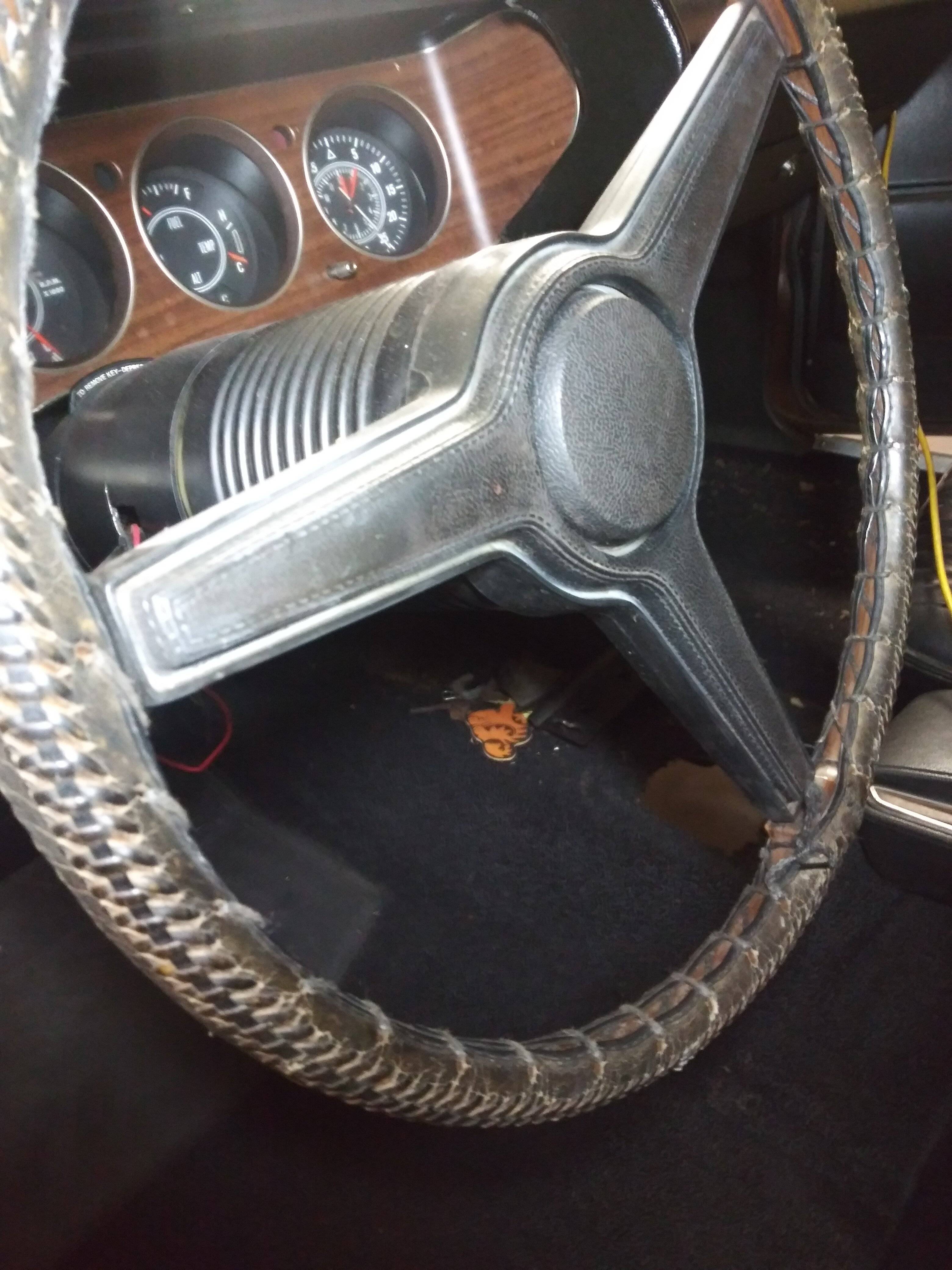

Nov 12, 2020 #1 MerlinsMopars Well-Known Member Joined Dec 16, 2019 Messages 291 Reaction score 105 Is this steering wheel wrapped from the factory or was it just added at some point? Looks like wood under it.
Nov 12, 2020 #2 C Chryco Psycho Well-Known Member Joined Dec 28, 2008 Messages 4,402 Reaction score 2,043 Location Panama it was done after it left the factory , probably too cold on the fingers !
Nov 13, 2020 #3 70chall440 Well-Known Member Joined Dec 11, 2010 Messages 1,260 Reaction score 975 Location Western Washington Its not wood under there, its wood grain or perhaps better said plastic made to look like wood. Those wraps were very common back in the 70s and 80s. That is actually one of the better ones I have seen.

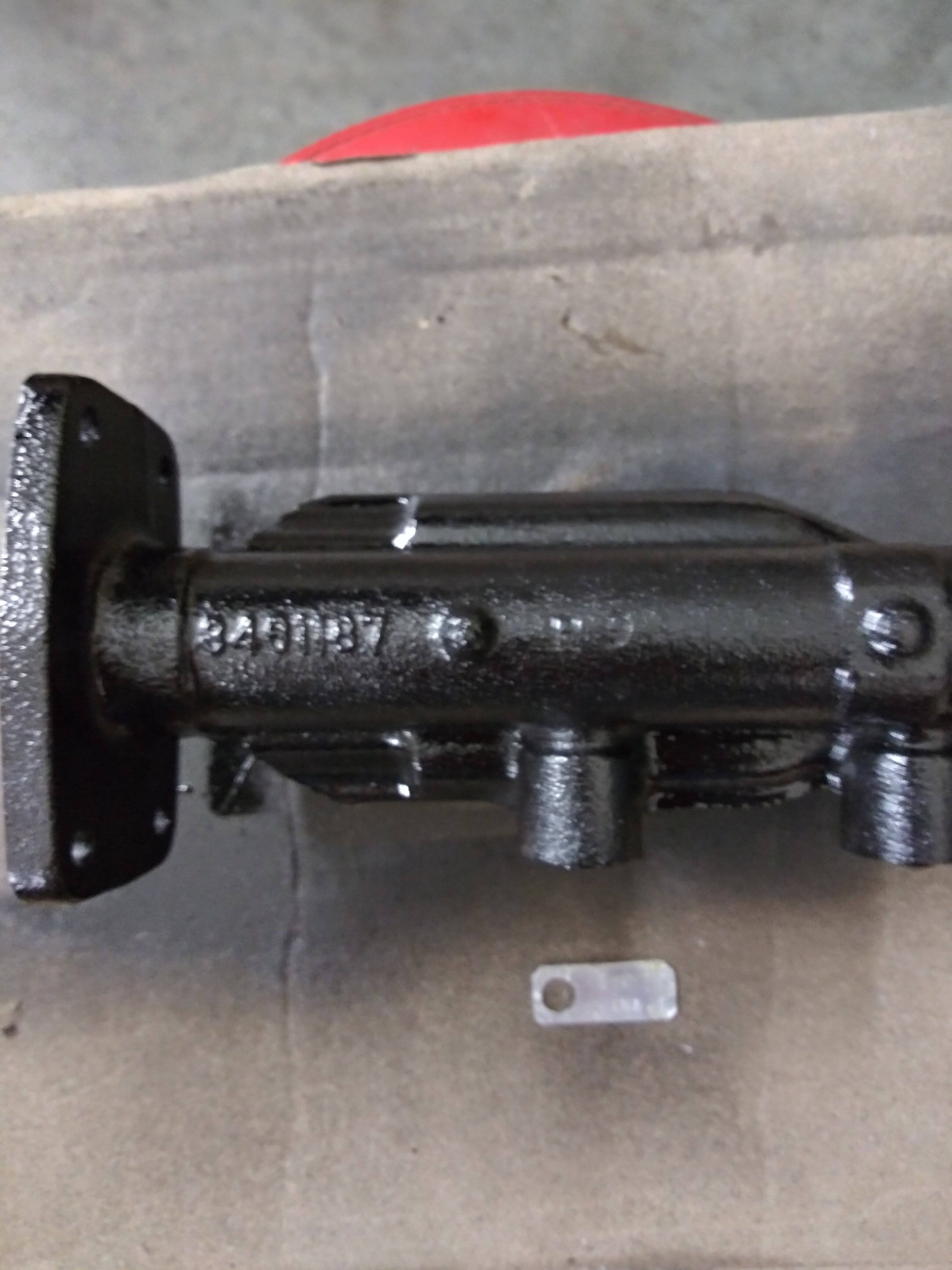

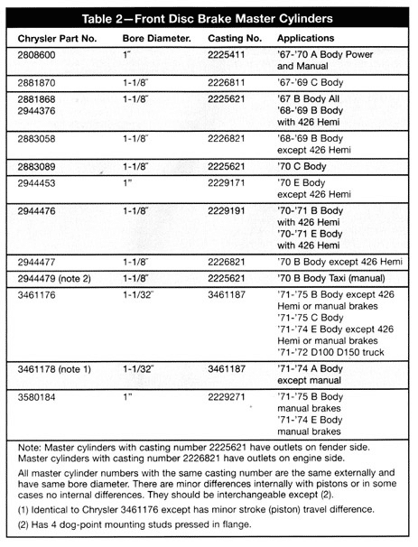

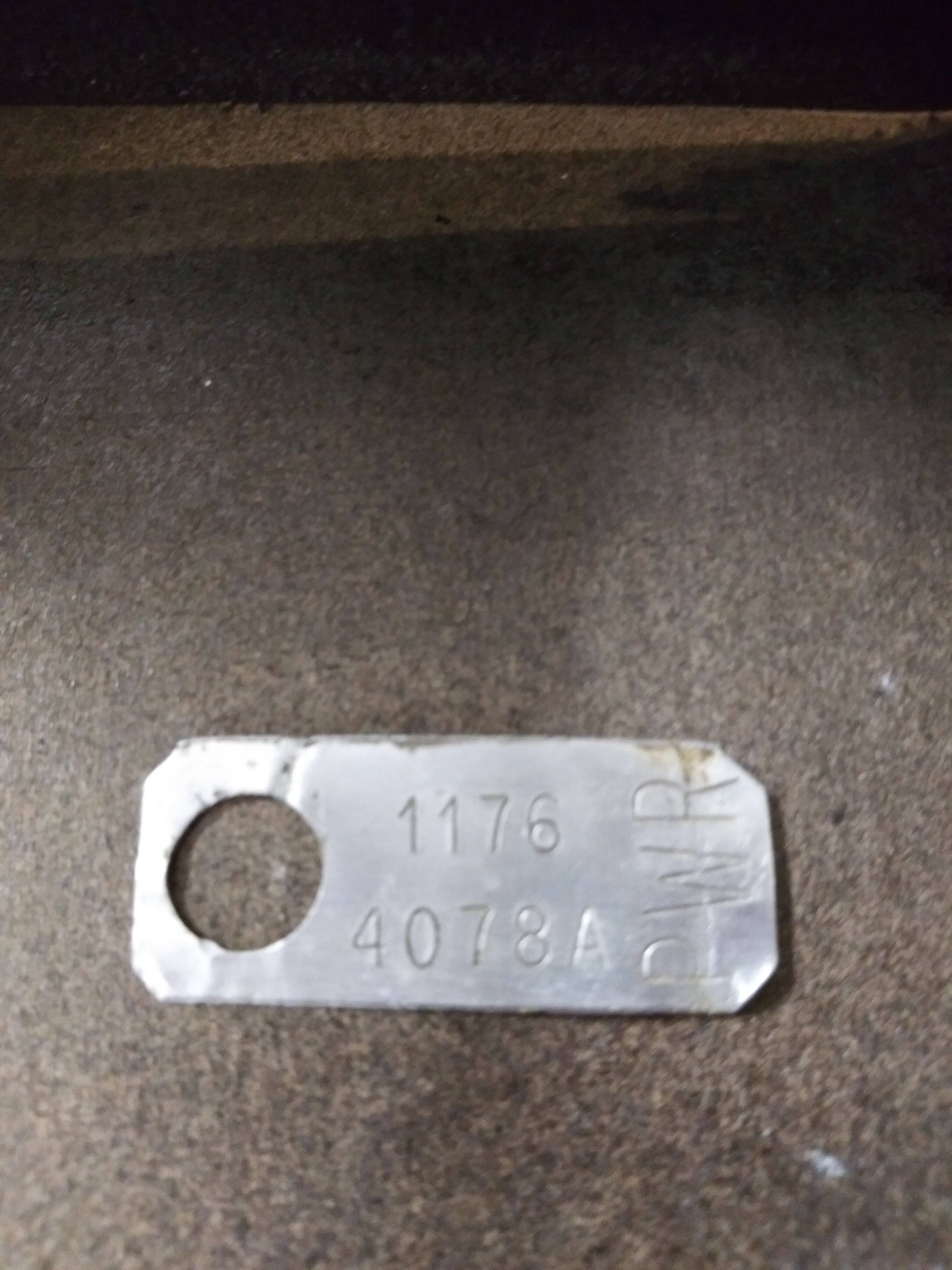

Nov 14, 2020 #4 MerlinsMopars Well-Known Member Joined Dec 16, 2019 Messages 291 Reaction score 105 I am re using this brake master cylinder and there was this tag on it. Would this possibility be the oem part?
Nov 14, 2020 #5 340challconvert Well-Known Member Joined Feb 13, 2011 Messages 5,177 Reaction score 2,707 Location Parsippany, NJ This may help; a chart of Mopar masters (disc brake chart) drum brakes are different numbers
Nov 16, 2020 #6 6PKRTSE Well-Known Member Joined Feb 3, 2010 Messages 777 Reaction score 367 Same woodgrain wheel that is in my car except with an aftermarket wrap around it. As mentioned someone did do a nice job with wrapping it though.
