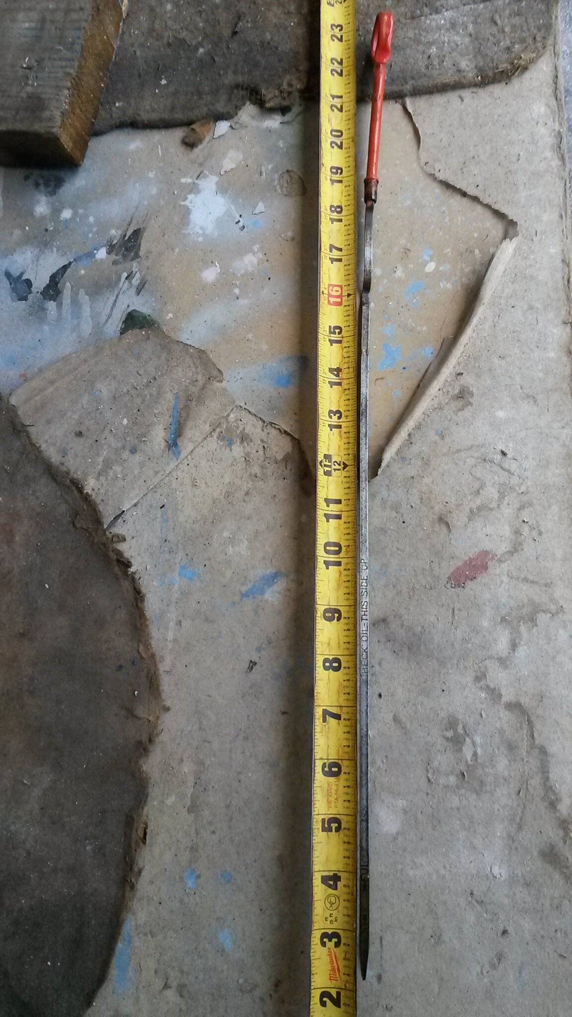

Aug 12, 2022 #1 VillaTA Well-Known Member Joined Aug 18, 2021 Messages 178 Reaction score 43 Location Cincinnati I’m noticing that I can feel my dipstick hitting bottom with a couple inches sticking out at the top . Are there any shorter ones available?
Aug 12, 2022 #2 Rapidfire Well-Known Member Joined Aug 7, 2019 Messages 1,086 Reaction score 740 Location Culbertson Nebraska Just cut (shorten) yours to the correct length.
Aug 12, 2022 #3 C Chryco Psycho Well-Known Member Joined Dec 28, 2008 Messages 4,441 Reaction score 2,080 Location Panama I agree add , 5 qts of oil start the engine & mark the dipstick where the oil level is at .
Aug 13, 2022 #4 Challenger RTA Well-Known Member Joined Oct 28, 2018 Messages 2,647 Reaction score 1,308 Location PA Flood city 340 right? original dip stick.16 3/4 to stop. pull out cut handle end put back in. If you have marks already on it.
Aug 13, 2022 #5 C Chryco Psycho Well-Known Member Joined Dec 28, 2008 Messages 4,441 Reaction score 2,080 Location Panama This is assuming the tube length is correct , they are not all the same .
