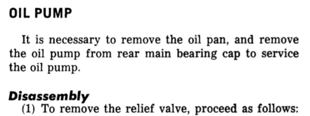

I referenced the service manual and found this image. Just to be very clear, the bolts holding the pump in can be undone and the pump can be dropped while everything else stays in, right? And then when re-installing, I just need to make sure the hex lines up with the shaft? The manual then says tighten to 30 ft-lbs.
Thanks again for walking me through this. This is my first time seeing the bottom end in person so I am trying to be extra careful!

Thats correct. The shaft is 5/16 hex so its easy to engage the pump to the drive, make sure the pump is flush to the main cap when tightening the bolts.
I've been a mechanic since 1974 and I've never seen that piece come loose from a oil pan before, I guess there's a first time for everything!
