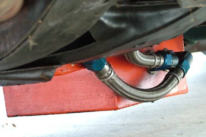

    I use the Milodon dual line swivel pickup in an 8 qt oil pan that I fabricated myself. Use a high volume pump with it. Melling # M-63HV (high volume) oil pump is very good and way cheaper than a Milodon pump. Use the Milodon bronze gear type oil pump drive. An oil cooler is not needed. I used to run this in NHRA Super Stock.
