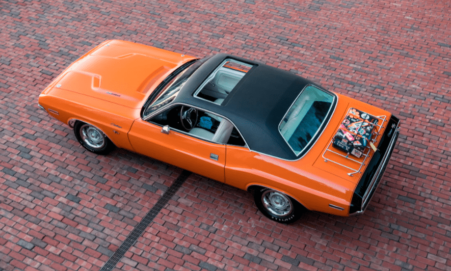

Black, like this H6XW EK2 Hemi Challenger. Would be correct and look best.
White would give you glare and any other color would not look right. Just my 2¢
