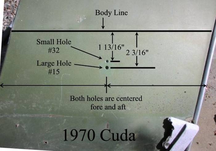

    does anyone have correct measurements or diagram for location of pentastar on right fender. 70 cuda with gill lower rockers if it matters. Looks like most pics I see are centered between wheel opening and door, but seems like more variation in vertical placement between rocker and body line above.
    Also, what determines if silver or gold?

    I found a good photo showing mounting holes and measurements on board.moparts.org but still no definitive answer on color.

    Found this from Detroit Muscle

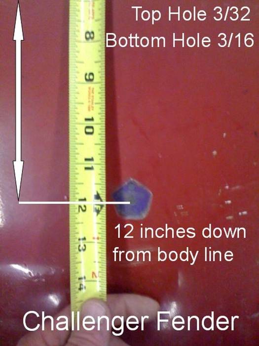

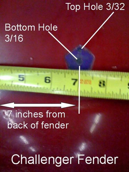

  5. 340challconvert
    Messages:
    3,451
    Likes Received:
    1924
    Joined:
    Feb 13, 2011
    Location:
    Parsippany, NJ
    Here's the measurements for a Challenger for comparison
