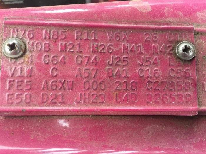

    What exactly do you have ? Year/model ? 3 or 4-speed ? Differential ? Or a fender tag would be great.

    74 ralleye with 360 4 speed...not sure on the diff - here is the fender tag pic

    Personally I would just build another engine, and store the original. Even though 1974 is not the most sought after, you can only have the engine original once. Blow it up, and it's gone forever. Plus, you can always drive the stocker if you do not get done with the project over the winter. As far as horsepower, 400 to 450 can be done with a 360 without a stroker. A stroker will make more torque, so you need to decide what driving characteristics you want. Either combination will blow the tires off at will if built right. Your transmission should be okey at the that level of horsepower.
