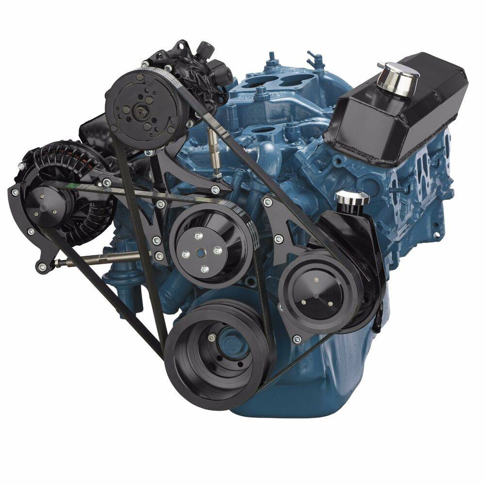

On a 1974 360 with AC and power Steering, Does the crank pulley only drive the power steering pump? Currently I have a Vintage air conditioner. The crank pulley turns the alternator and the compressor. The crank pulley drives the water pump and the power steering pump. The Vintage air diagrams show that only the PS is driven off the crank pulley. Since that is the way I purchased the engine, I wasn't sure if the pulleys were set up correctly.

This is a383 with air. take note of dual belts. power steering has one belt. most factory ac cars are set up like this. Do you have every thing. picture from
joe;s project on this site. dont know about Vintage air conditioner go to the web site. what belt system?​

The Vintage Air uses only one belt for the power steering. This belt only goes to the power steering. When I had the original Mopar compressor, I ran the belts like the photo. Thanks.
