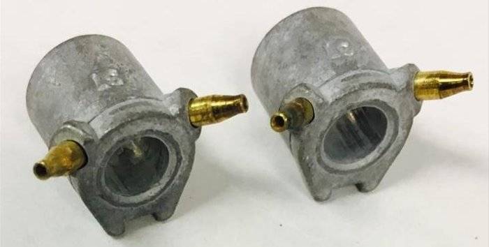

An empirical test of this fuel deflector piece would not involve a dynamometer. The best way to measure effectiveness is to physically measure the rate of change (acceleration) of crankshaft rpm with a given instantaneous opening of the throttle plates to a pre-determined position. It is possible, with the right instrumentation to measure accurately the rotational acceleration of the crankshaft. When I was a reliability engineer in a large chemical facility, I had access to such instrumentation. The throttle plates could be actuated with an electrical solenoid to say 3/4 throttle, then released after about between 1 and 2 seconds. Once set up, one could run a comparison test between the Holley standard shooter nozzle, the Holley tube type shooter nozzle, and the Thompson deflector to find out which device produced the highest acceleration rate of the crankshaft (best throttle response). ----------------------------------------------------------- One of Holley's solutions to increase the throttle response is the tube type shooter that's been around for a long time. The principle here is a little different, but I believe would be just as effective or possibly more effective than the deflector plates. The fuel stream exits the tubes at high velocity and impinges on the outside of the booster venturis. That disperses and atomizes the fuel mixture at a position near the center of the main venturi diameter where the air velocity is highest. Thanks for reading. ED
