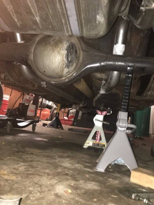

    I bought this system from Summit, it's got all the parts. If you poke around the website or call, maybe they will sell just that section. Quality looks good in the box. I'll start the install this weekend, I hope. I'm sure I'll have to make some mods at the back end to line up with the valance openings but the price was right for this point in my project.

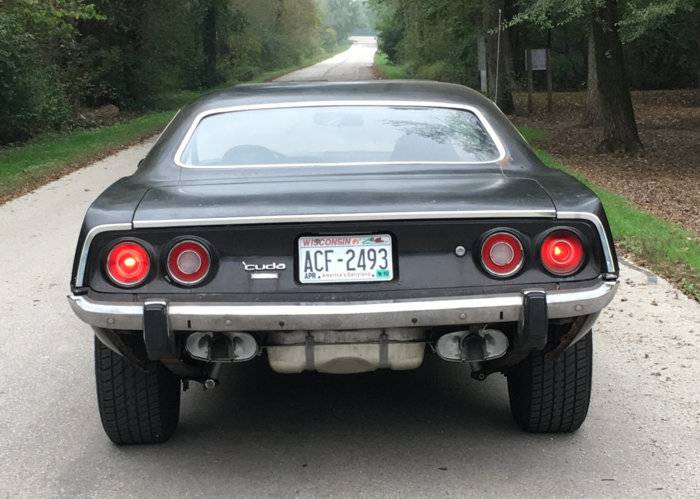

    Mequon, WI
