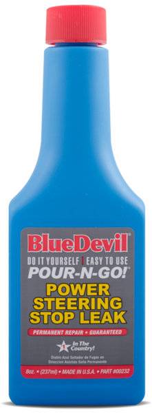

Thought I'd share. ..I have ZERO affiliation with this company.
After lots and lots of grief trying to stop my power steering leak....I finally decided to try a snake oil...out of desperation.
I read and read about different products and choose BlueDevil based on reviews and how it works.
It goes after the rubber seals and causes them to swell.
$4.88 on Amazon
I had a significant leak....100% GONE. ZIP, ZERO, NADA. Within one hour of using this stuff.
It's been several days now.....zero leaks.
Will it fix a giant hole in a hose....nope.
But I was blown away how well and fast this cured my leak 100%

Where was it leaking, pump or steering gear?
Pump....Down low in the area of the high pressure line....I tightened everything up well....new line....still leaked....
I was at my wits end. It should not have been leaking.
I never put much credit in snake oils, but this worked.

Hey Jeff.
I used the Blue Devil after reading this post and it stopped a leak I had at the input shaft of the steering box. However, I noticed when checking the fluid after a drive, it was smoking!! Did you notice anything like that? I posted on this forum and several replied just shamed me that I shouldn't use "bandaids" and rebuild to fix it properly.
