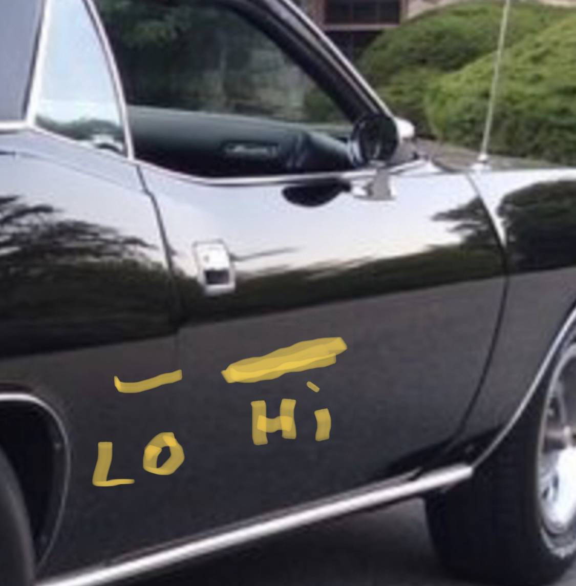

first picture shows the door alignment with it closed and latched. The horizontal body line is seen here with the back edge of the door displaced upward by the high pin location.

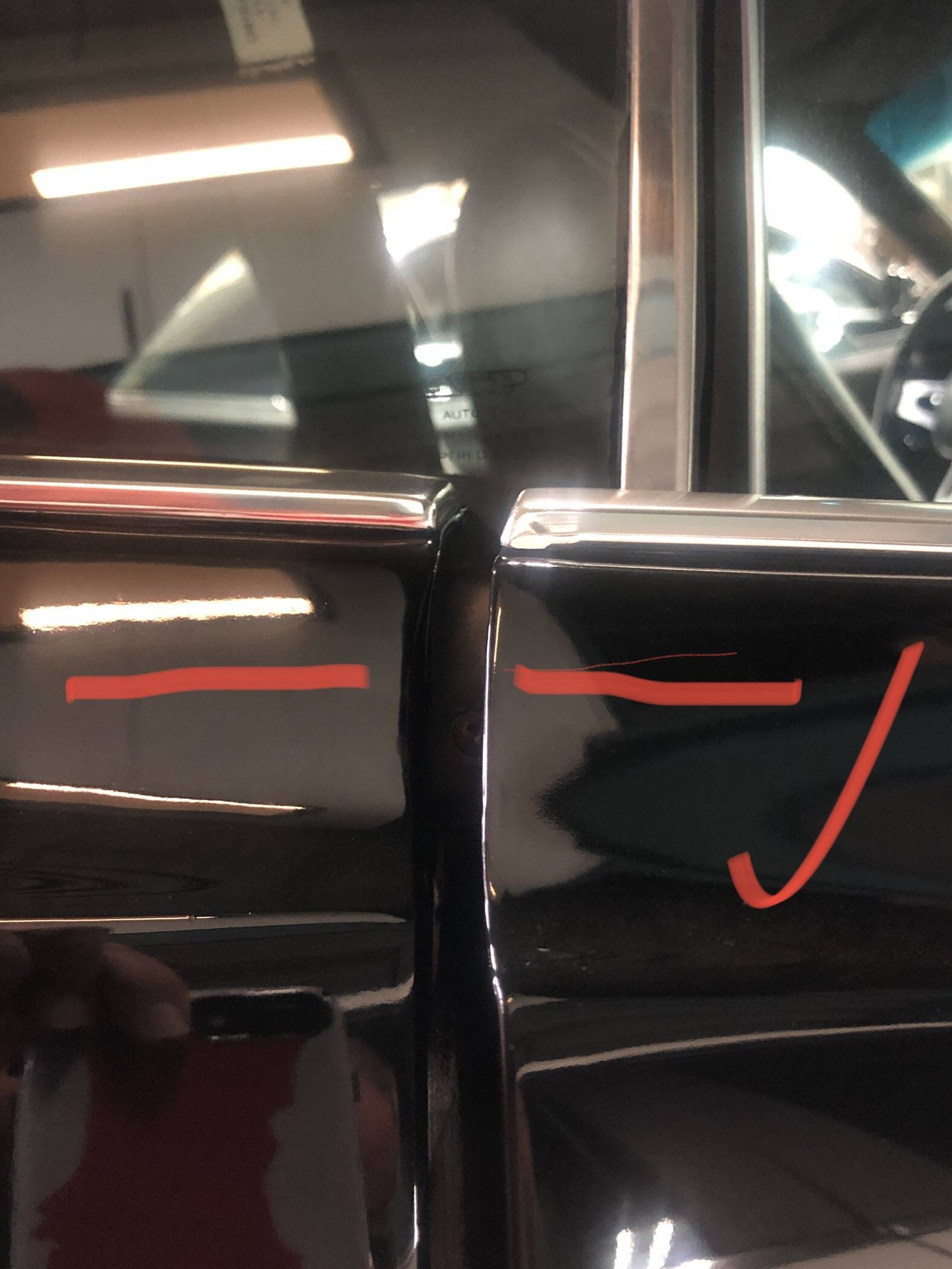

second photo below shows the SS window trim in a close-up, with the same upward displacement, again with the door closed.

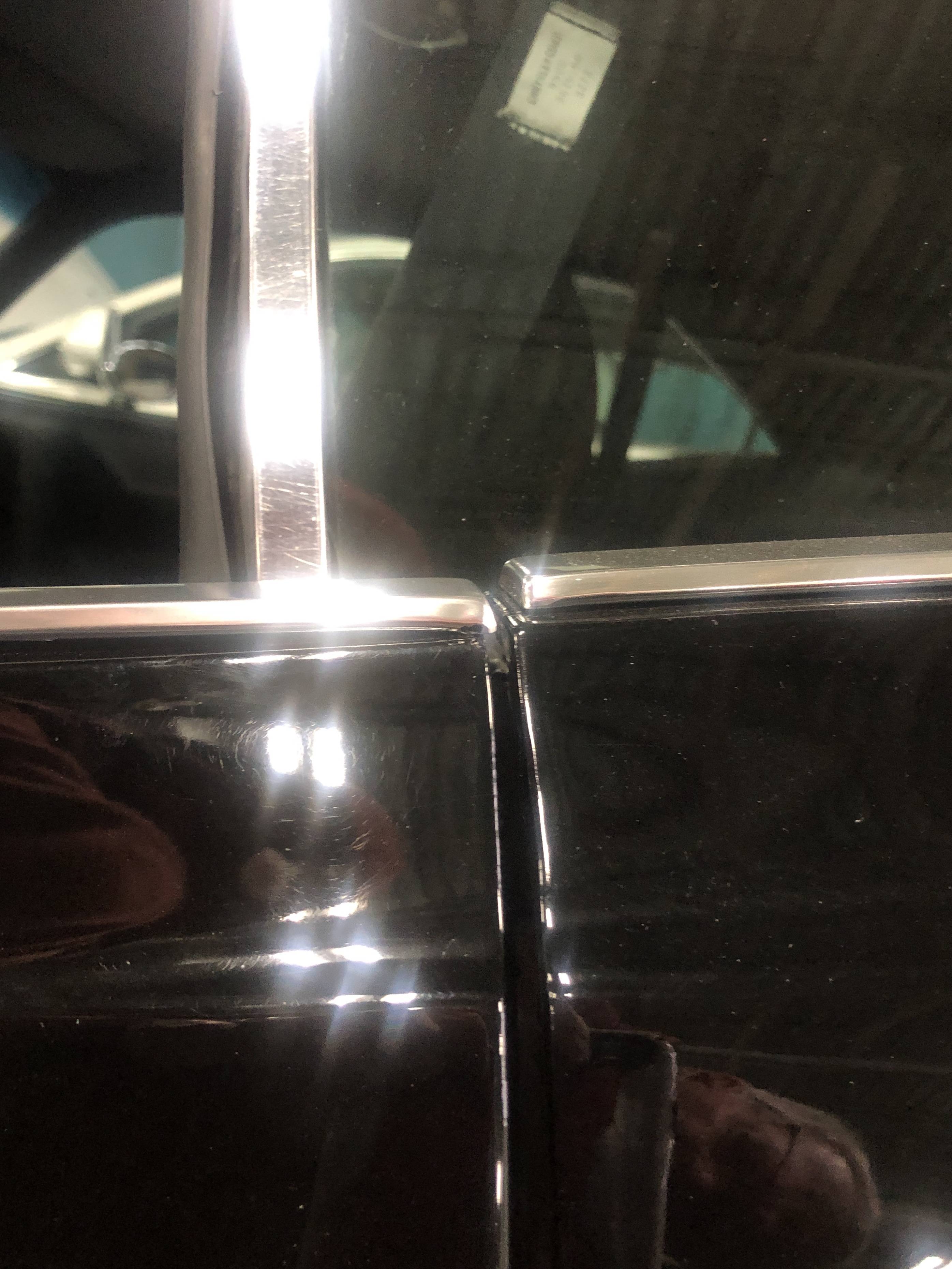

the third image below shows the door approaching -but not engaging the pin. the back edge of the door is in a better position if it were to close in at this elevation. But the lead angle on the vertical door striker plate raises the door at the last inch and a half of the full swing closed. Lowering the pin will improve the door alignment.

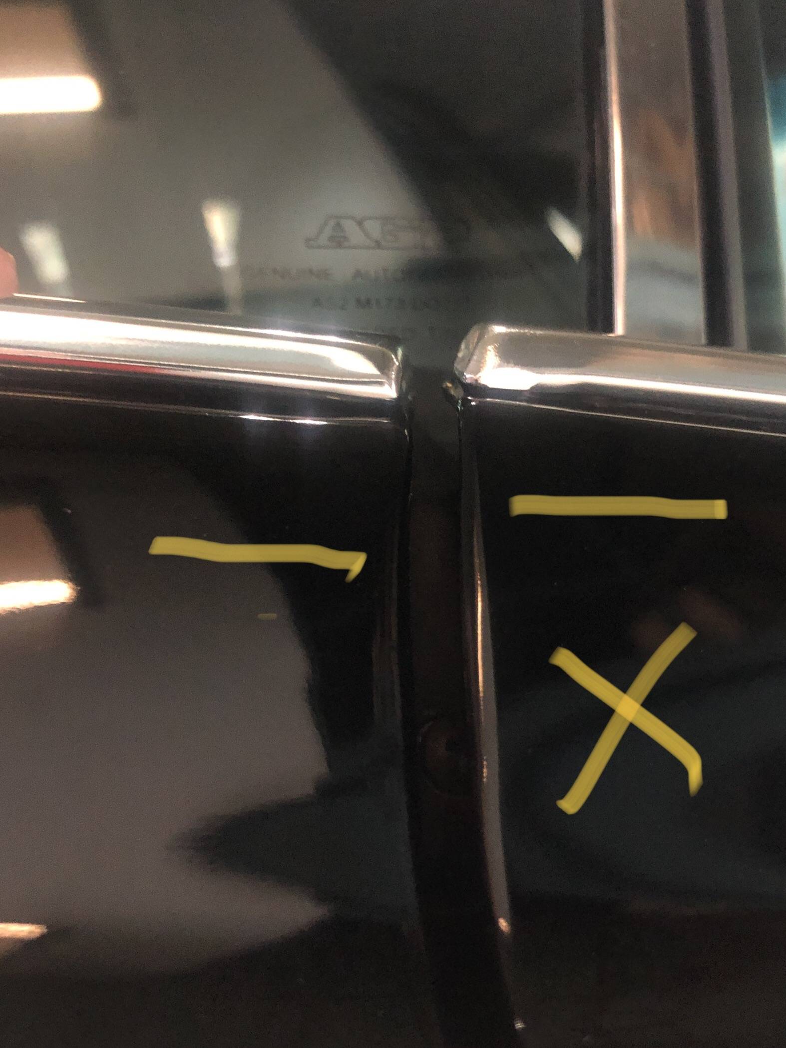

as a comparison, the picture below is of the Drivers side door, where the major horizontal lines and door gaps align very well. Note the low position of the SS door trim relative to the quarter panel. I can live with misalignment up here -as long as the major horizontal body line appears straight from fender-door-rear quarter which it does.

The door should not move up or down if the upper & lower hinge pins are tight to the hinge.
If it was tight, the door would not latch at all.
Open the door to full open. Lift up on the door from the quarter panel side. It should not have any play.
All door adjustments are made at the hinge side of the door. Moving the upper hinge raises and lowers the back of the door.
After you get the door to quarter panel aligned you will probably need to readjust your front fenders.
