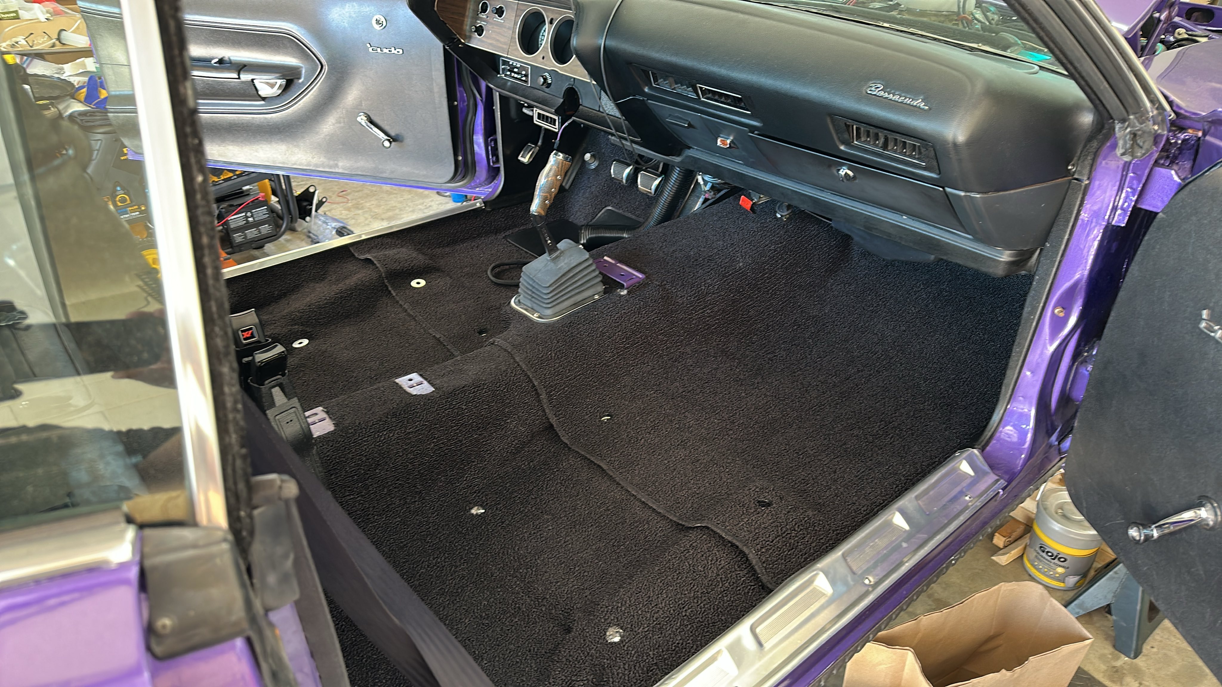

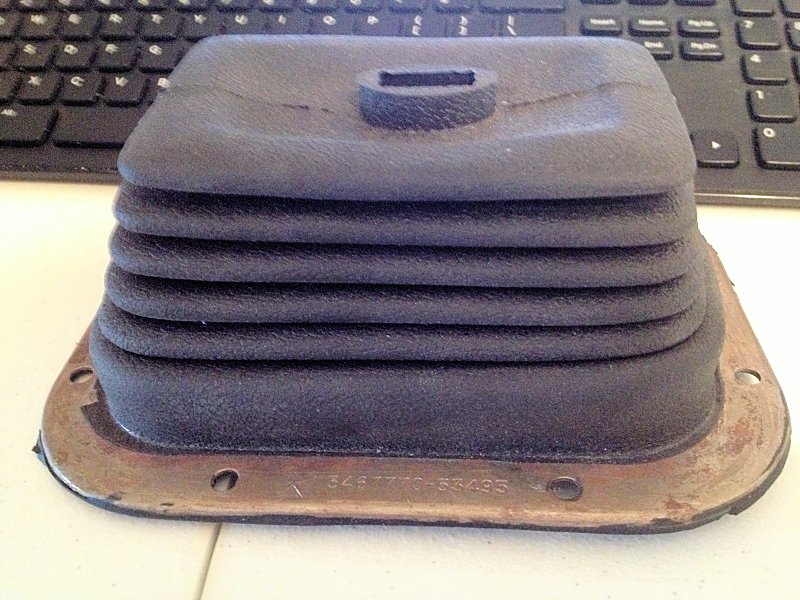

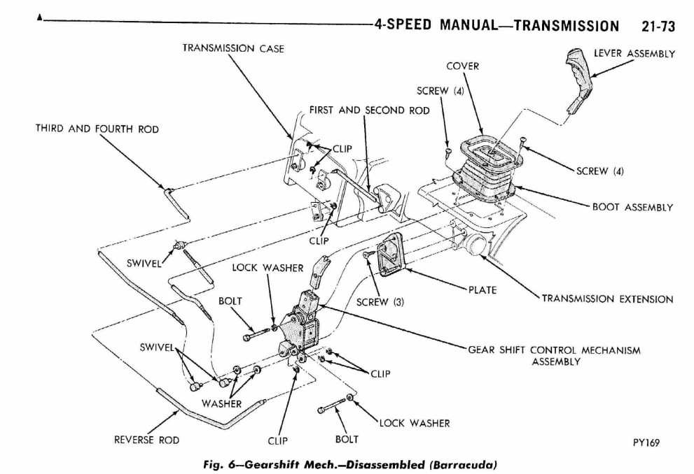

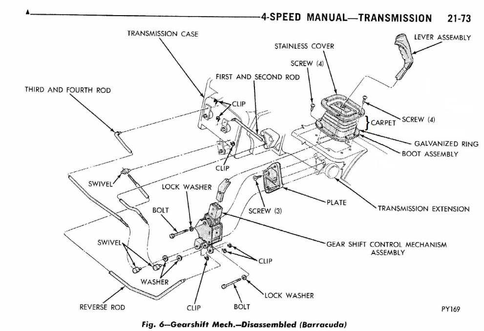

I am still working on my auto-to-manual conversion (Tremec TKX 5-Speed) and have questions on where the galvanized trim ring with 8 screw holes goes.
Does it go above the rubber boot to sandwich it to the transmission tunnel like the pictures below and use only the screw holes not used by the stainless trim bezel?
Then, the stainless trim bezel goes on after installing the carpet, sandwiching the carpet?
Just confirming to get it right.

I haven't taken enough 4-speed cars apart to be certain, but I believe that the lower trim ring gets installed on TOP of the carpet using the four screw holes that aren't used by the upper stainless ring. The upper ring then gets added just as a decorative cover. Pretty sure that's the way mine was when I got it in '88 and the way I still have it set up now.

Carpet first, then boot with integral ring and four screws, then the finish trim ring with its four screws. If you install the boot first you will trouble fitting the carpet around it.

UPDATE: Consensus is that the factory did it this way. Carpet is already in place and the hole precut. The pre-assembled galvanized ring/boot assembly is inserted through the hole in the carpet and attached directly to tunnel hump which seals out the elements. The galvanized ring secures the boot to the tunnel with the four black screws. The hole in the carpet is now overlapping the galvanized ring/boot assembly and the stainless bezel is secured with four chrome screws thus sandwiching the carpet to the galvanized ring/boot assembly.
Top to bottom:
Stainless bezel
Carpet
Galvanized ring
Rubber boot
Transmission tunnel hump
I updated the factory drawing to reflect the carpet and display the above installation.
