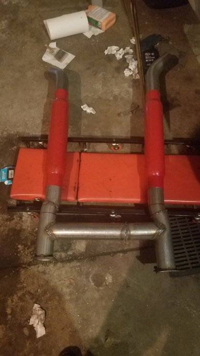

  14. bullet18
    bullet18 Well-Known Member
    Messages:
    171
    Likes Received:
    58
    Joined:
    Jan 4, 2017
    This is what i currently have. If i can im thinking about getting offset turbo mufflers and extending the elbows back so the offset puts the output infront of the rear tire and the mufflers clear the subframe connectors.
  15. quapman
    quapman Well-Known Member
    Messages:
    828
    Likes Received:
    208
    Joined:
    I see no issue with any additional mufflers aft of the glasspacks.
