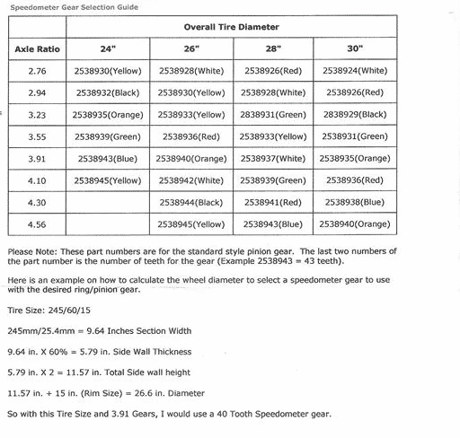

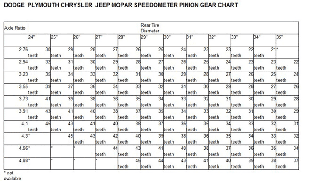

Just throwing this out there, what color speed gear for the trany . if it's a 727 auto 3.23 gear and a 3.55 gear ?
heminut
708
543
Deming, New Mexico
I never paid any attention to the color of the gear, I always went by tooth count. The tooth count number is cast into the gear. Believe it or not, with the size of tire I was running, the 32 tooth gear was what worked for me for 3.23 gears and the 35 tooth gear was what worked for the 3.55 gears!
MoparCarGuy
Jun 28, 2020
505
387
A couple of reference charts...
