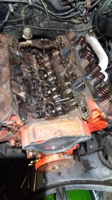

I started disassembling my 340 last nite thats been sitting for 30+ years. There was some surface rust in the intake/exhaust ports and lifter galley. I had rotated it some to make sure it was free and ck the timing chain but that had a load of play. I am now tearing the heads off to check the cyl walls etc. The cam thats in it is an old trw tp-156. Lobes look fine but i have a 508 purple shaft old style grind which i might install while im in there. Anybody ever use that trw cam? If its a good fit for the car, i might just keep it in there. 71 challenger RT 340 4 sp and not sure of gears but most likely stock for the car. I dont want to run a junk cam if thats what it is. Also while draining the anti freeze, which actually did drain, some clumpage came out of there. Hope it aint that corona virus crap! Lol. Input is much appreciated!
