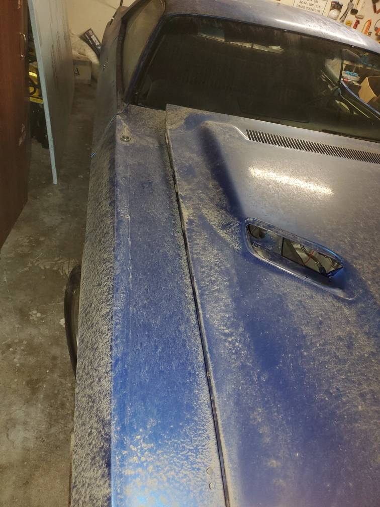

The car got shipped here open trailer and it is caked with grime! the original hood hinges are sprung bad, so when my Dad put the hood on before shipping reusing the old hinges it sticks up bad on the passenger side. I got an entire trunk and interior of the car FULL of parts of chrome, and carpets, and dividers, and panels, and stickers, and gauges, and extra windshield wiper motors, wheels centers, and exhaust tips, and every kind of screw and bolt, and 95% of everything needed to finish the car. The windshield glass has been replaced with light green glass, and the side glass is original clear glass that I plan to replace with light green glass, and when the car arrived there was no rear glass on it...

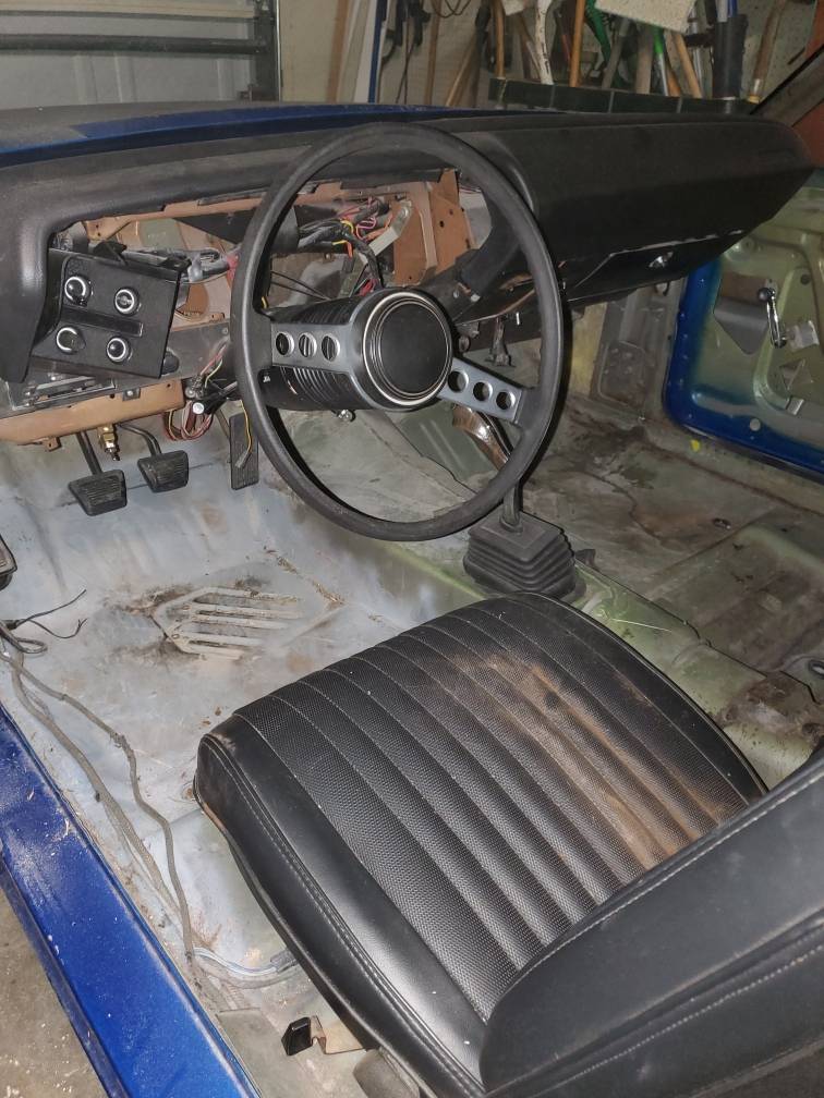

SUPER excited to get started!!! I am a little intimidated by the gauges and their is just a big hole where they should be full of wires, and I have heard all the juice flows through the ammeter too... I am pretty handy and own a small painting and remodeling company, and have been around old Mopars my whole life, but I am surely no mechanic so here we go!!! I will post many pics to chronicle my adventures, and will try to dig up some old pics of the car from my Dad's time with it...

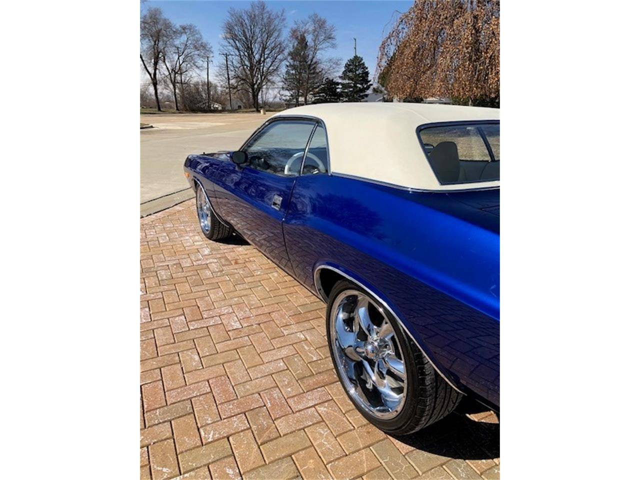

this is the general look of the car I am currently thinking of (except the one in the pic is a 70)....
Same exact color. Same Rallye wheels (Except mine are 17's). Same top except it will have the inserts on the front fenders since my Dad left the holes for them...

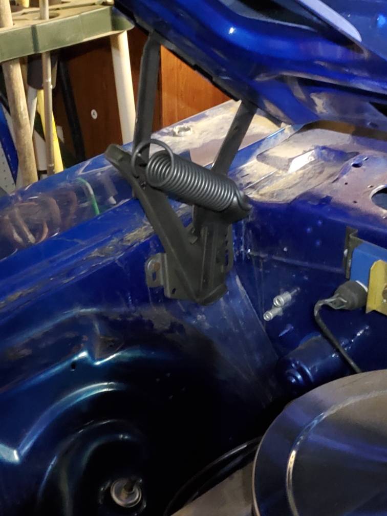

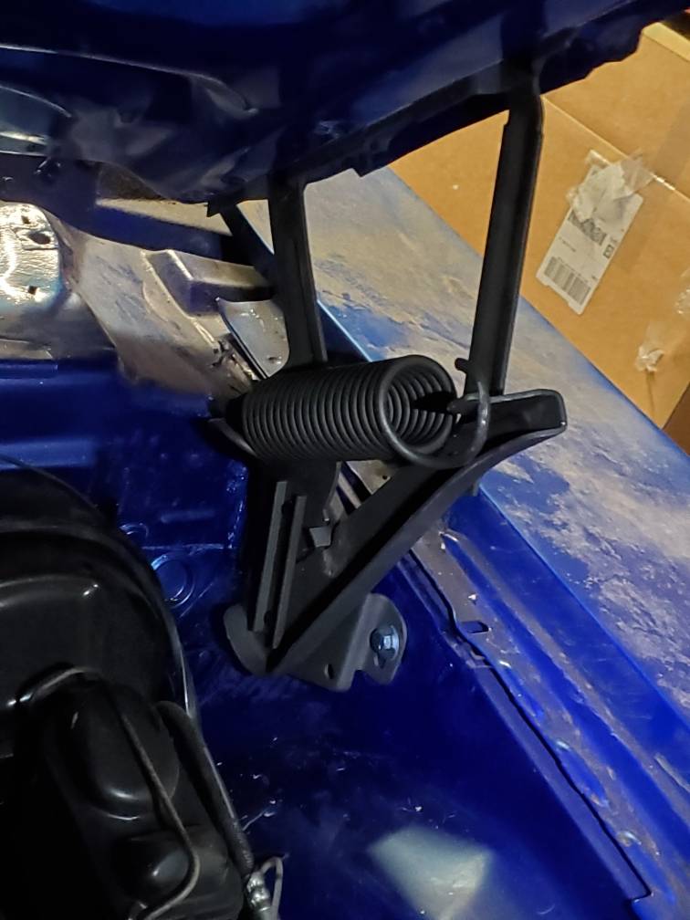

If you loosen the hood hinge bolts & over lift the hood to twist the front of the hinge up & the rear down the hood will close properly .

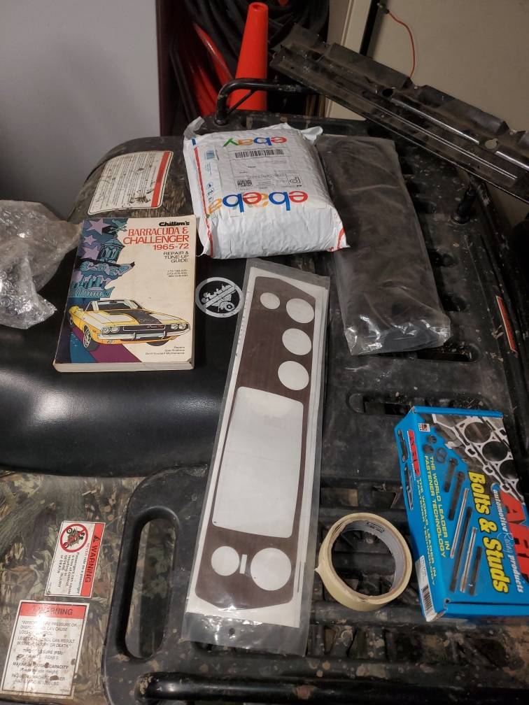

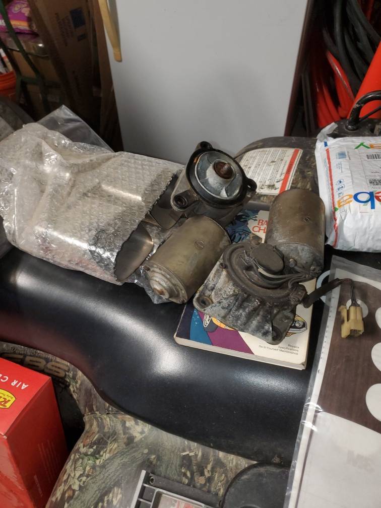

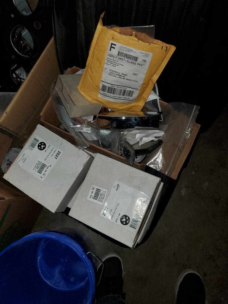

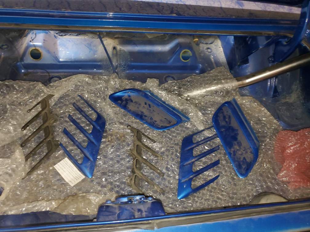

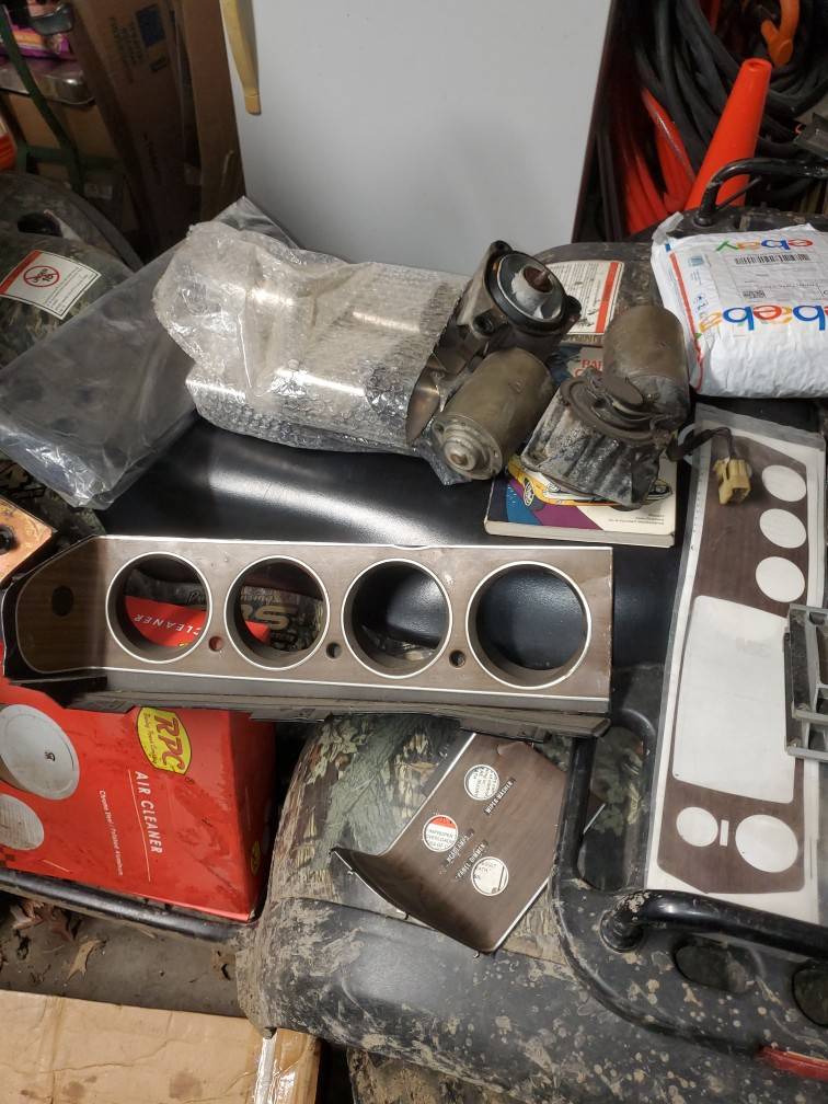

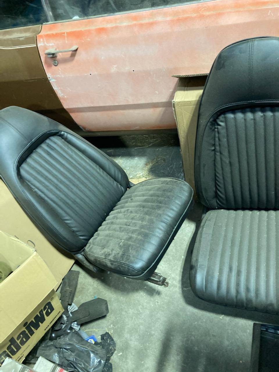

Here's some pics of the stuff I took out of the car that my Dad had got together to restore the car...

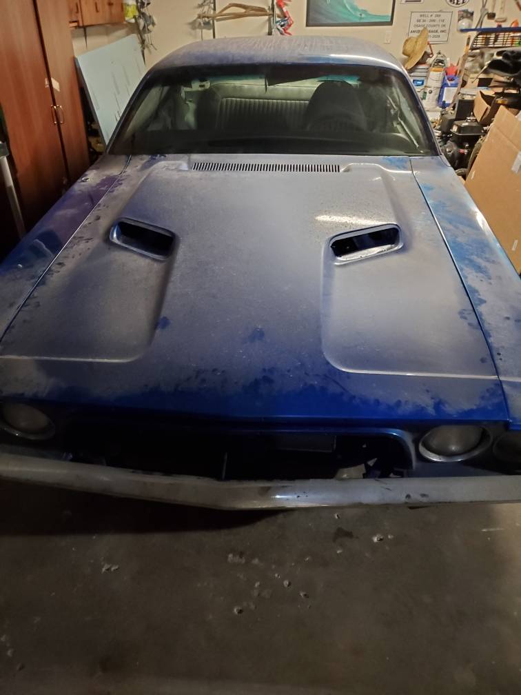

here is the hood with possibly sprung hinges, I am gonna loosen the bolts and "overlift" the hood and tighten them down to see if that works in my situation as suggested by others before I intsall my new AMD hinges and springs I bought for $350 on Ebay...

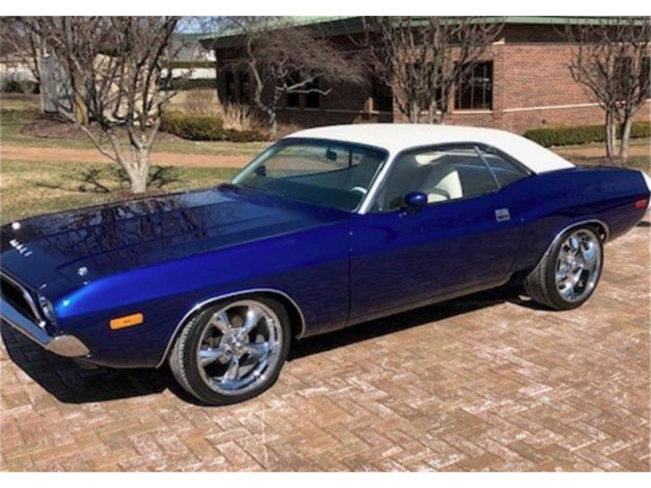

I guess I'm naturally going towards this type of look, but honestly I'm a bit bored with that look, thinking of cool mods to do... Any suggestions???
Maybe a white vinyl top?? And white strobe side stripe???
Like this cool car has...
But with a White vinyl top like this???
Or maybe just the white stripe and put the vinyl top chrome on and leave the top blue? Hmmm, any votes????

I replaced the hood hinges and springs with AMD's, and the hood was till about the same off on the same side, so I went through all the adjustments on both sides on the uppers and lowers for an hour and I got it pretty darn close, I am happy with it for now, until I adjust the fenders and such better. I also had to readjust the hood latch mechanism so it worked properly. Now the secondary hits a little hard, but I'll mess with it soon...
P.S. I actually know very little about these things and am just figuring it all out, so I did make a small chip in the back corner of the hood and a tiny one putting in the rear glass trim clips on the pins... Well, live and learn I guess, hopefully they can be fixed without too much trouble and made to disappear... I also haven't been able to wash the car since I put in the back glass due to a freak ice storm and ensuing nastiness, including massive amounts of salt everywhere on the road, etc... Looks like its gonna snow for 4 days straight and have wind chills of 20 below so, I guess washing the road grime from shipping it here will have to wait a bit longer...

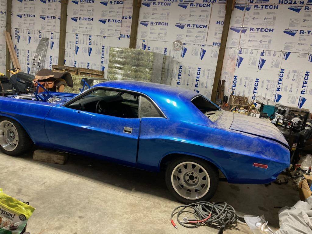

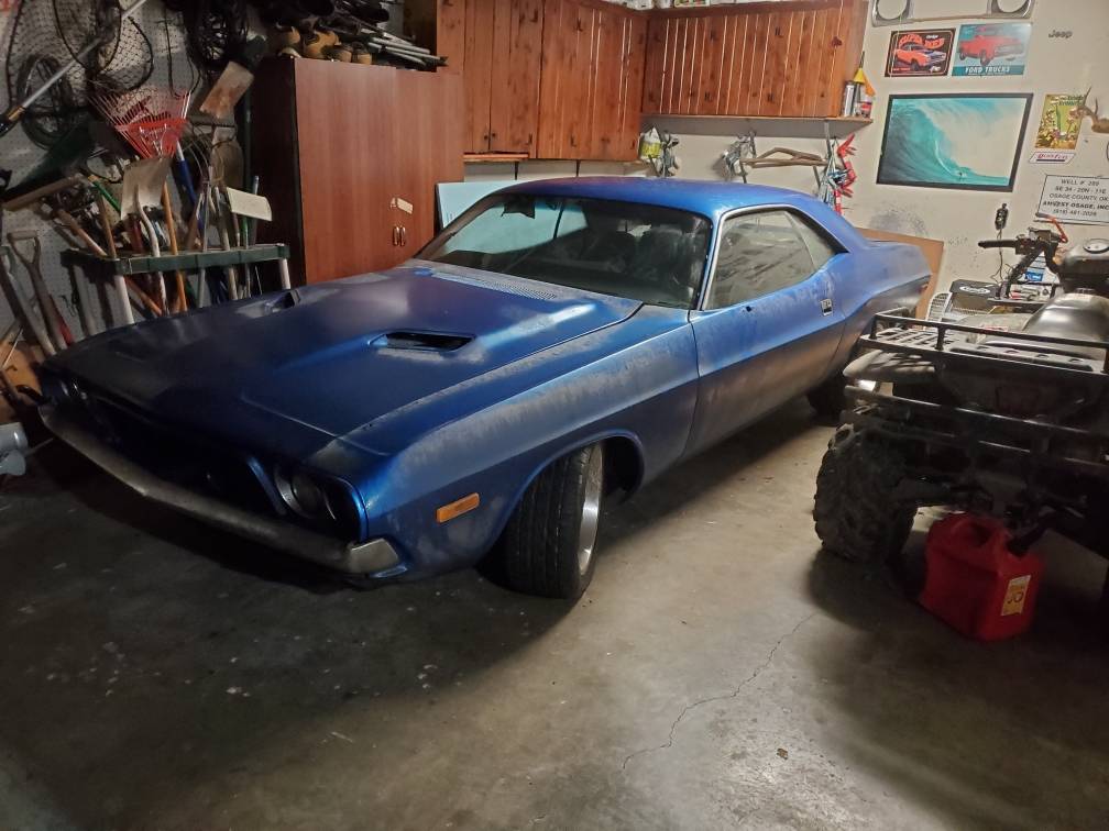

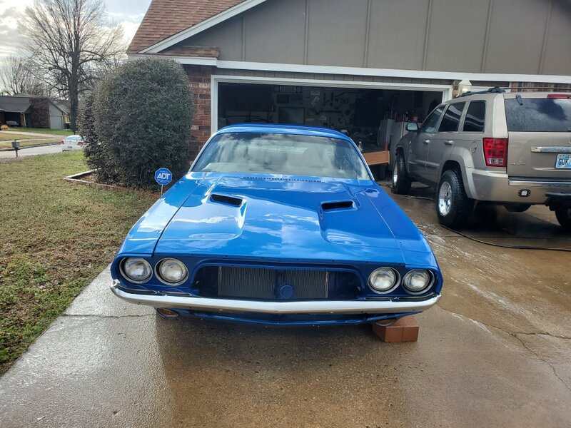

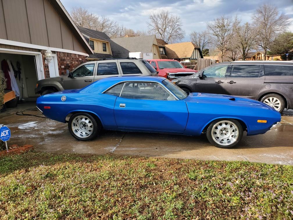

Washed her off yesterday... Looking goooooooood! Super excited to put the underdash gauges on, get the alignment done (including raising the torsion bars a bit), and getting the exhaust on... Then on to interior stuff!
P.S. I noticed a few chips from what is probably little rocks thrown onto the car during shipping, as they use sand and such on the highways up north and it was covered with road grime when it arrived... live and learn, and grieve a bit for now... HOPEFULLY, I can get them touched up passably?
