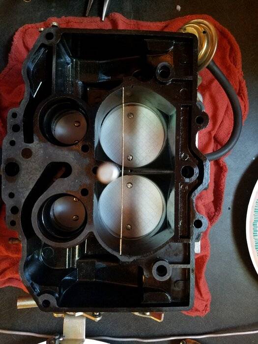

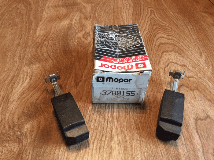

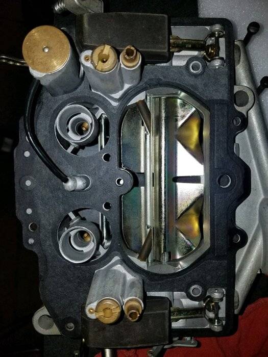

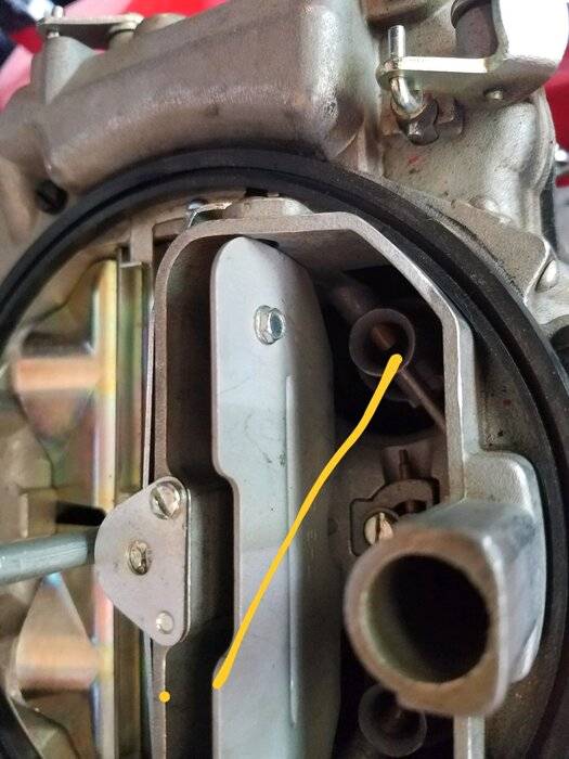

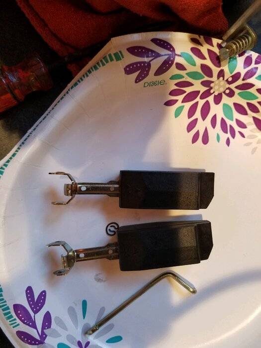

Hey guys, if anyone can help out I would appreciate it very much. I'm struggling with a Thermoquad. I have a 1971 on a 340. I have had several of these in the past and never had any problems with them. I sent this one off and had it restored about 5 years ago. I ran it on the engine test stand about 3 years ago and it seemed to run great. Now after completing the car it is running super rich. So much that it is smoking black most of the time. I tried adjusting the idle mixture screws but it doesn't change anything by turning them in or out. I have turned them all the way in and engine still runs. My experience in the past was that the engine would stall when they where turned in too far. I noticed that when the engine is idling with the choke fully open there is a slow drip of fuel coming out of the tubes located in the round part (venturi I think). It's the tube in the picture with the yellow line pointing to it. I don't think this is supposed to be happening. Can anyone tell me if this is normal? What is causing it? How do I correct this? I really want to drive this thing but it's embarrassing the way it is running. Thanks so much for any guidance.
