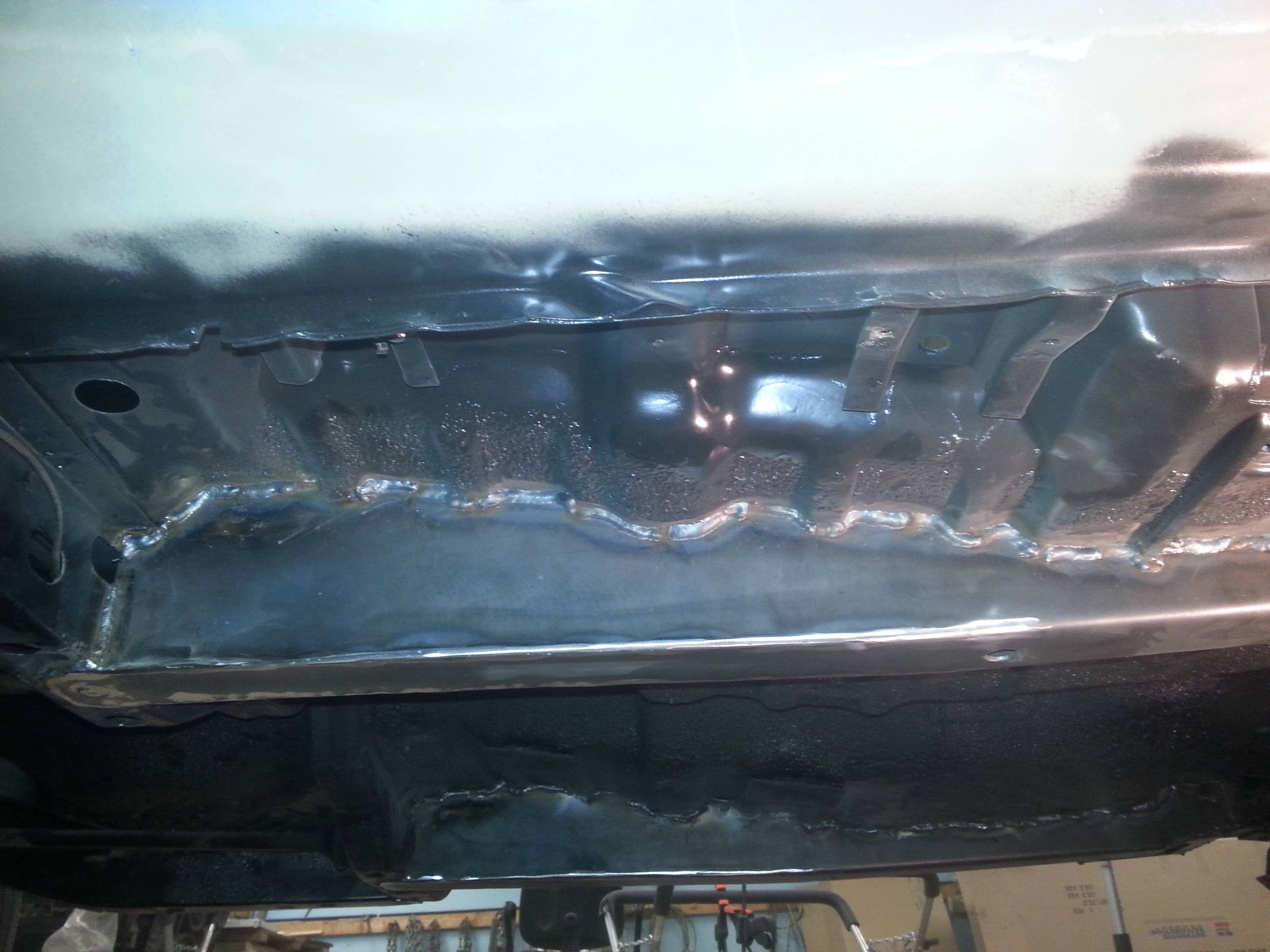

I would say if you’re going to be running it with those tires and launching it, put some connectors on it. There’s plenty of choices or you can make em yourself and only weld on either end. The type that contour the floor requires a bit more welding. JMO

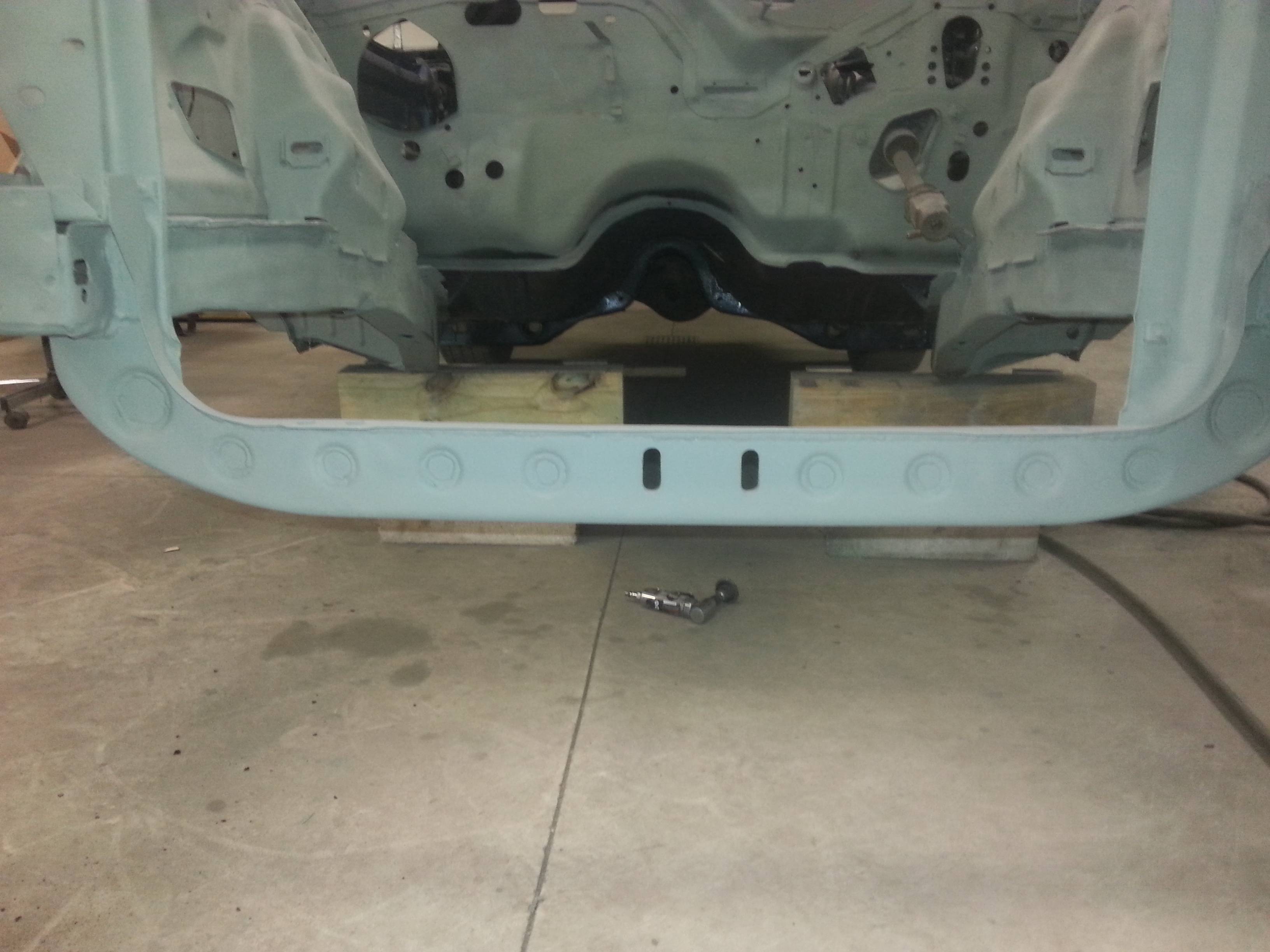

Kozlow
Jul 19, 2019
5
I installed USCarTool frame connectors on mine, and I really like how the car feels now!
Actually I installed the frame connectors, front and rear torque boxes, inner fender braces, and core support brace.

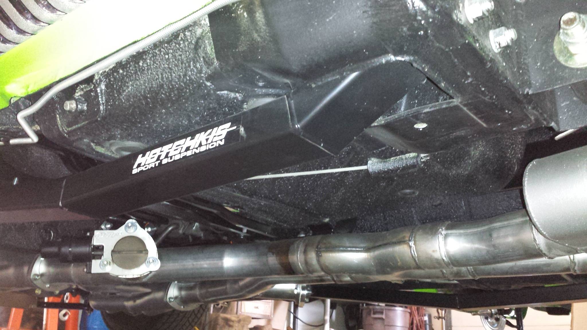

moparmarks
Dec 15, 2020
441
75
Western Colorado
Sorry but Chevelles and Vettes make great drag cars because of their full frame and are able to launch harder than a unibody. Period.
Put both an Mopar convertible and a GM convertible on a lift and compare them. Even with fully welded in frame connecters the Mopar will flex and sag so much more then the full frame car. The GM vert will act like a Mopar hardtop. Pretty much no flex.
moparmarks
Dec 15, 2020
441
75
Western Colorado

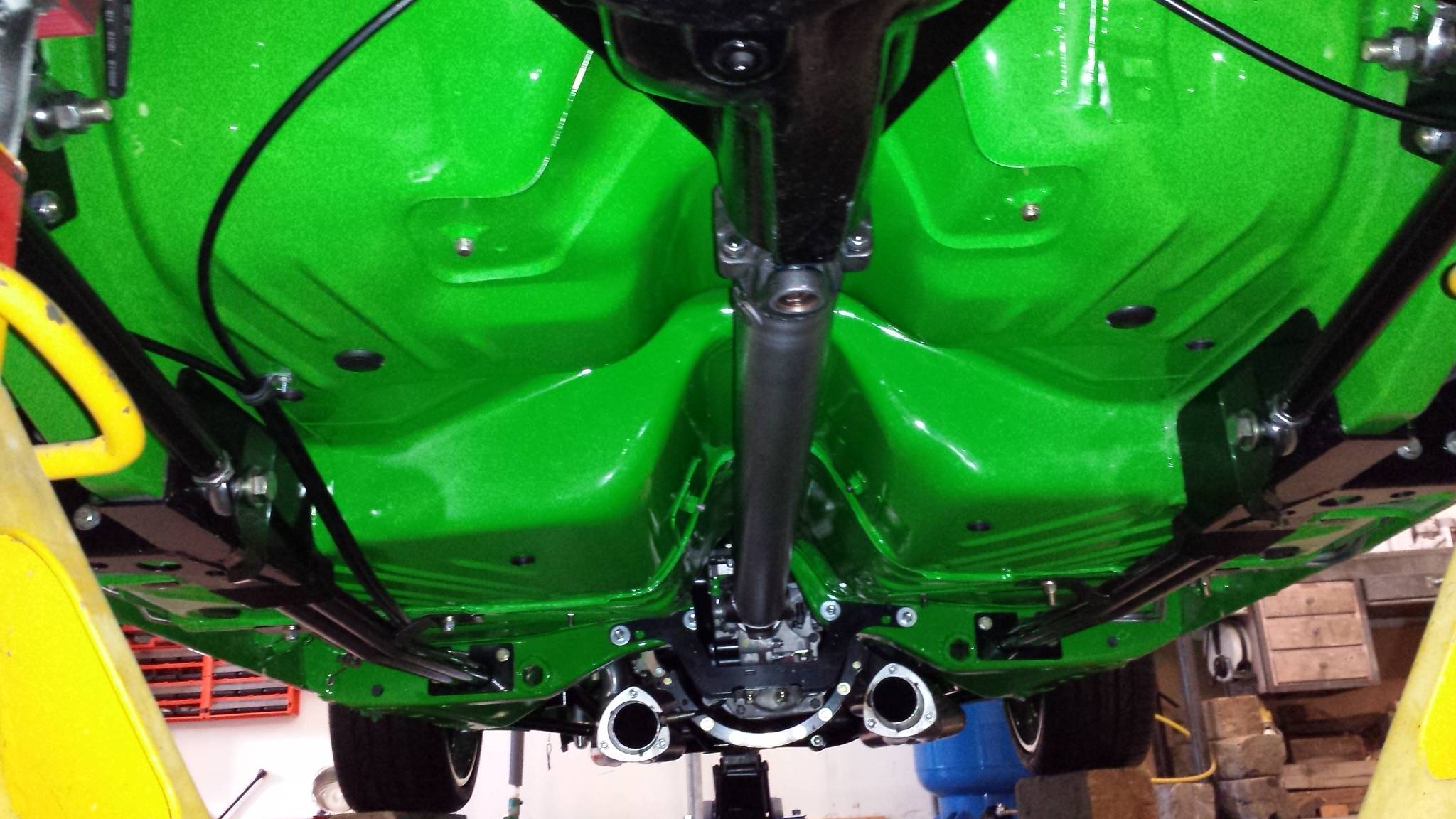

I used the Hotchkis bars on a hardtop and they are ok.

70chall440
Dec 11, 2010
1,260
976
Western Washington
If a full frame isn't better why do they sell a full frame to put under a Cuda? Why are we using sub frame connectors to make a full frame? A full frame is just better.
They do, Art Morrison, Schwatrz, the roadster shop, etc. However a full frame is a lot more expensive and harder to install than sub frame connectors.
I have installed a variety of connectors but prefer the USCT versions. Yes they do require the seats and carpet come out but the end result is a super clean install that looks like it was always there (or should have been). Once they are in you can jack the car up on them if need be. All of the other connecters merely connect the front clip to the rear which is fine but offer limited advantage, the USCT connectors actually add to the overall structure of the car.

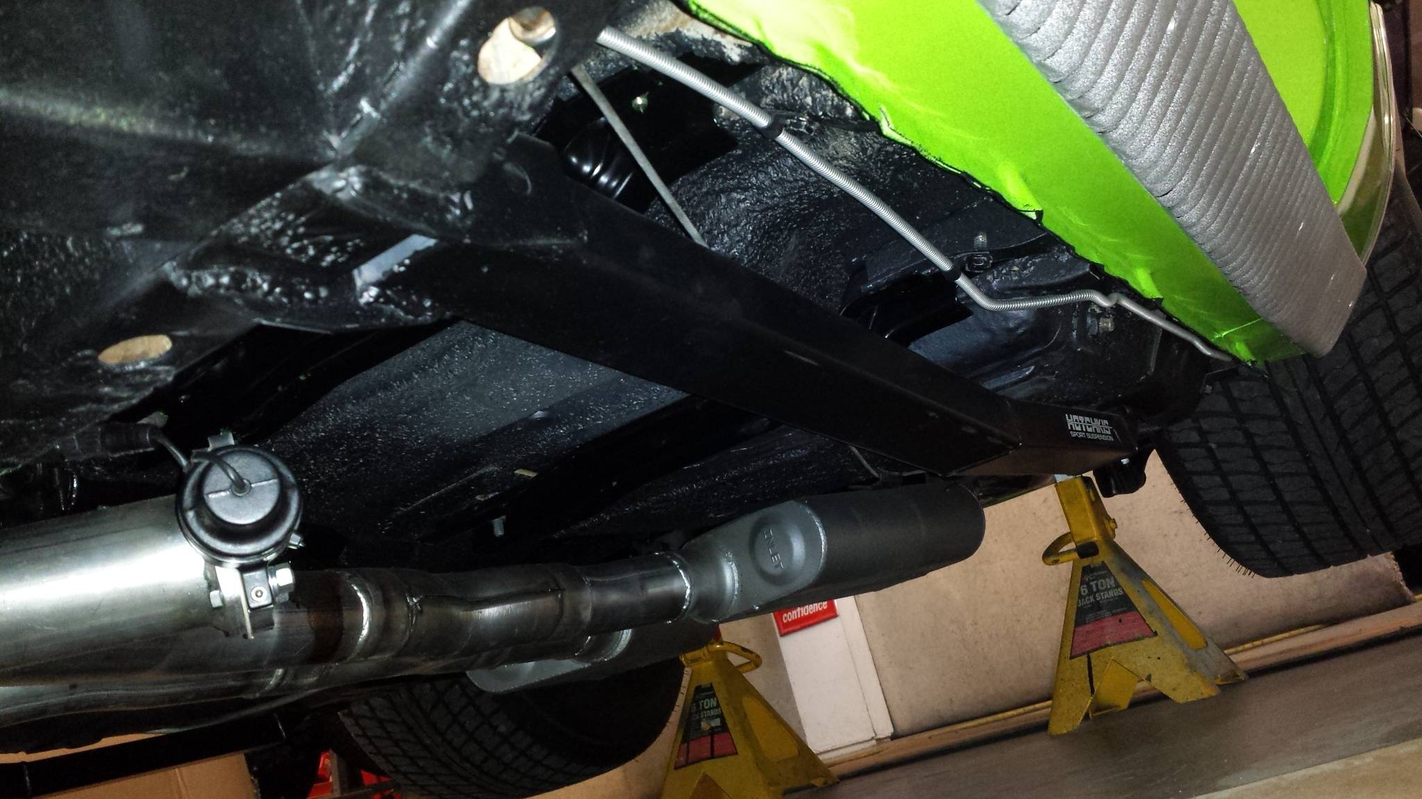

moparmarks
Dec 15, 2020
441
75
Western Colorado
Magnun Force twin tube design. I did one theirs to on a 71 Cuda vert but I just bolted them in. Don't think they did a whole lot on a vert. Maybe better for a H/T.

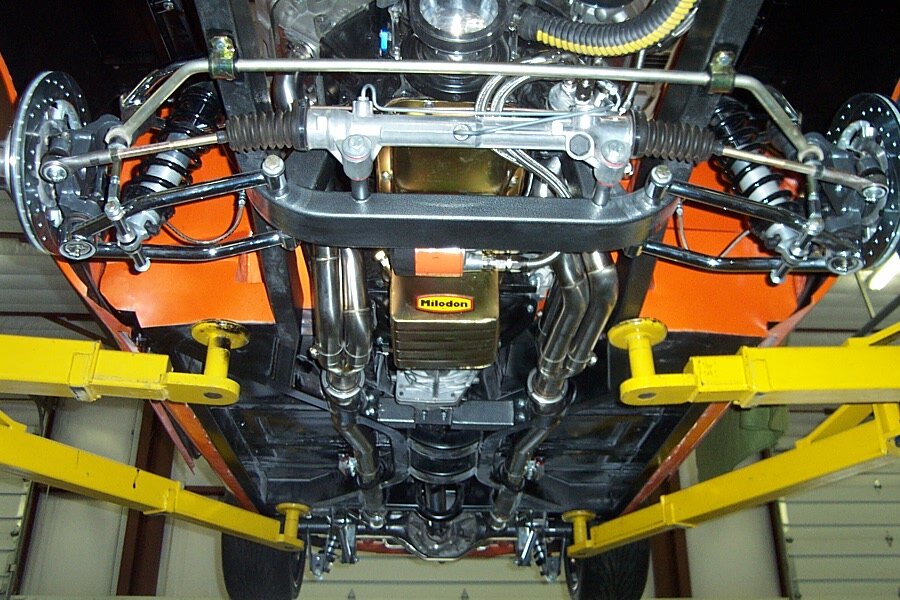

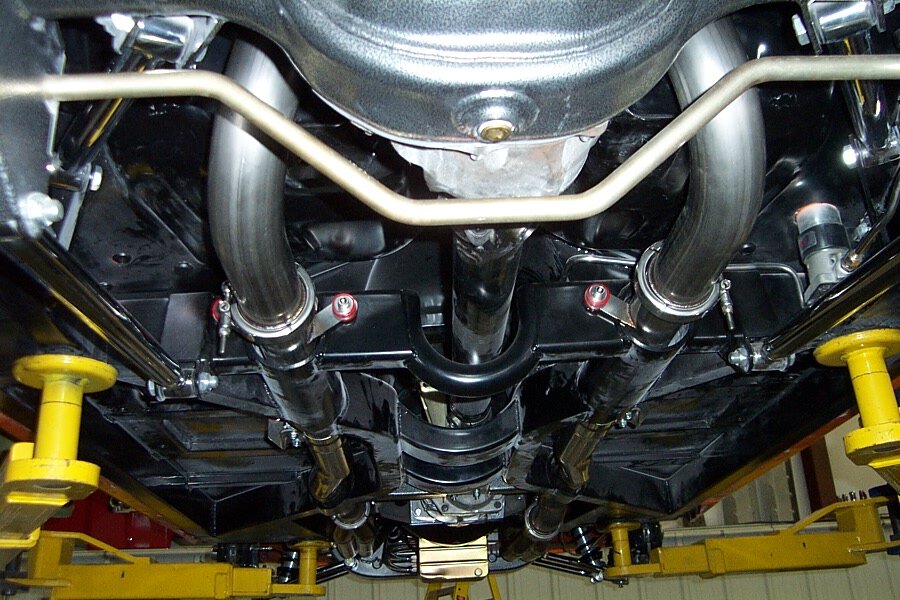

moparmarks
Dec 15, 2020
441
75
Western Colorado

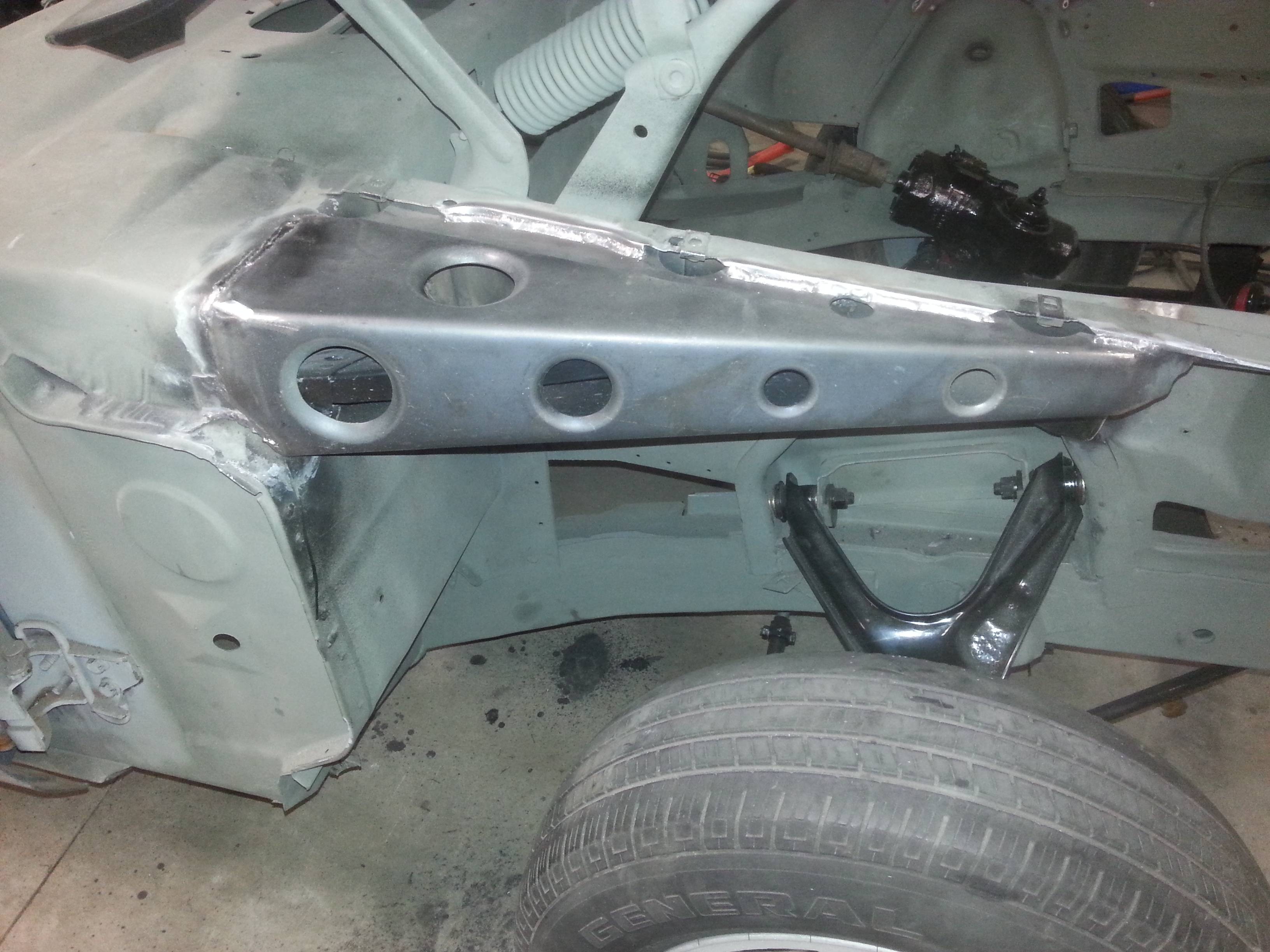

Years ago I finished a 70 Cuda vert that had an Art Morrison full frame in it. Man what a pain in the ass that car was. That frame setup moved so many body components. Firewall, floors, hump etc. You don't want one of those unless your building an extreme road course race car which this car wasn't.
It was by far the stiffest Mopar convertible I've ever seen.
