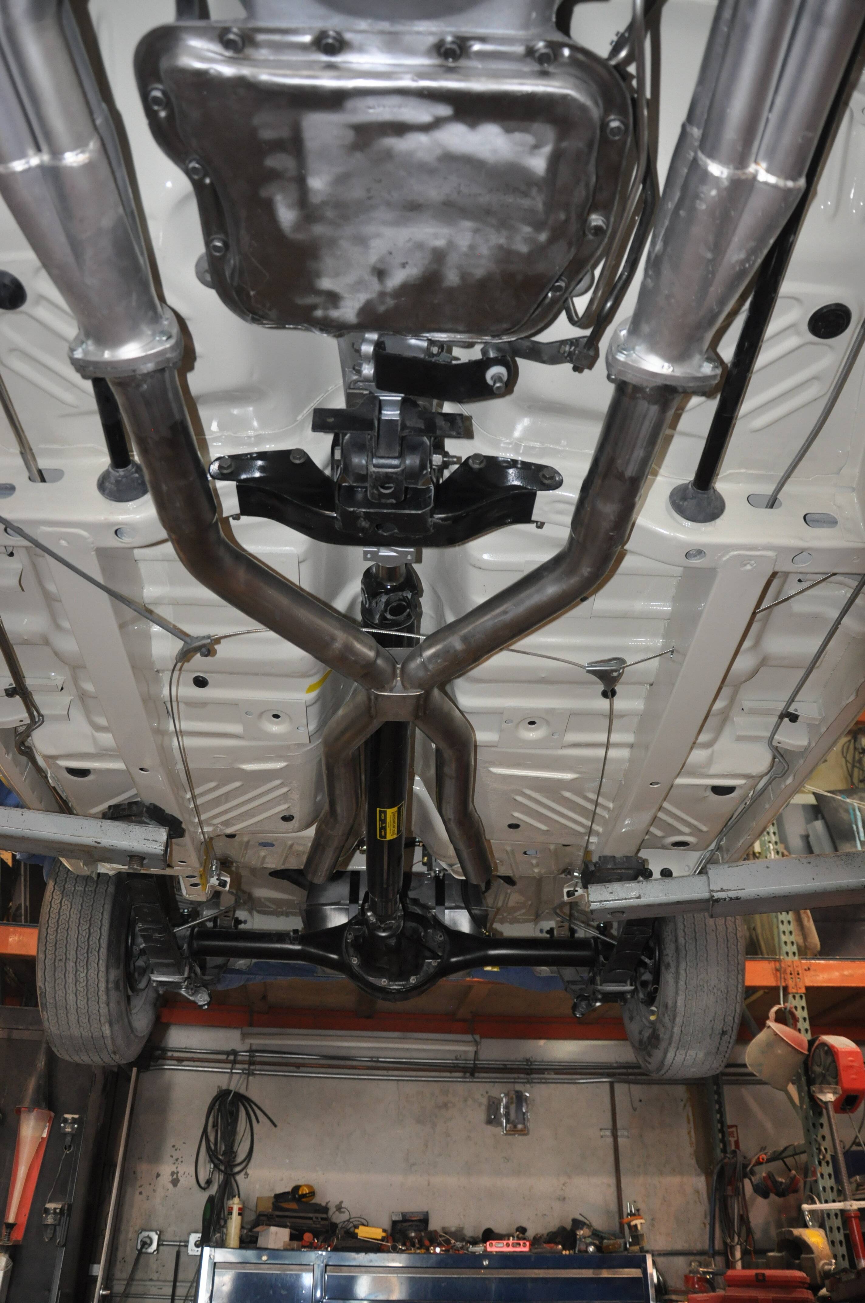

My car has a 340 block with dual exhaust and TTI headers. Frame connectors are outboard of the torsion bar bushing in the cross member. Exhaust is all inboard of everything. We did have to drill a hole at the correct angle through the drivers side frame stiffener for the parking break cable.
