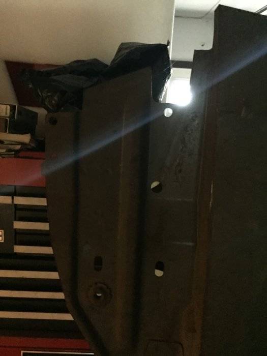

  5. challenger6pak
    challenger6pak Well-Known Member
    Messages:
    3,653
    Likes Received:
    633
    Joined:
    Feb 27, 2011
  6. 340challconvert
    Messages:
    2,866
    Likes Received:
    1516
    Joined:
    Feb 13, 2011
    Location:
    Parsippany, NJ

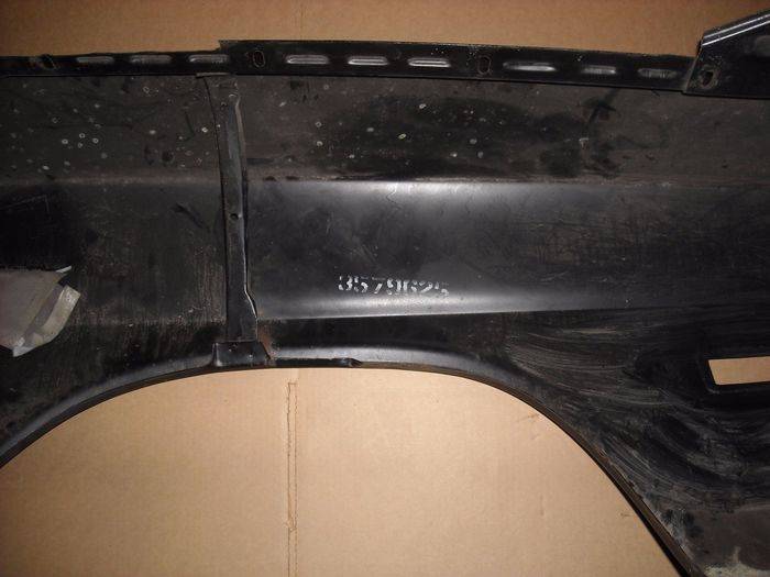

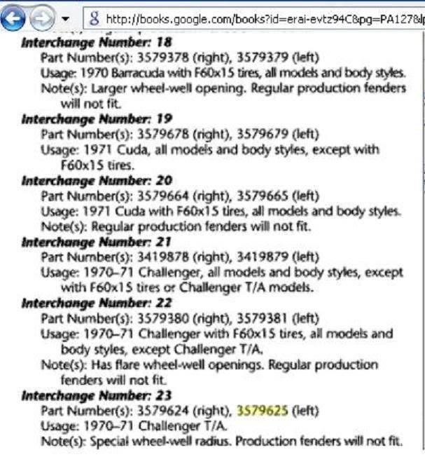

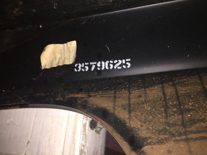

    I have the same fender/s as 6pak
    I picked up new NOS 624 and 625 pair of fenders in 1980.
    The part numbers "correspond" with "TA Challengers with 14" wheels (which never happened)
    Both of mine have this roll up and the 71 Challenger front notch.
    The thought was that these were the last fenders Mopar produced as universal units for all 70-71 Challengers several years after initial production???
    They were NS1 at the time and both fenders were laying in the back of two different Dodge Dealerships, so I grabbed them.
    Anyway, they have this "roll"
