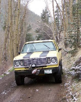

It's a 77 Ramcharger. 74 440, 77 203 transfer case, Transmission came from a yard with no I.D. Auto transmission mounted right up to 77 transfer. Thousands of miles on the transmission. My first auto transmission rebuild (with my best friend and ase mechanic over my shoulder). It's been running in the truck for 17 years. 203 727 4x4 . If it were the wrong size shaft, as mentioned by Kim, it would have failed already. I've twisted two main drive shafts right in half.
