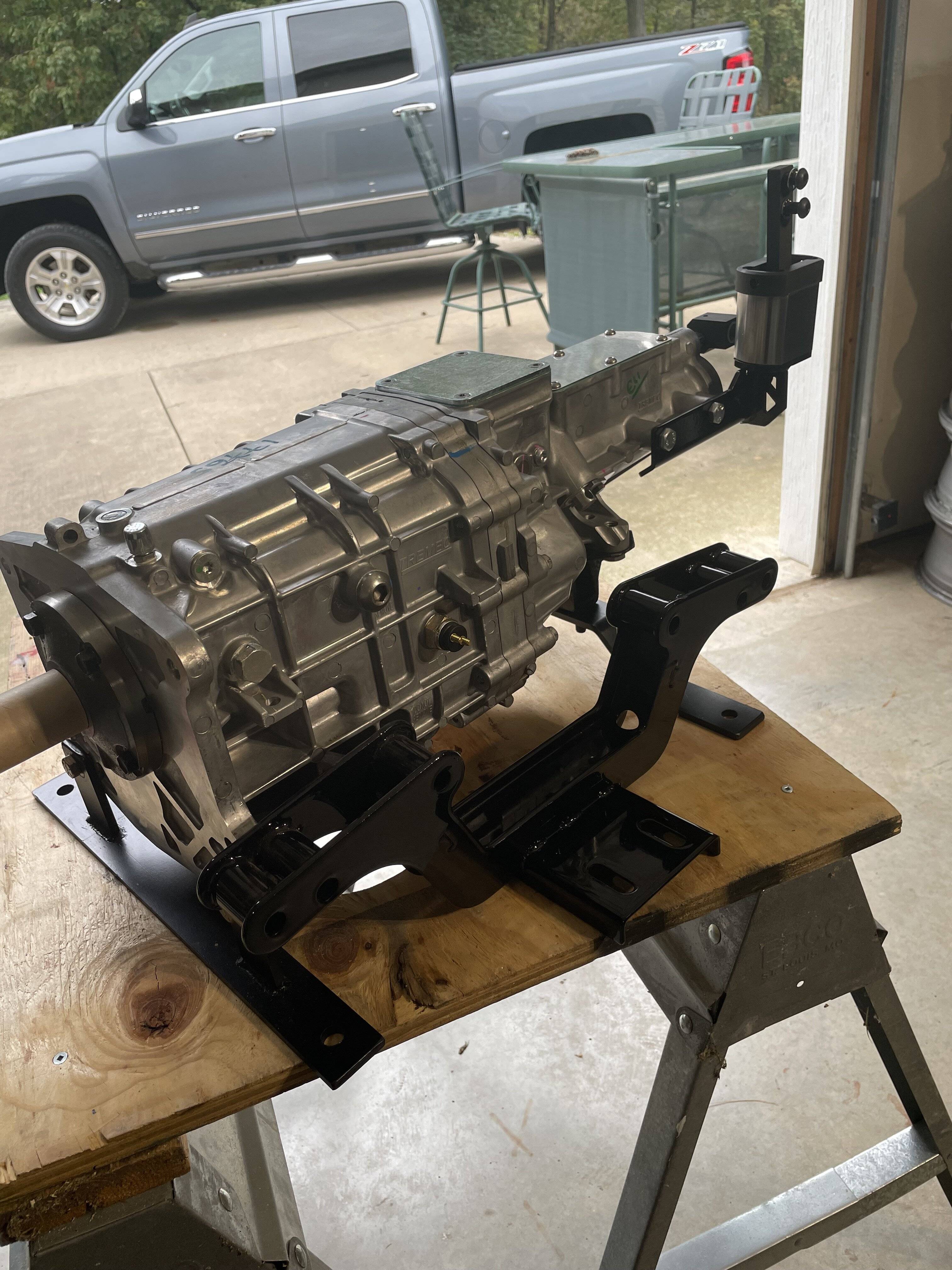

Has anyone taken delivery of the the new TKX for the E-Bodies? I know it fits the tunnel - I'm wondering about the necessity of machining the tail housing. Here is why.
