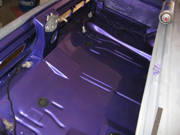

    Body color was factory correct. Otherwise it looks like you are trying to cover up some problems. Also, to save money you can spray the trunk with a single stage paint instead of base & clear. 81154FC3-CE3B-4A11-BA8D-C9573068D8A3.jpeg

    WHY on earth is it so tempting to use truck bed paint on a car? That stuff sucks.
    Use real automotive paint with a hardener. Don’t by cheap acrylic enamel, get good urethane that will last. This includes the primer, no rattle cans!
    Yes it is expensive, so is your car.
