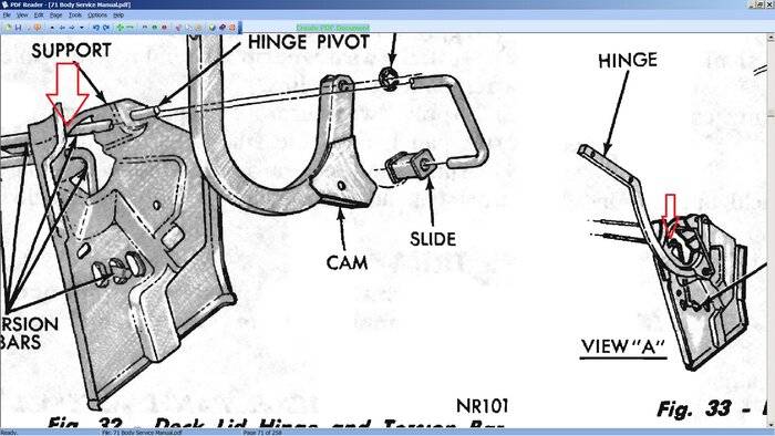

Anyway, I am putting the torsion bars back after putting the decklid back on but I'm not sure of the steps for installation. The Body Manual is quite vague about it with no detail. Has anyone done a few of these and knows the steps? My decklid has the Gull Wing so I need to use the rearward slots and as well I am not sure about those curved slots that are facing the rear (at the top, just under the lid seal area, see attached picture). Does each bar lock into the end of that slot?
Also, do the TB ends go into the desired adjusting slot first, then tension applied at the hinge cam, then the bars put into those rear facing lock slots? The attached drawing from the manual doesn't show these curved slots but I have put in two red arrows showing the location of them.
