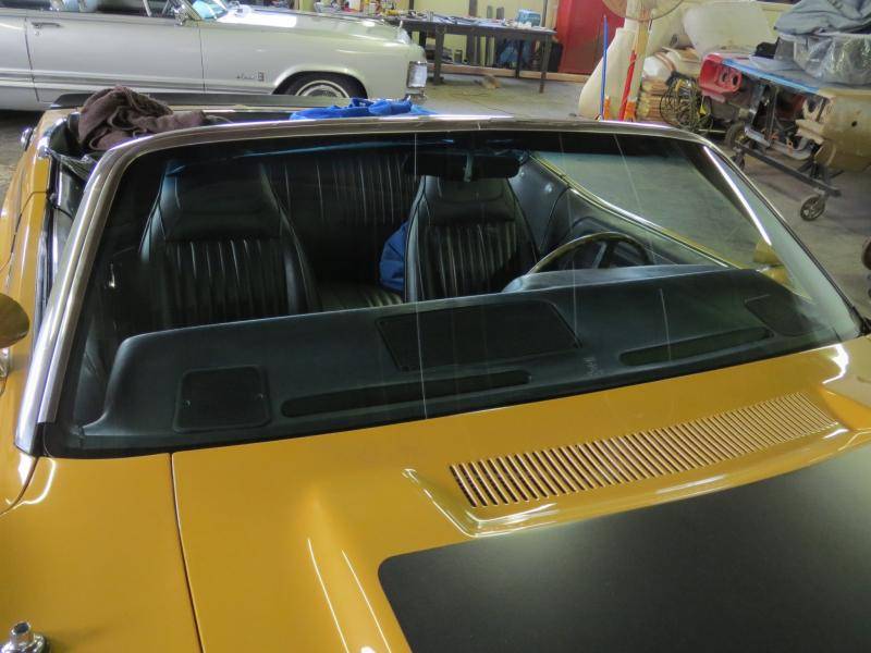

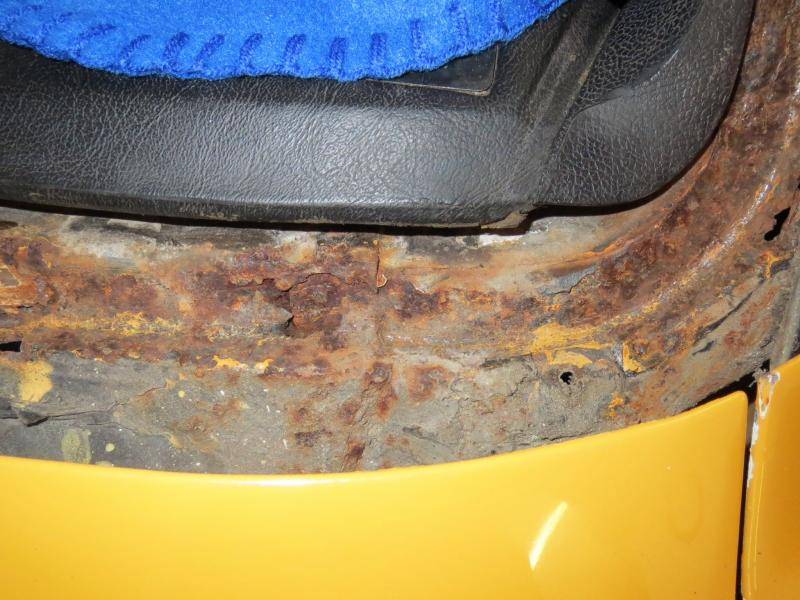

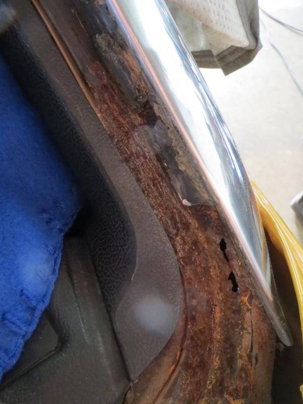

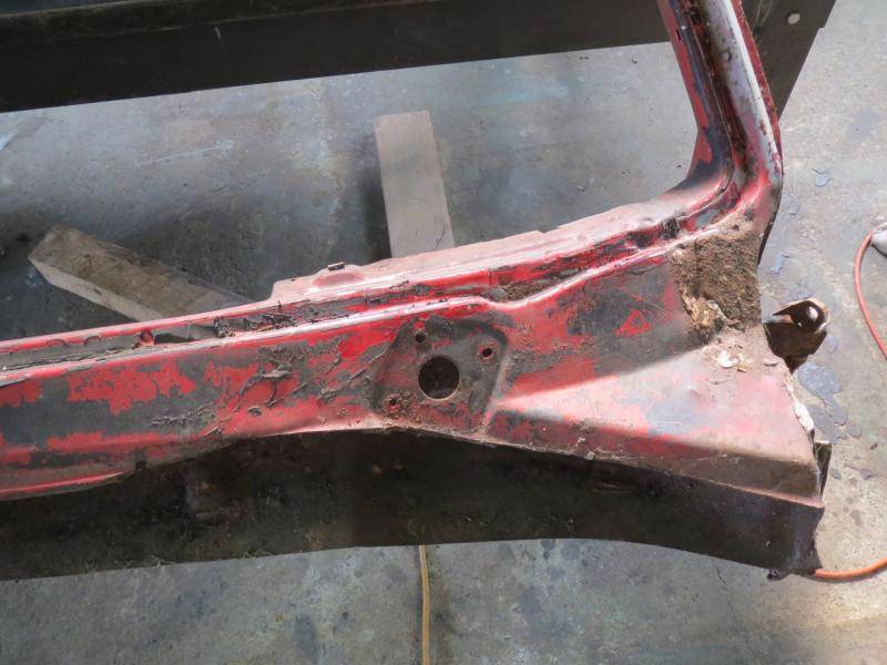

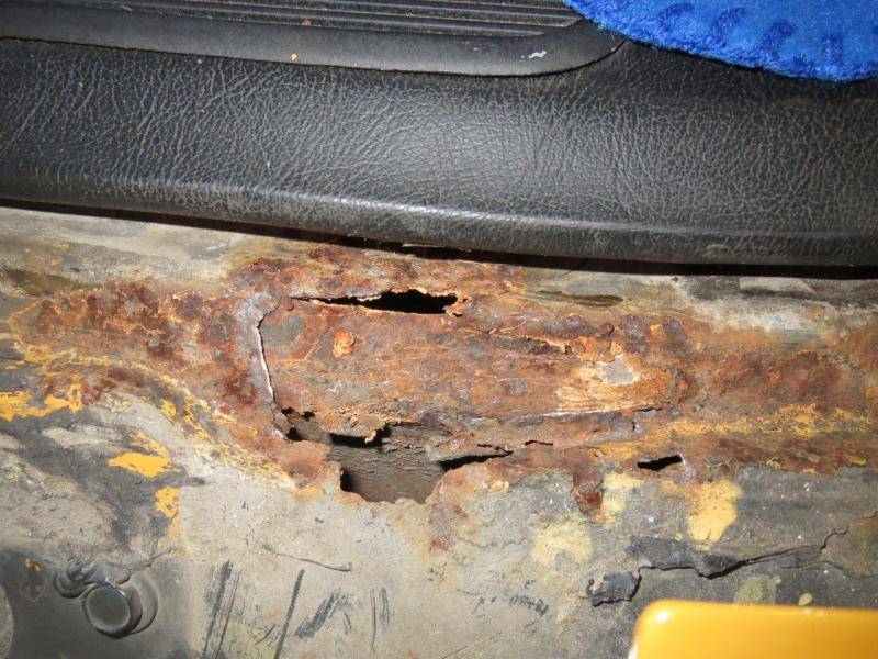

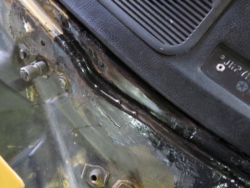

The windshield in my convertible was in terrible condition with deep scratches from the windshield wiper which were there when my dad bought the car 18 years ago and worn from years of media blasting over the road. I bought a new one from Roseville Moparts(thank you David Radcliff) and had an installer over yesterday evening to install it. We found this after removing the old....
I don't want to be down for long because of this so the repair starts now. Lucky I have some doner parts!

Surprise. Or not. You more or less have to expect that when you open a can of old Mopar.

Dino2 (1).gifMatt, I know how you feel.
This is exactly what worries me as I drill down on my A66 vert.
My windshield has been cracked (happened while in storage?) for years. I have a clean used one or a supposed NOS spec windshield to install that I just purchased.
I hope there are no surprises when I remove the chrome and damaged windshield.
Are you doing the work yourself or farming it out (metal cutting and welding)?
Good luck with the repair

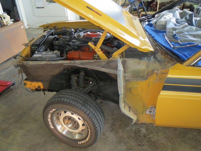

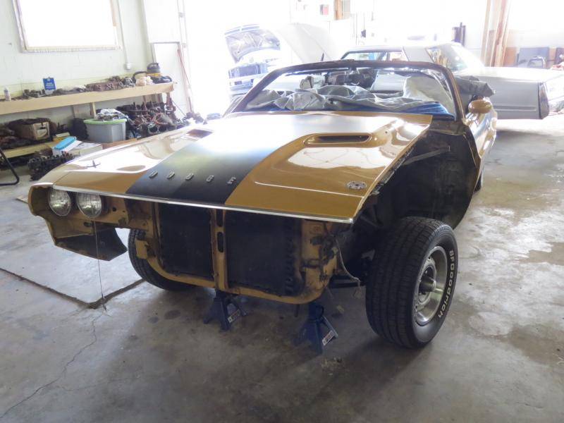

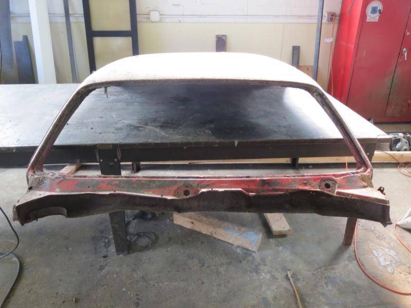

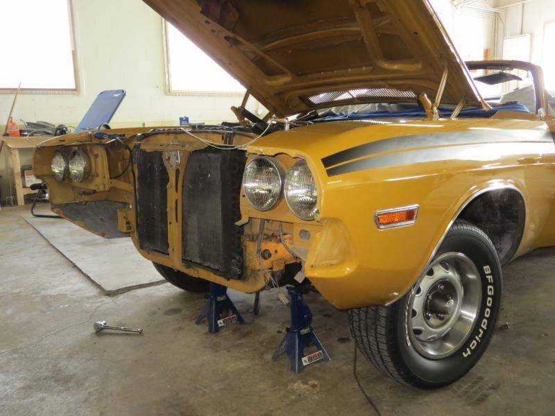

I don't want to risk damaging anything while doing this repair so in order to get the fender off, the front bumper assembly had to come off. Also pictured is the doner part that I'm getting the metal from. Next will be moving the dash out of the way at least a couple of inches and maybe this will be the opportunity to put the ralley instrument cluster in it.

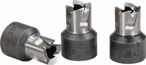

By the way, if you're going to be replacing a large panel with a lot of spotwelds (particularly a roof), look into a RotaBroach spot-weld cutter. It's way better than the type you see most of the time, and don't be scared by the drill bit pilot in the center--it's spring loaded and doesn't actually drill a hole. It just centers the cutter perfectly without using a punch.

The RotaBroach cutter (I have the 11096 kit) is made by Blair. I bought it on the recommendation of a friend that owns a restoration shop. This cutter makes the ordinary parts-store Blair cutter with the black cutter heads look like a child's toy. I quite literally cut 11 welds out of my car before I realized the drill was running backwards. :eusa_doh: It didn't even occur to me to check because it was going so well. Going in the correct direction? Nothing short of staggering. There's no doubt I'll get the whole roof off with one cutter head.
They can be found elsewhere for less money (including eBay), but this is what they look like. They do not work with a standard arbor, you need the specific one shown in the kit.
Blair 11096
Close-up on the cutters themselves:

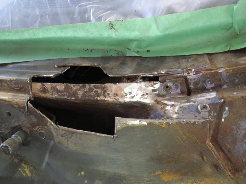

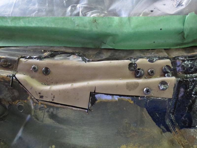

I got the rusty stuff cut out after I unbolted and moved the dash out of the way a bit. Cleaned up the surrounding metal and treated it with some POR and then ground the POR back off where the panel bonding adhesive was going to bond the replacement piece in place. Cut the corresponding good piece off the doner roof, cleaned it up in the blasting cabinet and gave it a coat of welding primer which I also ground back off where the adhesive will bond it. Mixed up a bit of adhesive and used it generously and used self tappers to secure while the epoxy sets. I will then weld the but joint in front of the windshield and probably just use body caulk to seal it up on the inside of the windshield. Here's what that looks like.
