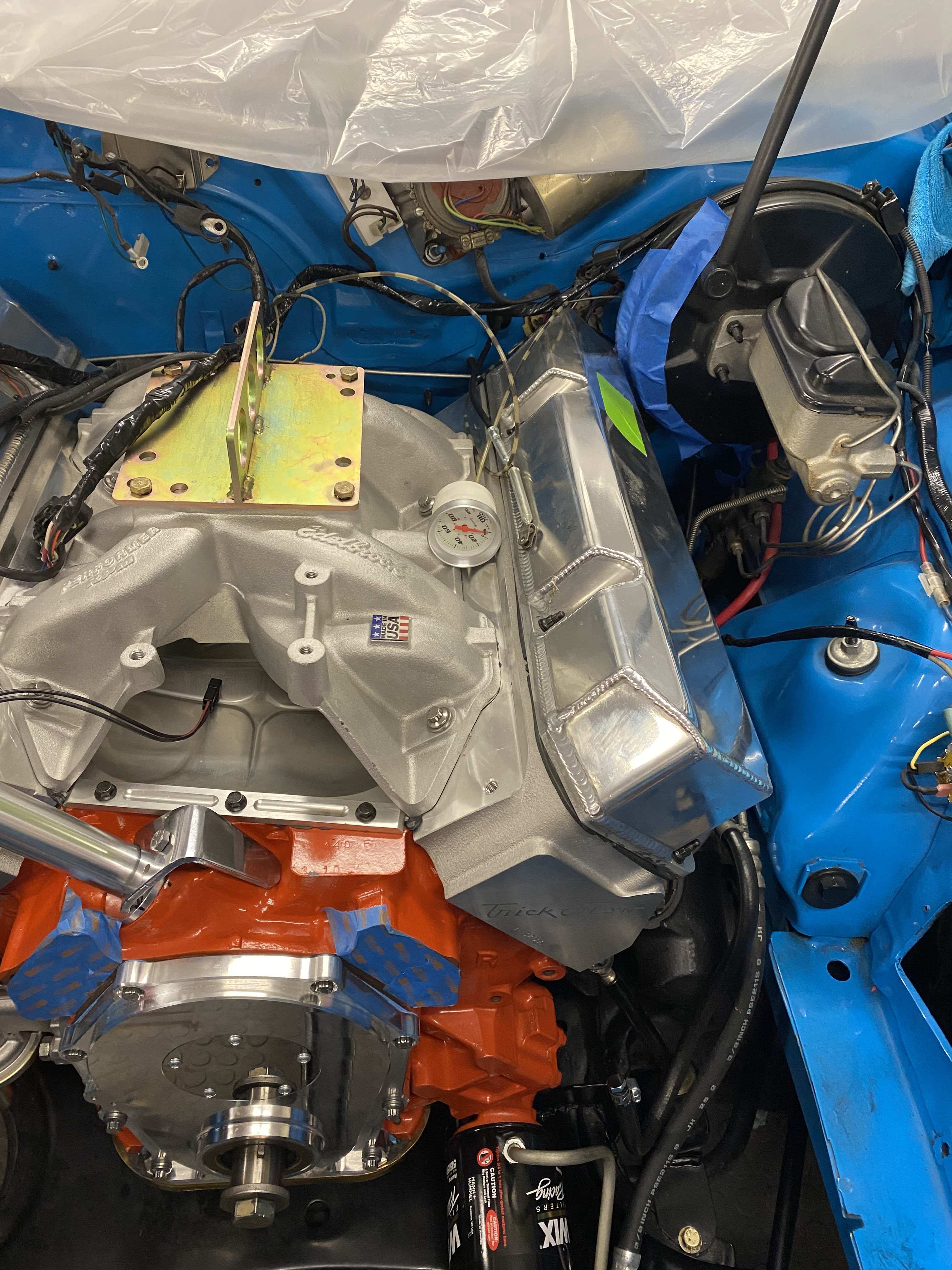

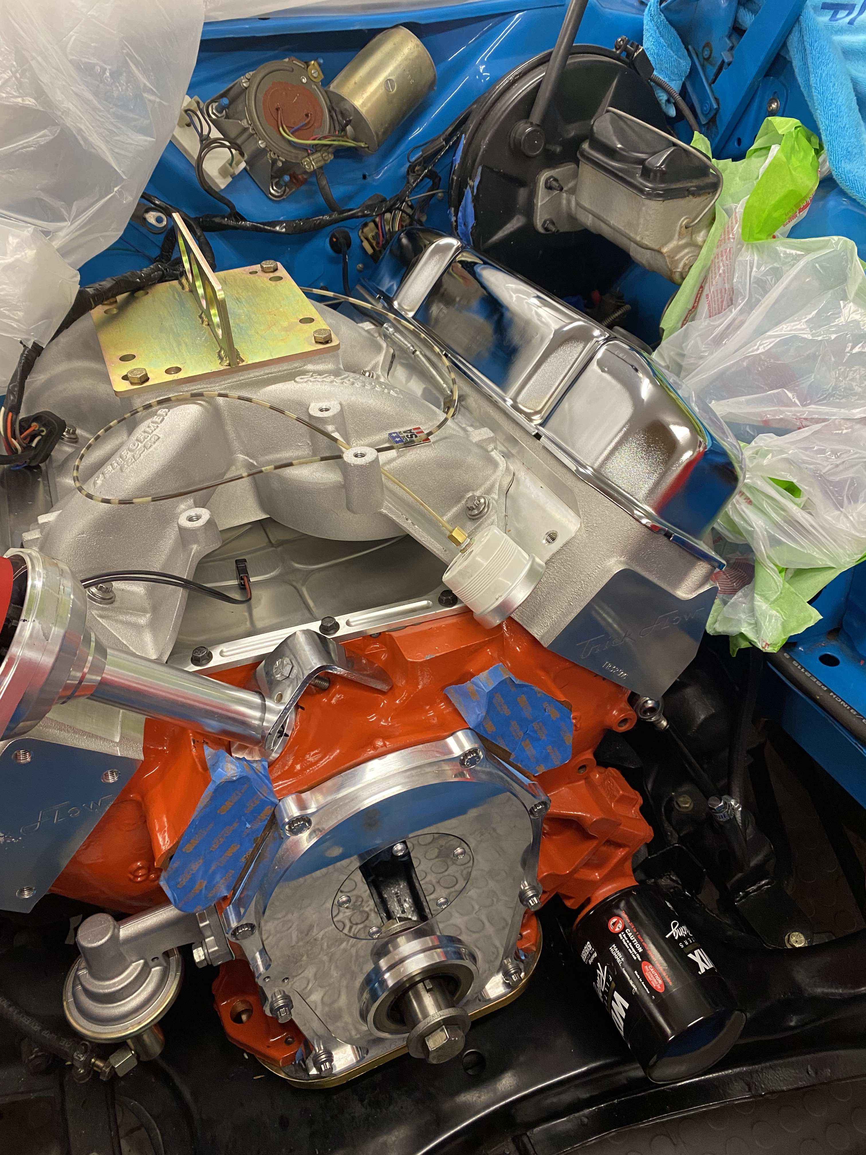

Finally got around to reinstall my solid roller bb stroker with Trickflow 240 heads. I’m using fabricated aluminum valve covers (3.5”) and now the v/c is touching the brake booster.
It was close with Edelbrock RPM’s but, no problem removing the v/c.
Was hoping someone had run into this before. I don’t want to run the factory on this set but….
Do you guys know if the factory v/c will clear Hughes roller rocker’s?
Currently has Wilwood front disc brakes, I could do away with p/b’s but really like how they work on my set up.
Appreciate any info you can share,

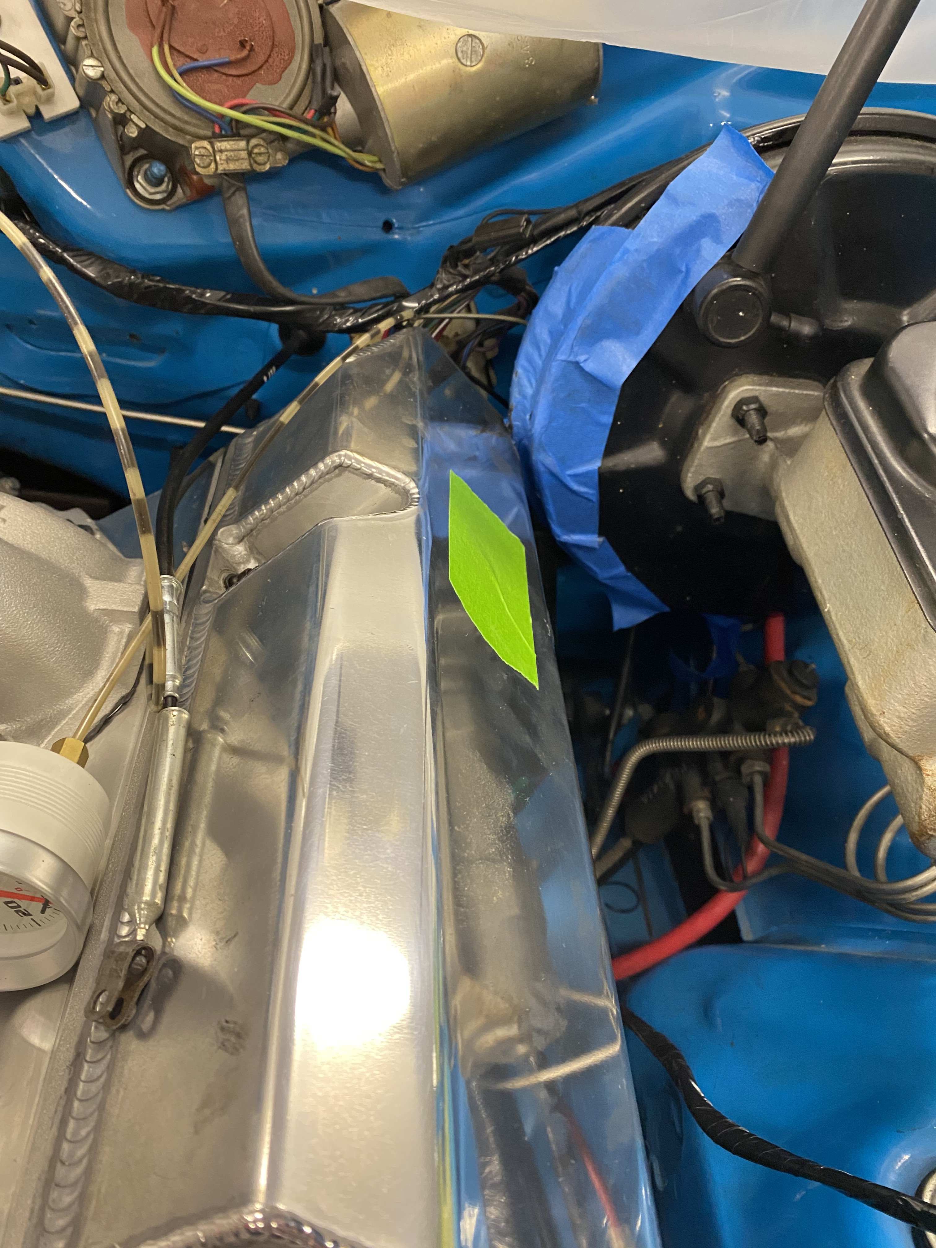

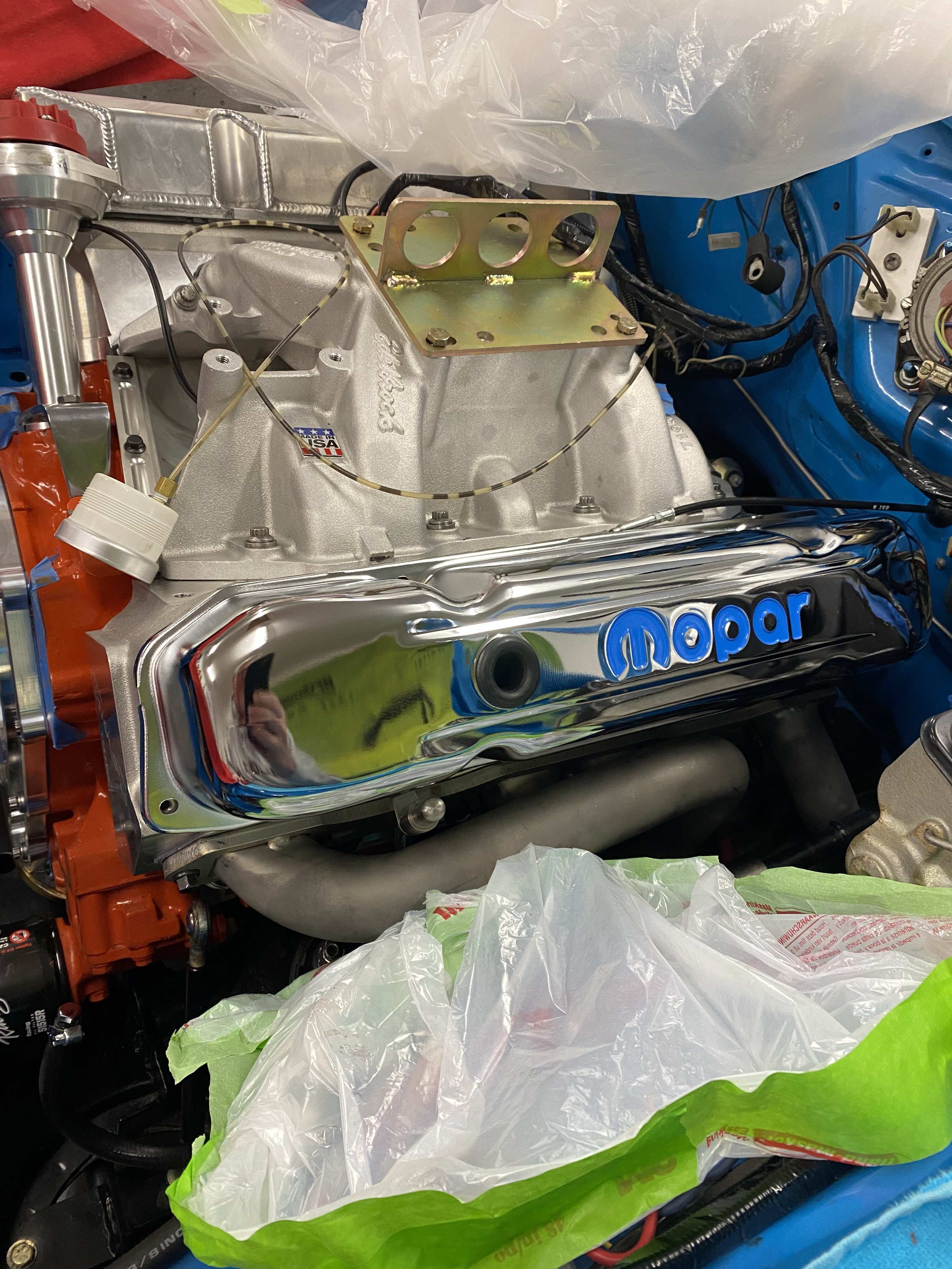

just sharing some info. I think this MP valve cover will work. It’s tight on the ends where the stand is but, gently pushed it down without a gasket. Rolled the motor a couple of times and nothing is touching.

Yea, that’s my biggest concern. I have rubber Felpro and cork. The cork fit fine on the cover but, I’ll have to do some light trimming in two corners on the rubber gaskets.

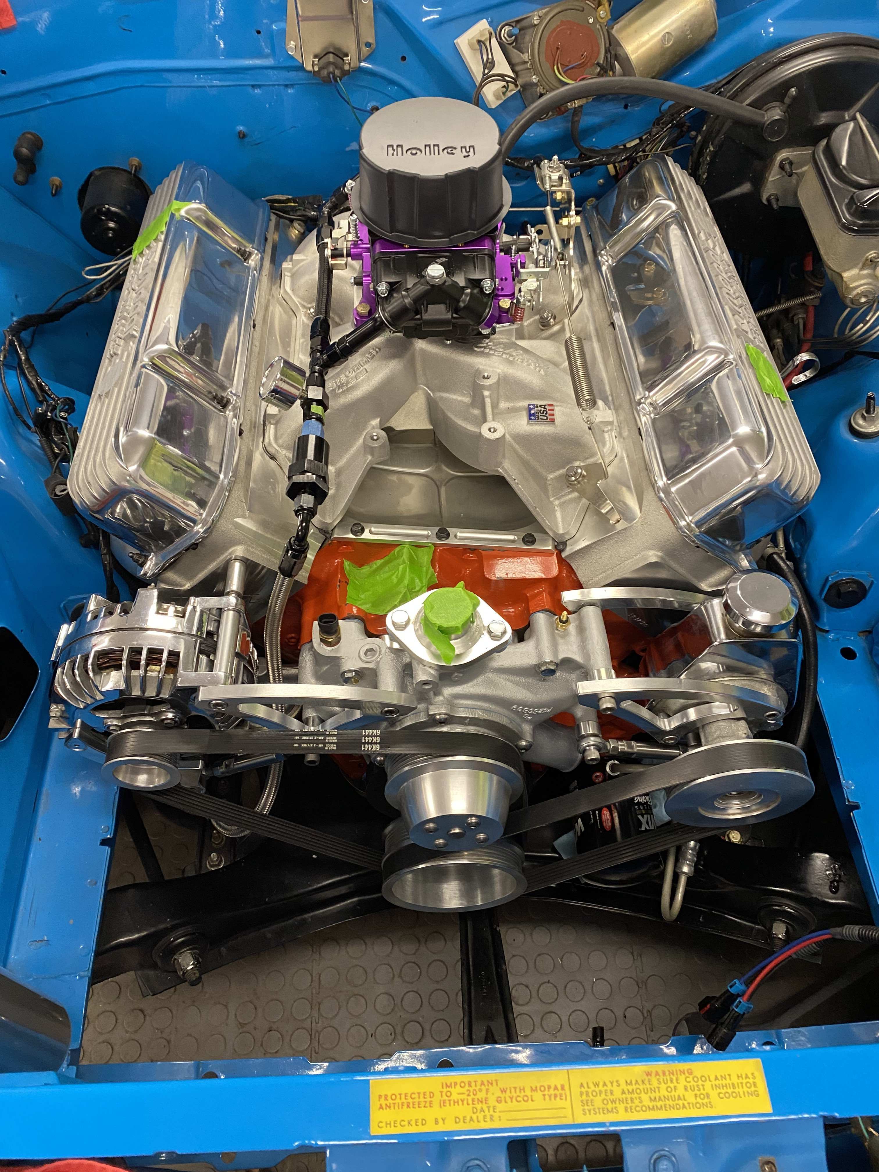

I finally got these MP valve covers in. So, the left is very close to the booster but, I have clearance.
The stamped steel look good to me as well. Just getting gaskets to fit right was an issue. I don’t like using sealer on these.
These Trickflow heads are larger than eddy’s for sure, should be fine though. Headers and exhaust hooked up, no problem.
Very nice :thumbsup:
