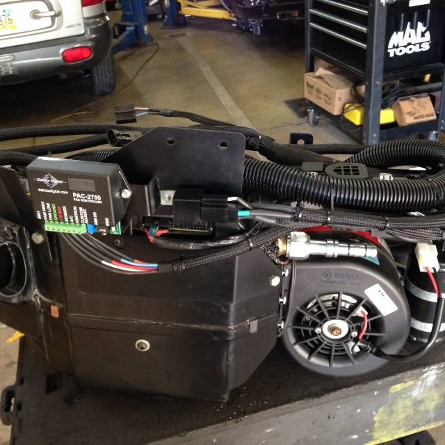

Has anyone used a vintage air kit on a 74 challenger to completley replace the factory air package ? and if you have was every thing there that you needed
I would say no, but it is easier to have the dash out. The time to take the dash out verses the extra time you spend with the dash in probably equals out. Your back pain from being upside down under the dash, makes the dash worth pulling IMO.I'm looking into the vintage air and classic auto air too. does the dash need to be removed to install one of these kits?

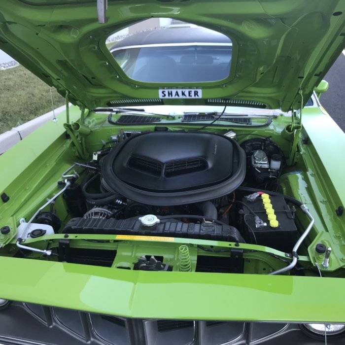

On my 71 Cuda I updated everything under the hood from classic air using the Sanden compressor because I have a shaker hood so the standard compressor won’t fit. Left all the original parts under the dash and it works just fine.
