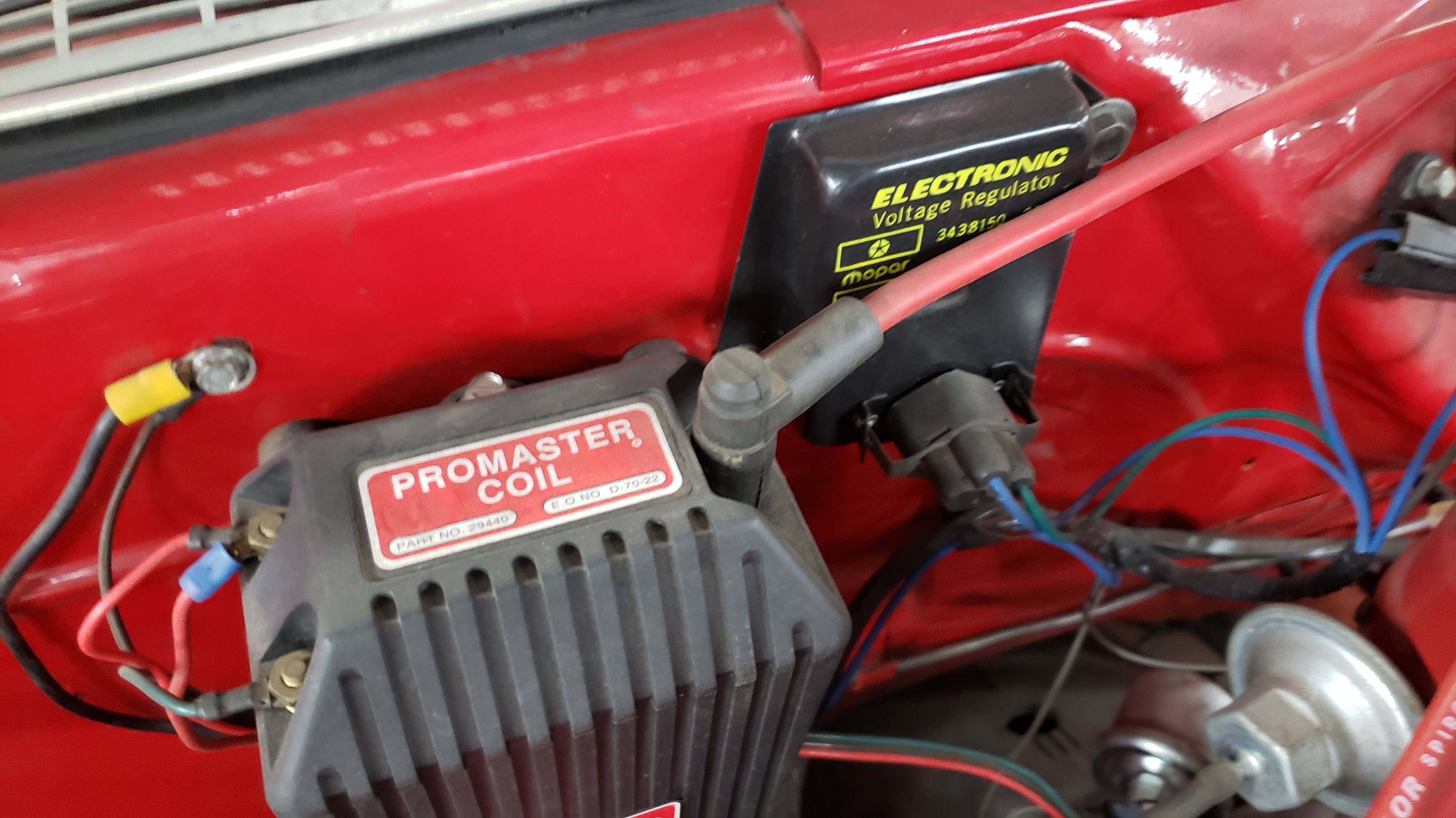

Yes, electronic ignition began in 71 or 72. In a factory set up the white tach wire goes to the negative side of the coil. Being that the Promaster is still just a coil I bet it would work. You could test it with a cheap tach, or multimeter (one that has 4,6,8 cyl settings) before hooking up the factory tach.
