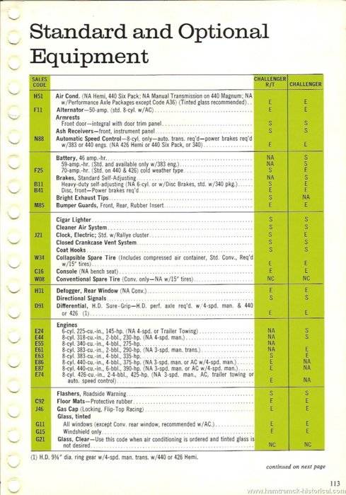

Here’s what I’ve noticed in my years of observation, either all the glass is tinted or just the windshield and that all the glass is always tinted on ac cars.
Tinted glass was recommended but not required with a/c. My 70 RT has clear glass and a/c.
See first and last sections of the chart.
